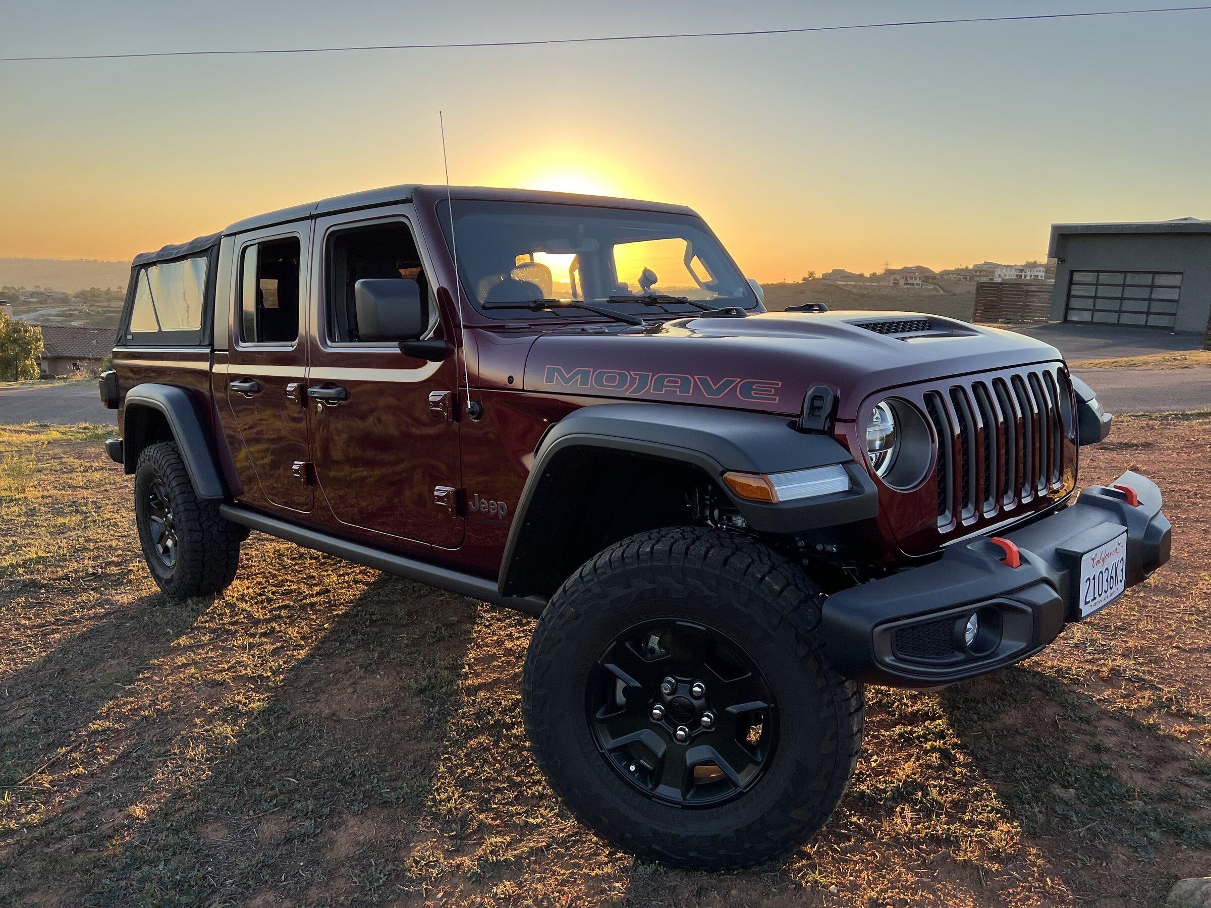

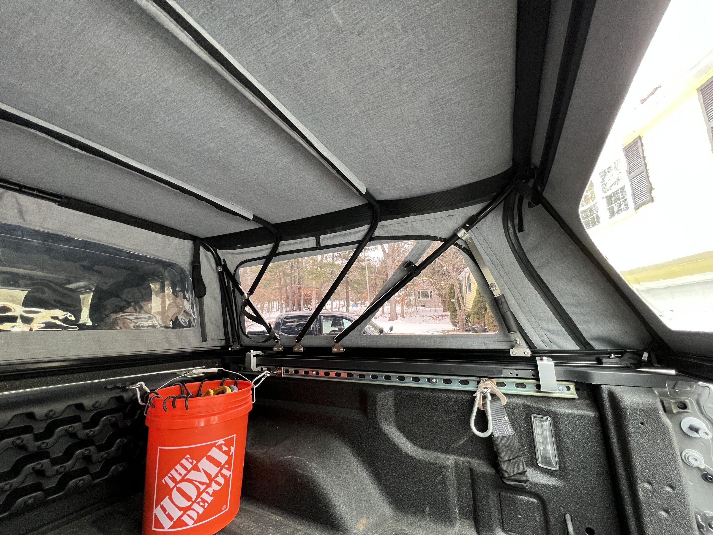

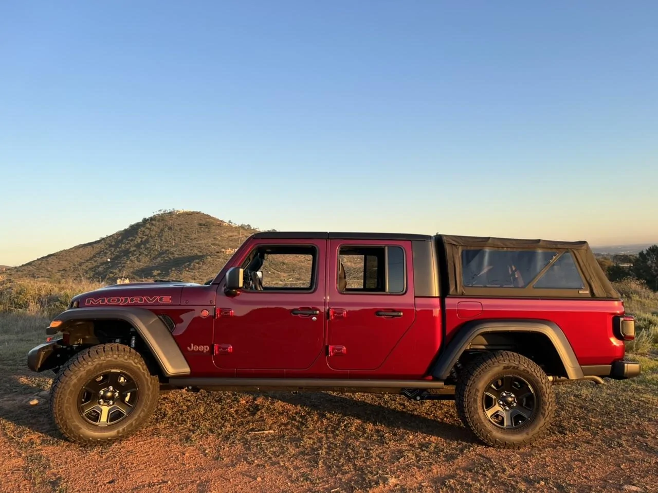

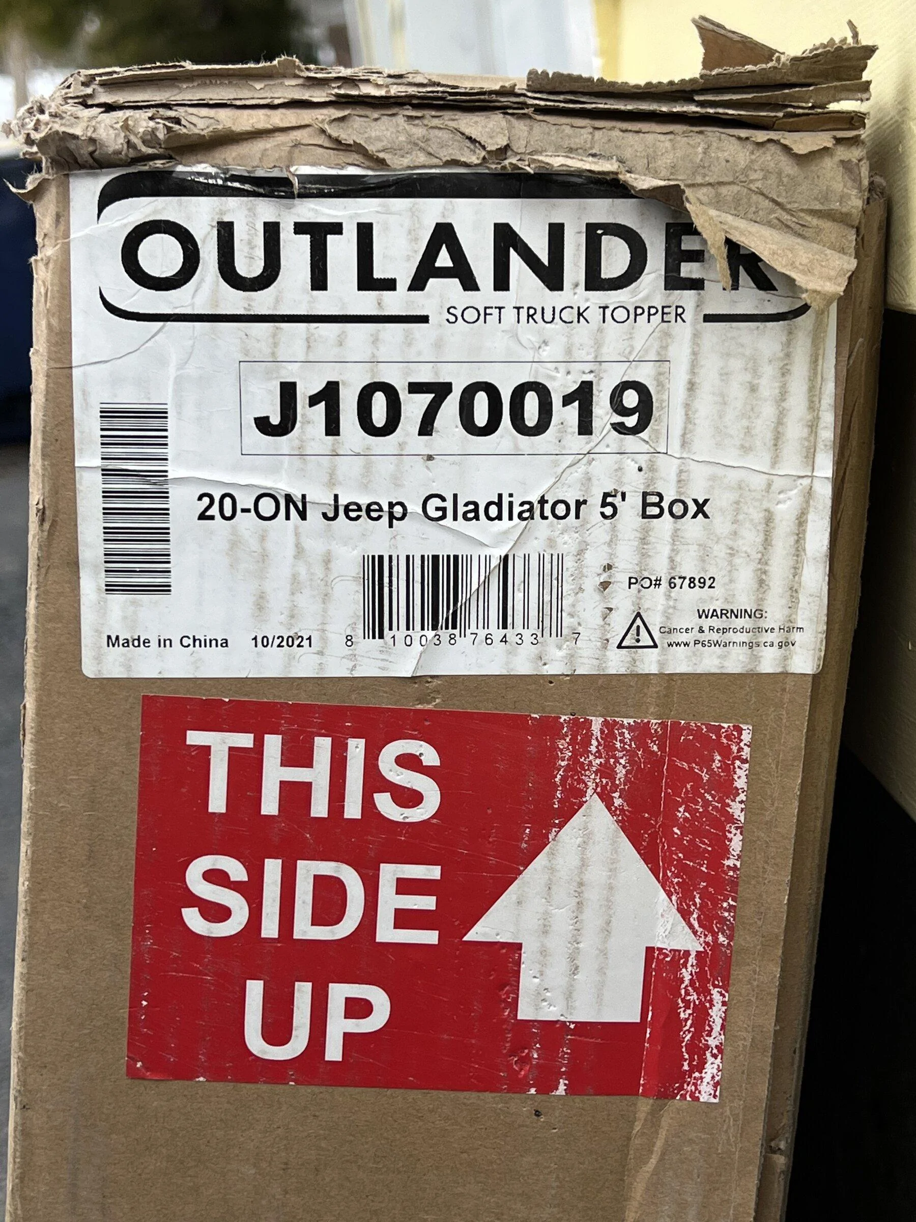

ok! got my agri-cover outlander top on today and so far i’m stoked. some initial feedback below:
  • one of the bolts that holds the bows to the frame was cross threaded so i had to cut it out and swap it, no biggie.
  • zippering the rear window was driving me nuts, couldn’t get the last zipper to connect for like 20 minutes. finally i removed the cross bar from the rest of the frame giving me some flexibility and that did the trick.
  • the side windows are tinted, front and rear are clear, visibility was pretty solid through the rvm.
  • the zippers have pulls on both sides which is nice as i plan to sleep in it here and there.
  • overall the quality is definitely there, i’d say for the price it’s worth it.
  • i’ll give it a car wash test next time i go get her dirty, but it seems watertight for sure.
  • took me about 2 hours to get it installed.

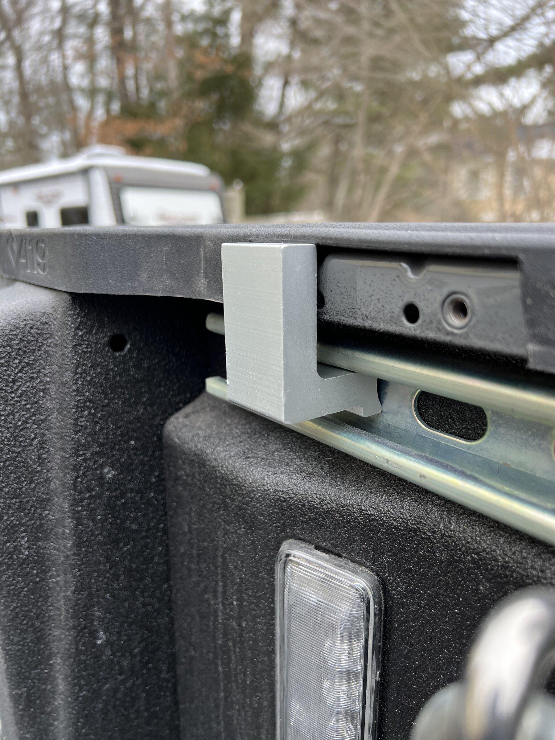

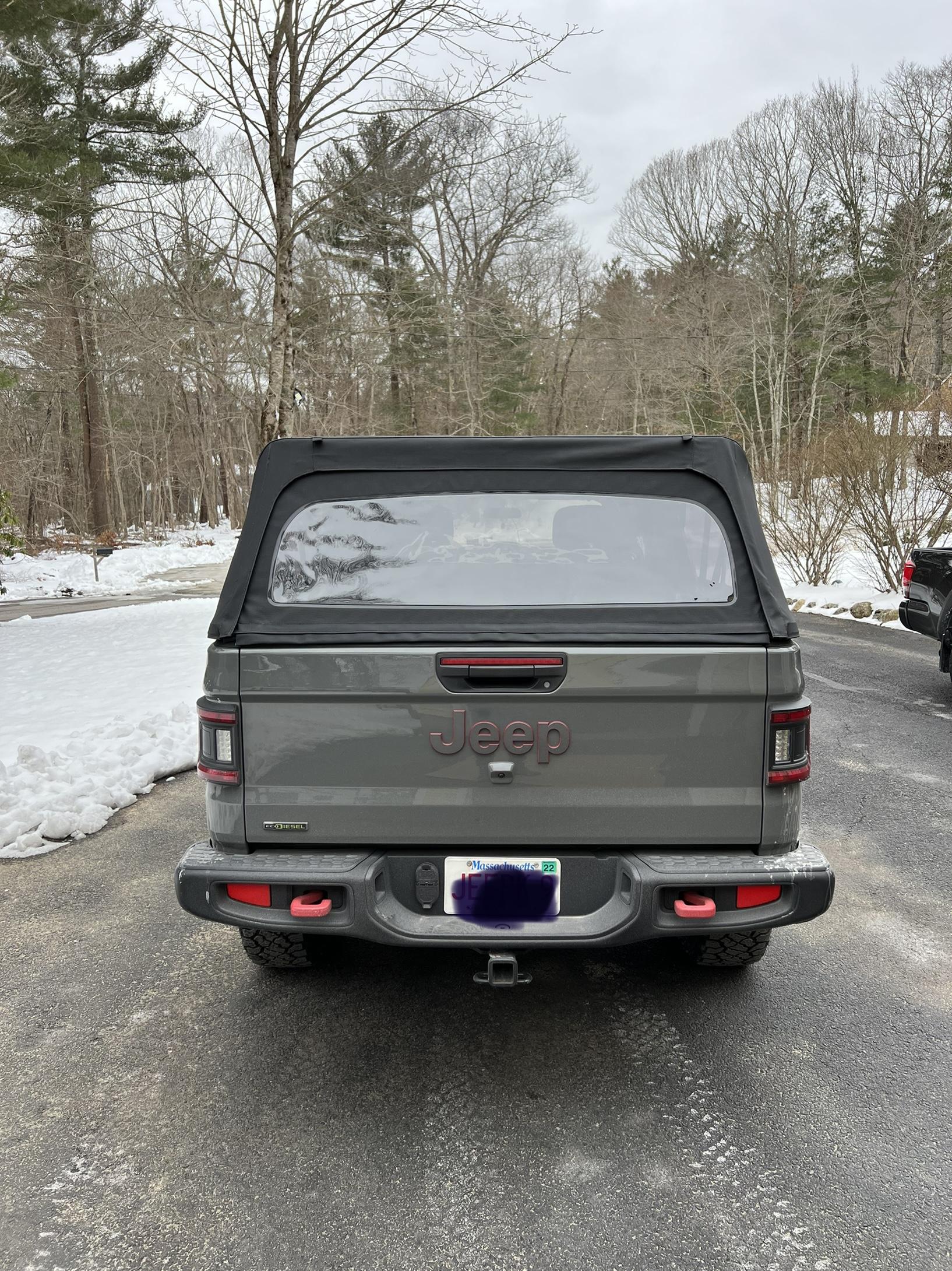

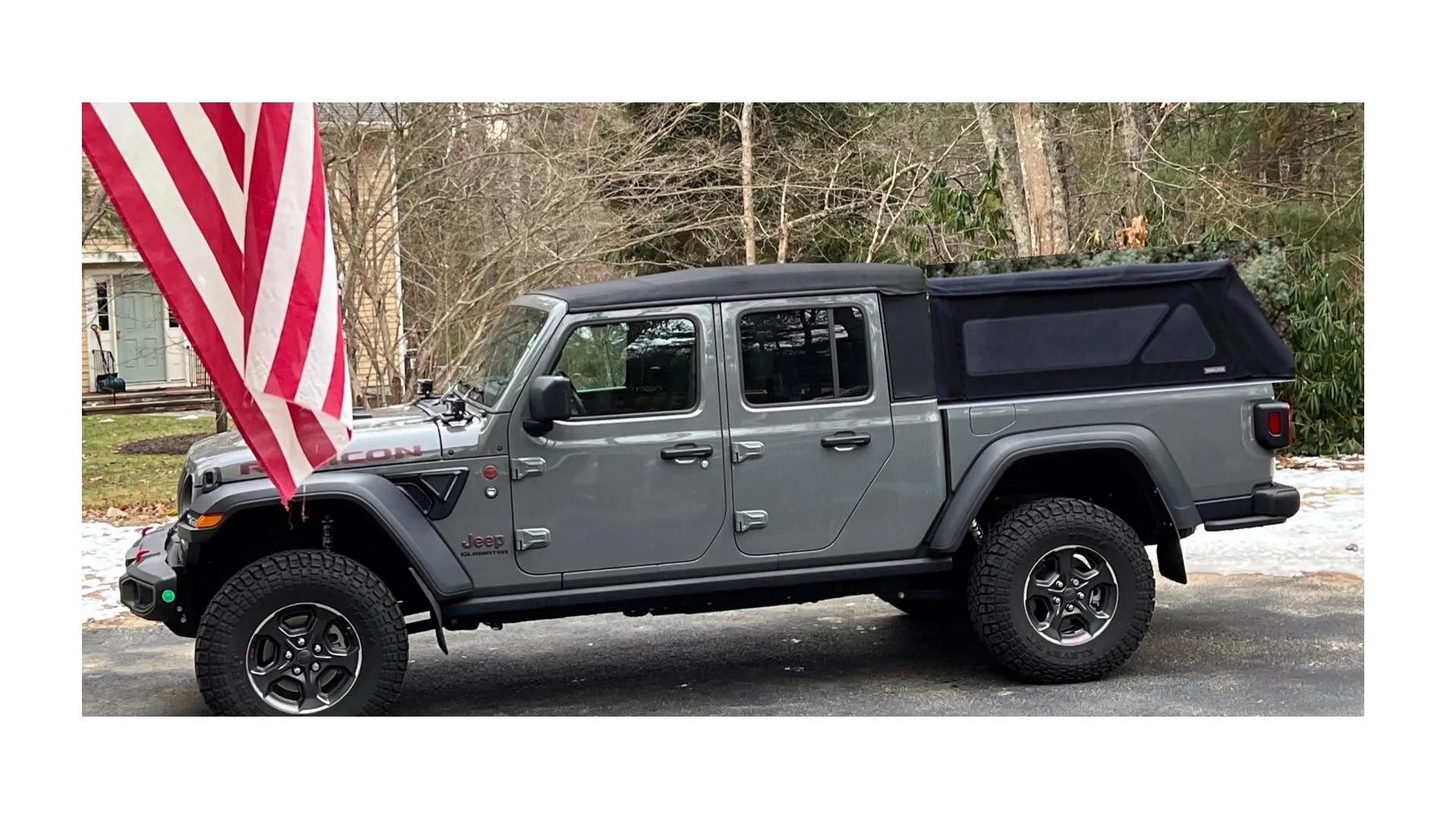

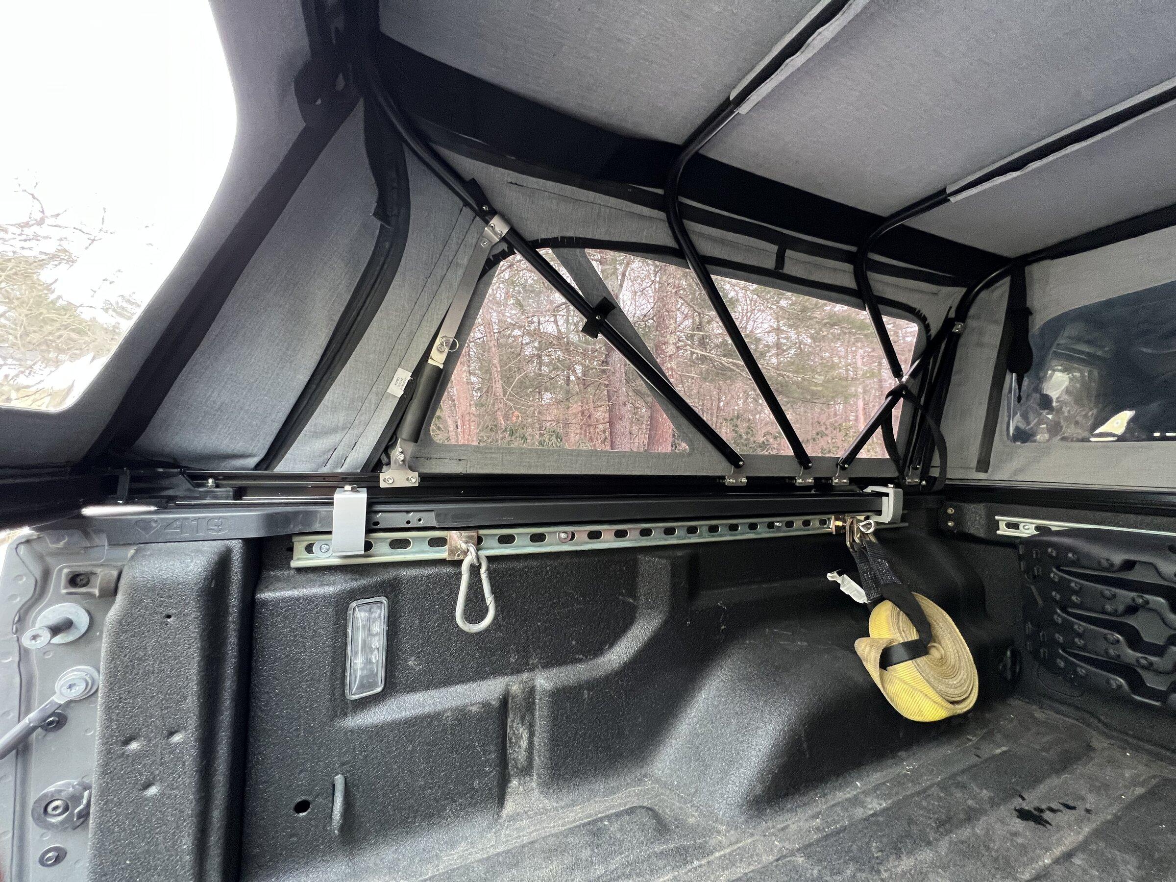

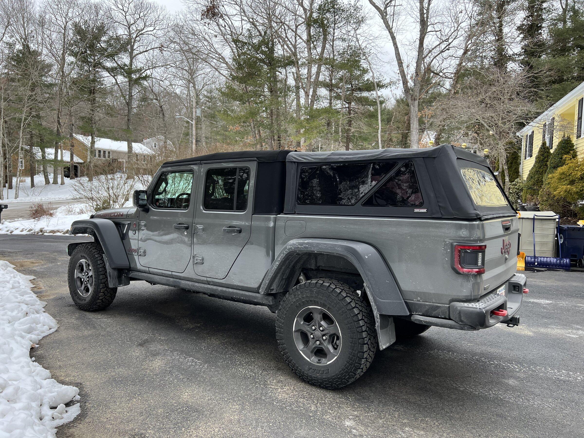

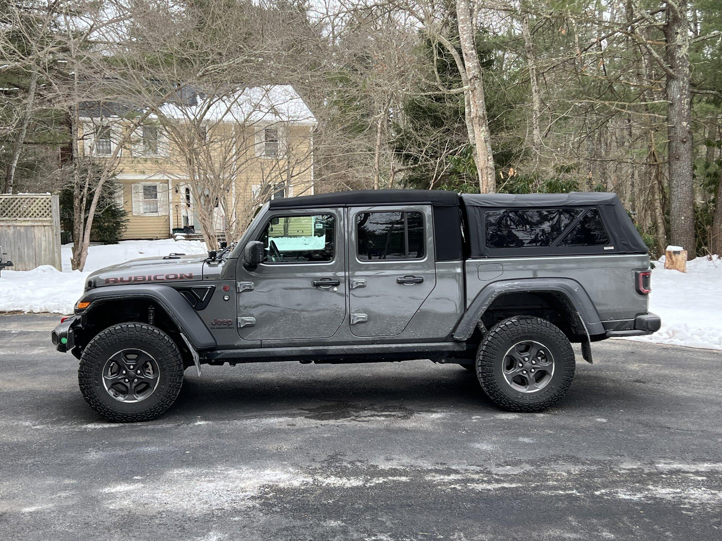

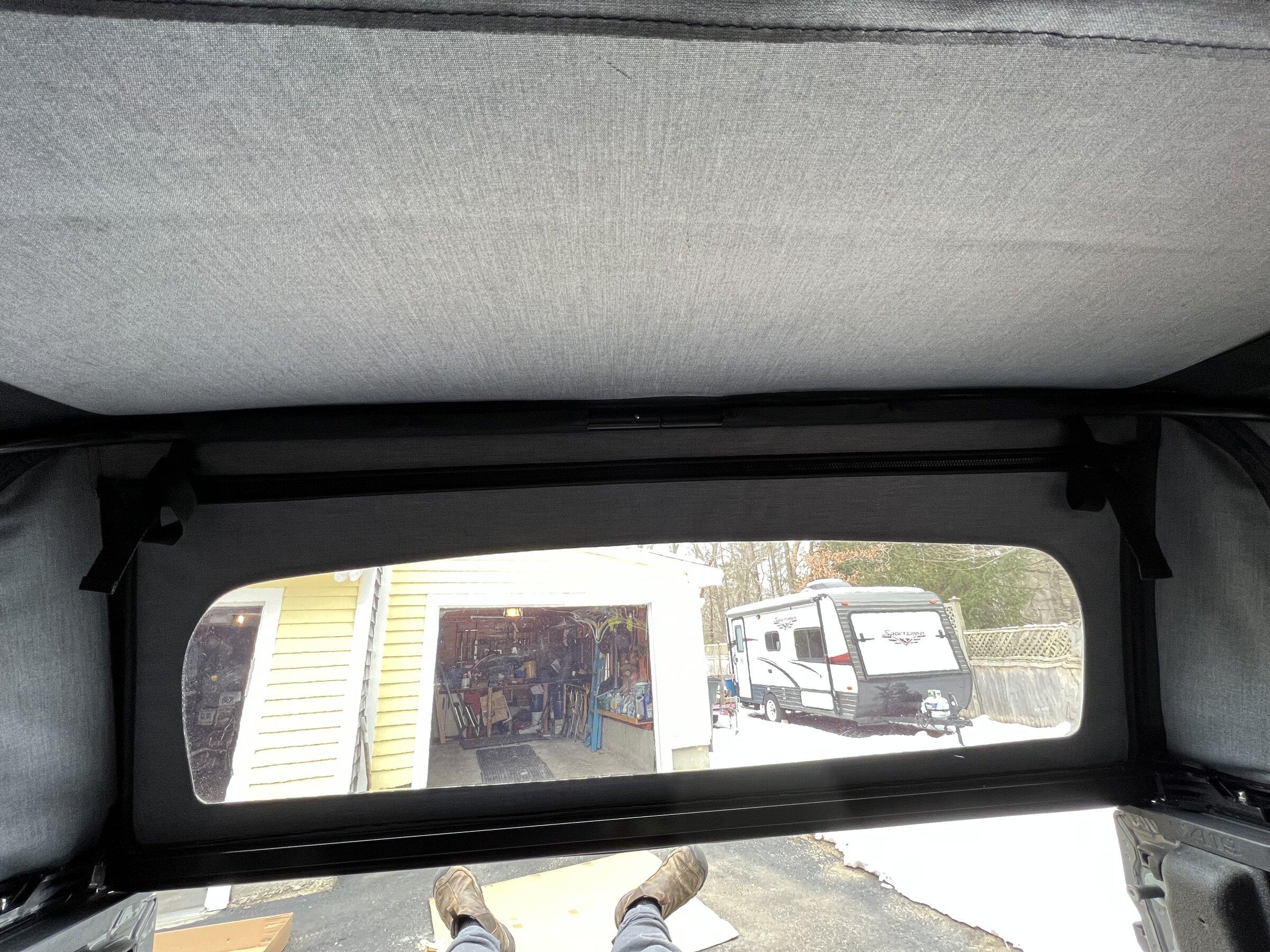

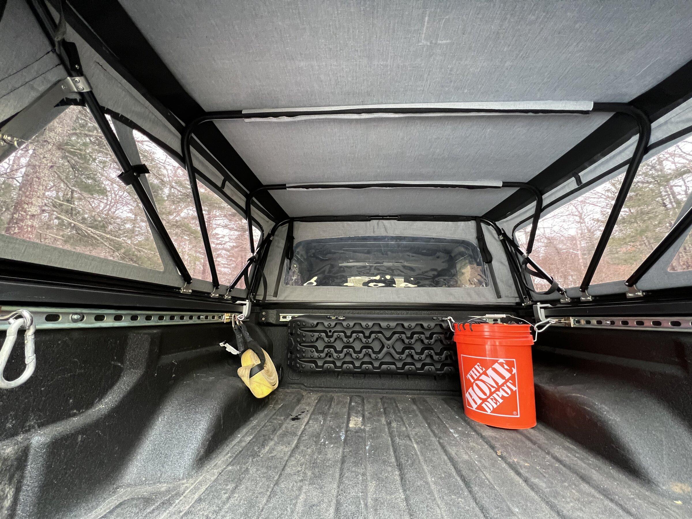

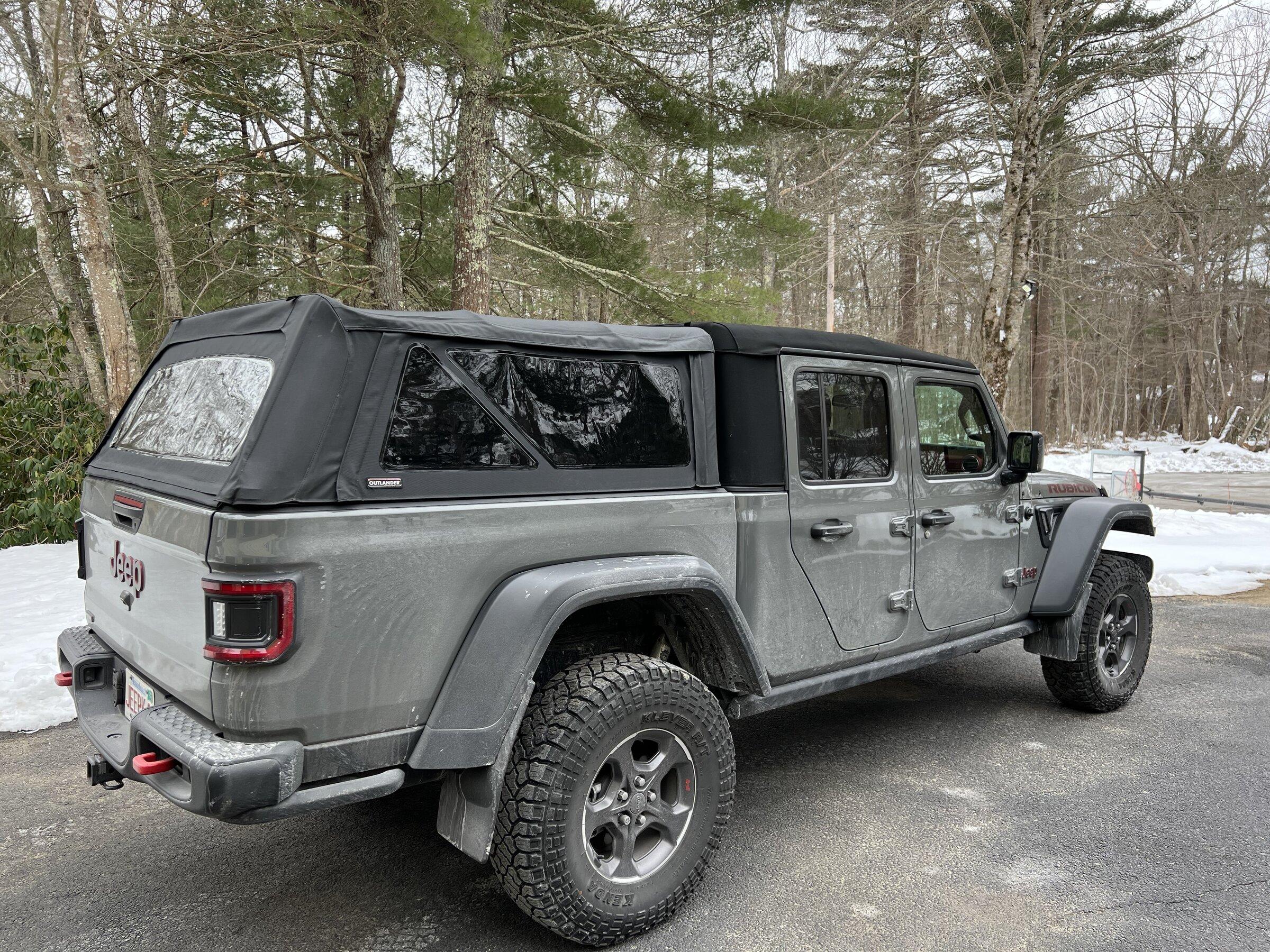

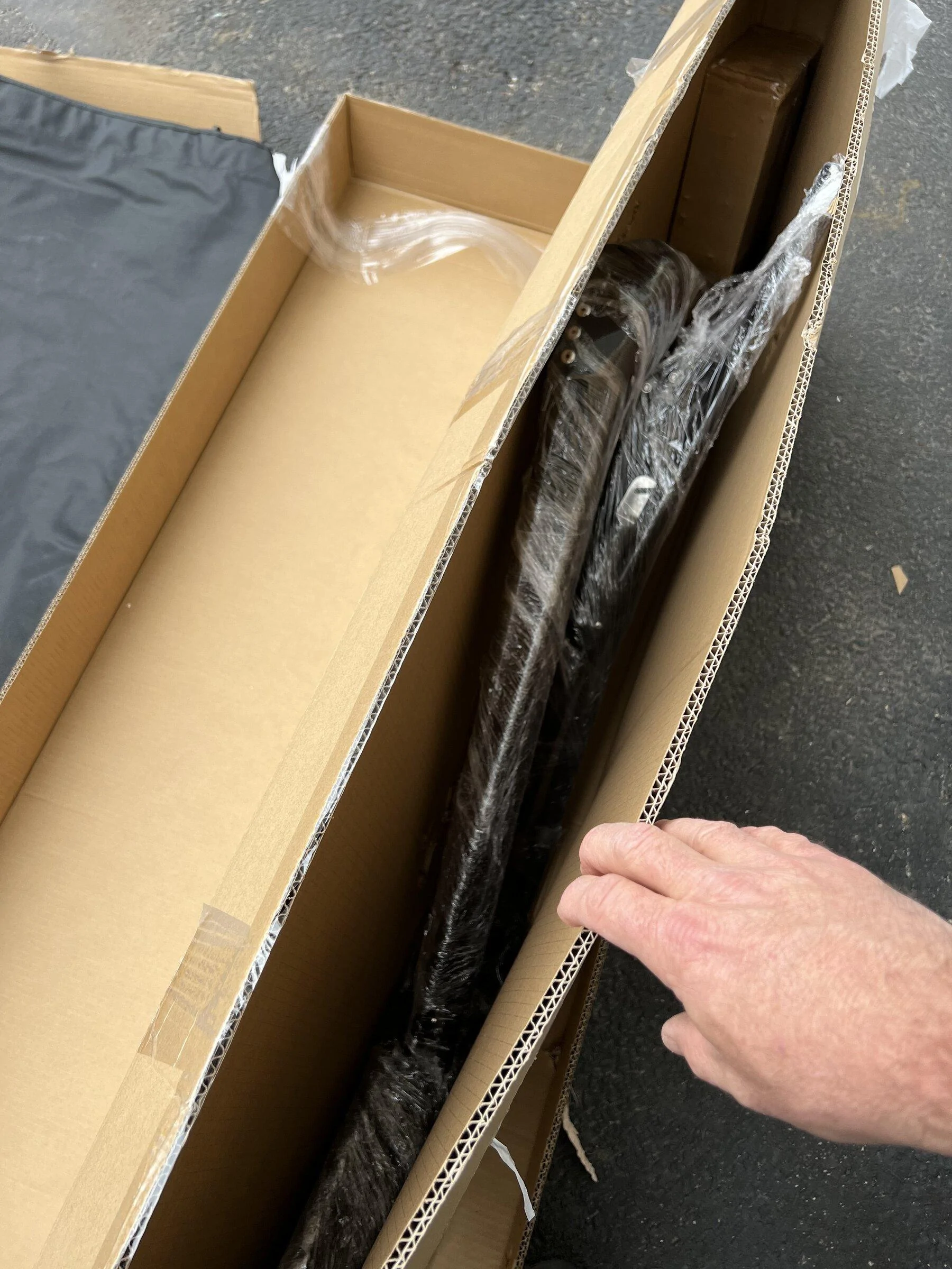

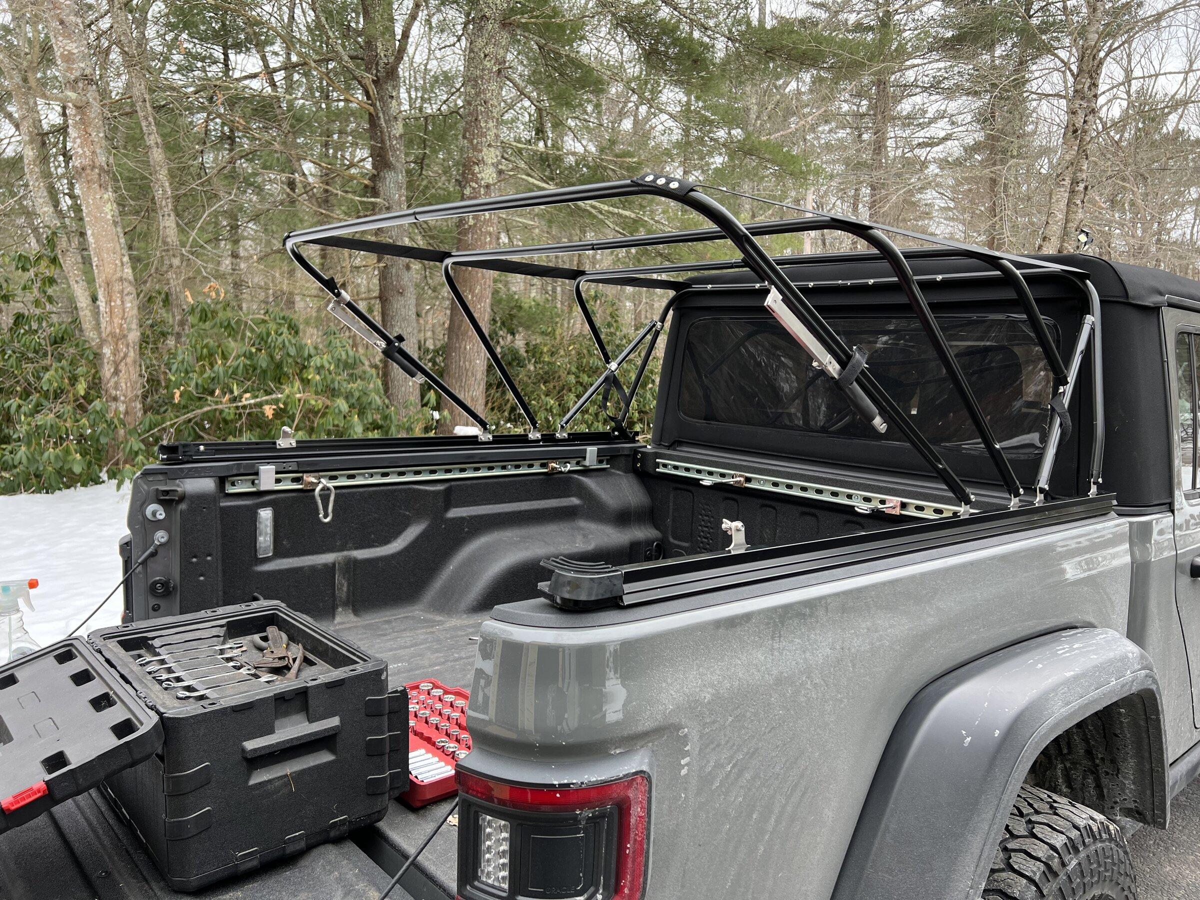

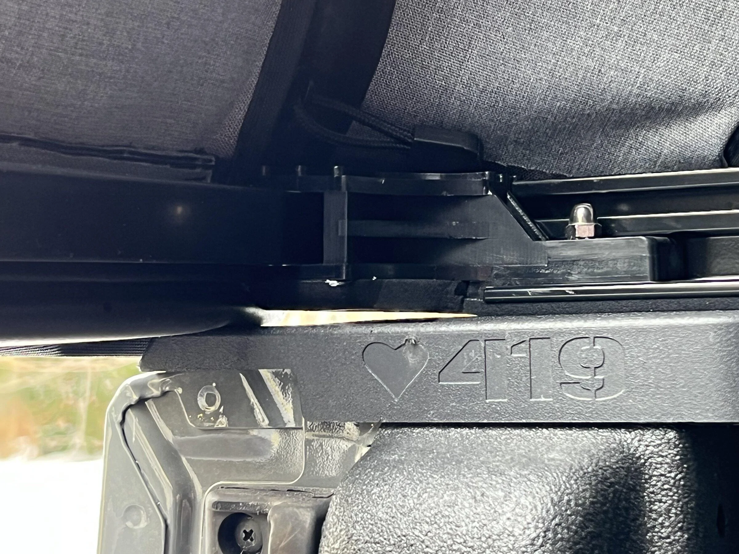

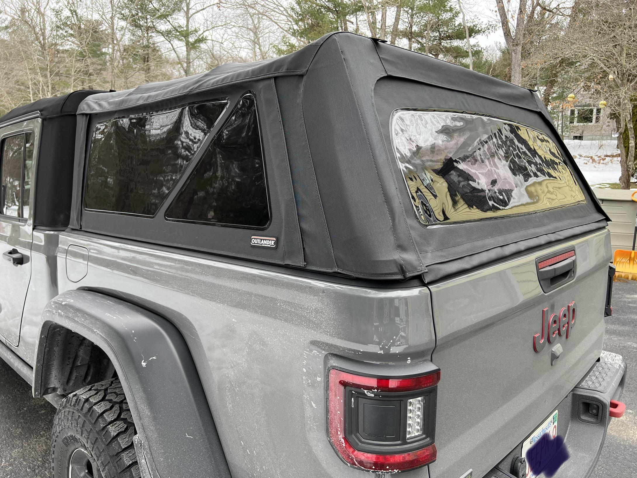

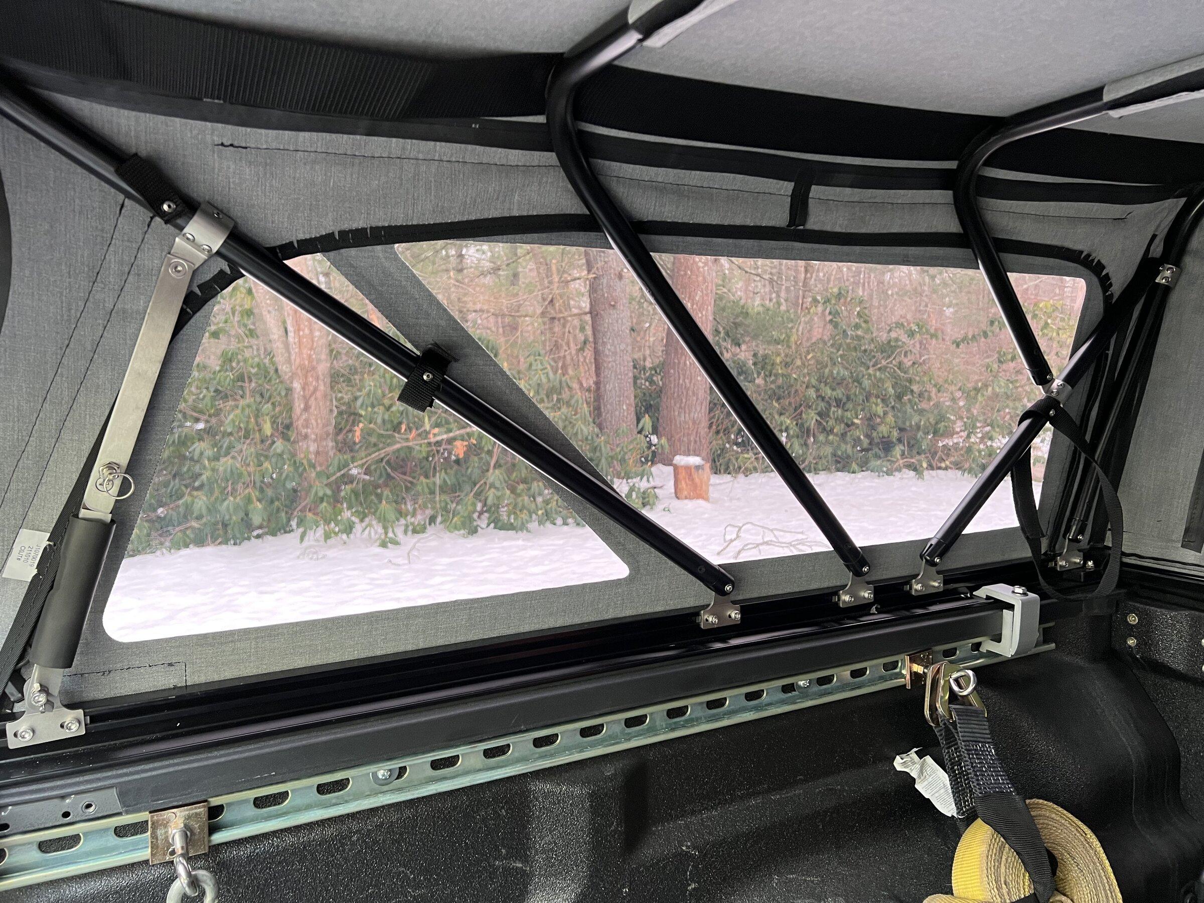

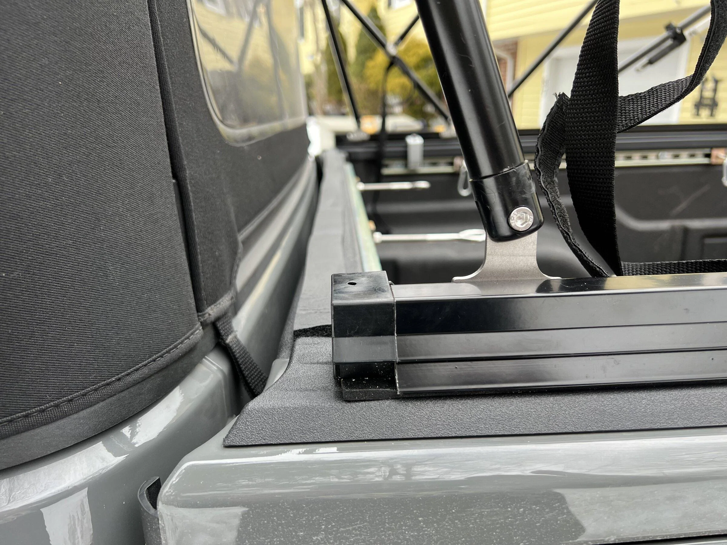

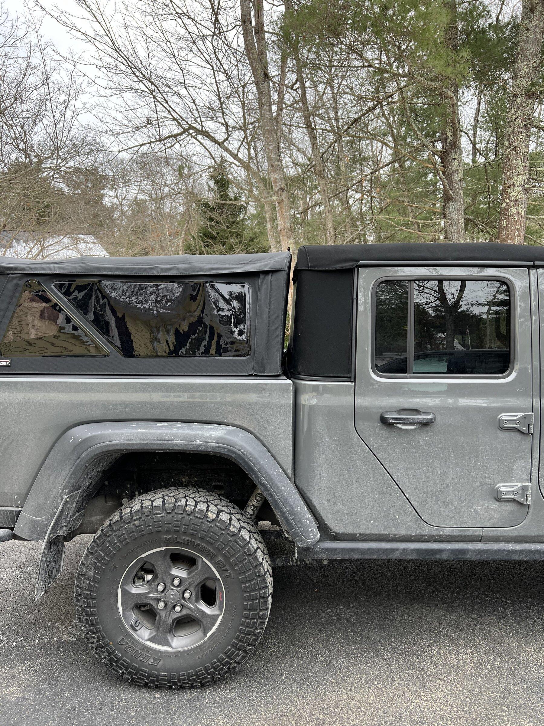

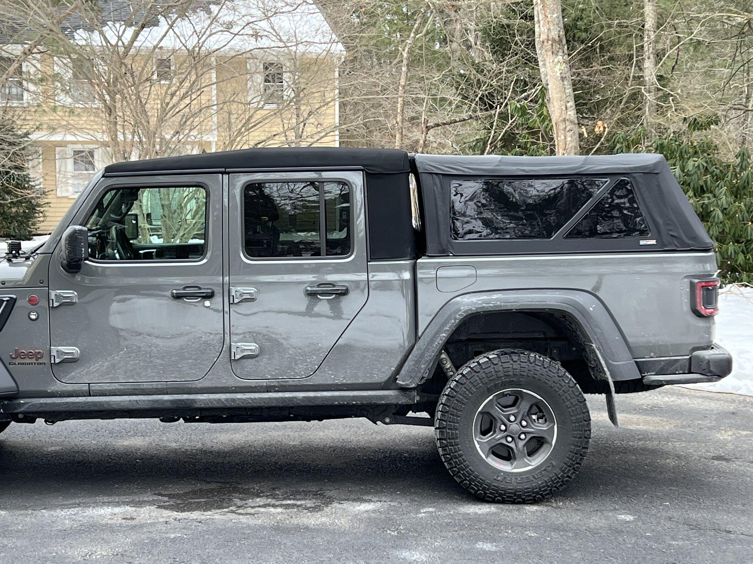

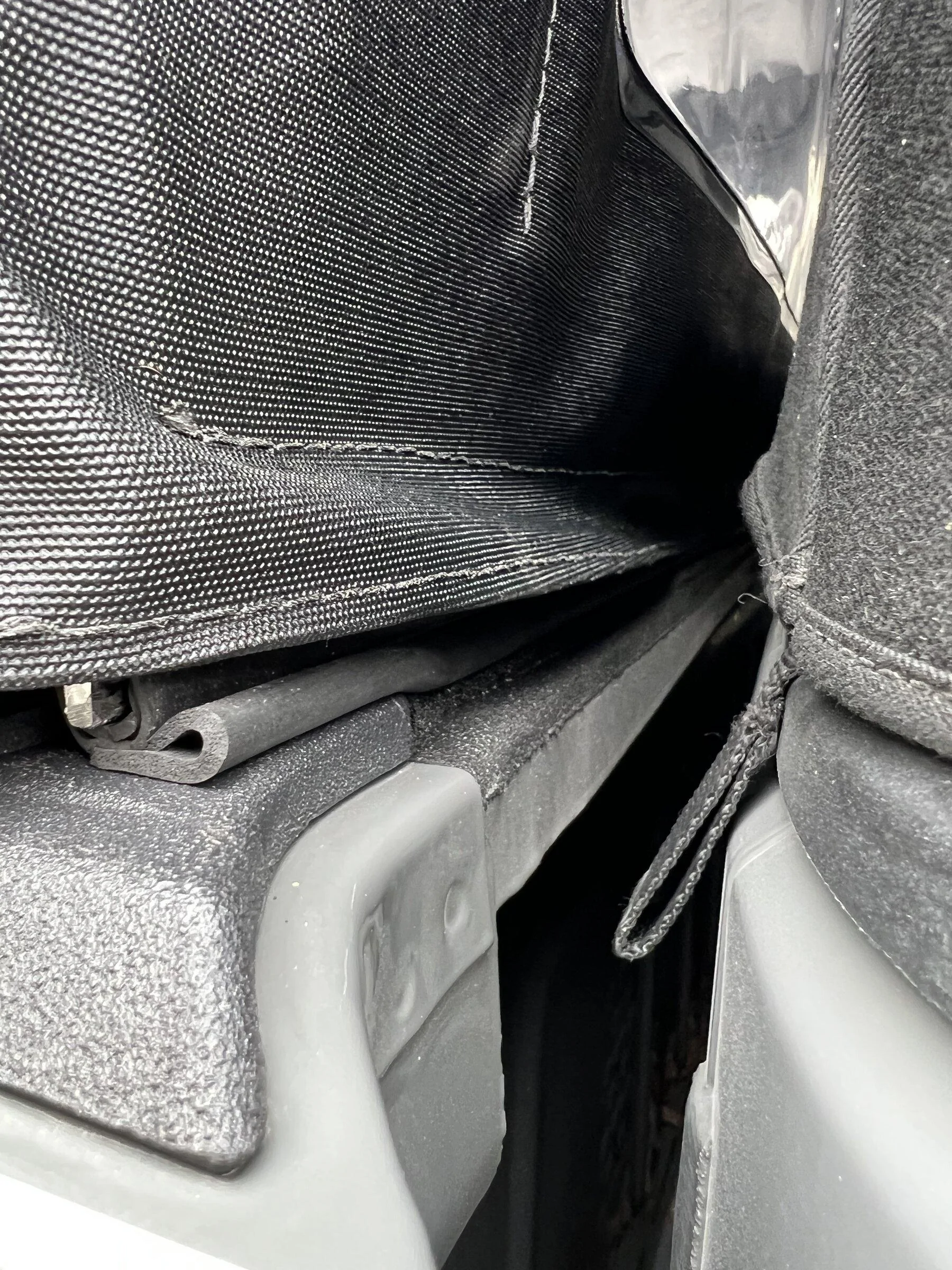

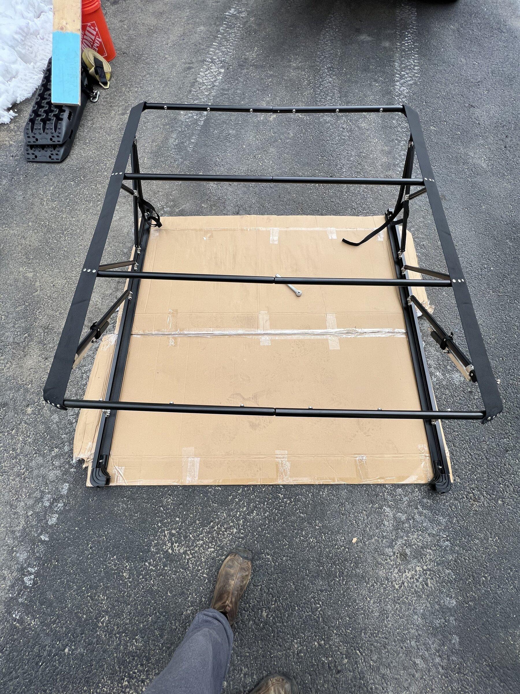

Done in 40 degree weather. Having experience with my JKU softop zippers in cold weather prepared me for this. The softop are not an exact match but the outlander morphs with the sting gray a bit. I likey.

Thank you for the pictures. Mine just arrived. I will install it tomorrow. Its very nice to actually buy something in stock and receive it very quickly. It looks like your fwd seal needs trimming to lay down or nest properly. Unfortunately the black is more on the gray side and doesn't match your soft top.
My truck is all red so it wont be an issue. You may already have it but this is the video on the installation.
It shows the seal installation.

Is this just 4 clamps and the whole thing comes off?

The gap is in the rear corners-easy fix w weatherstripping

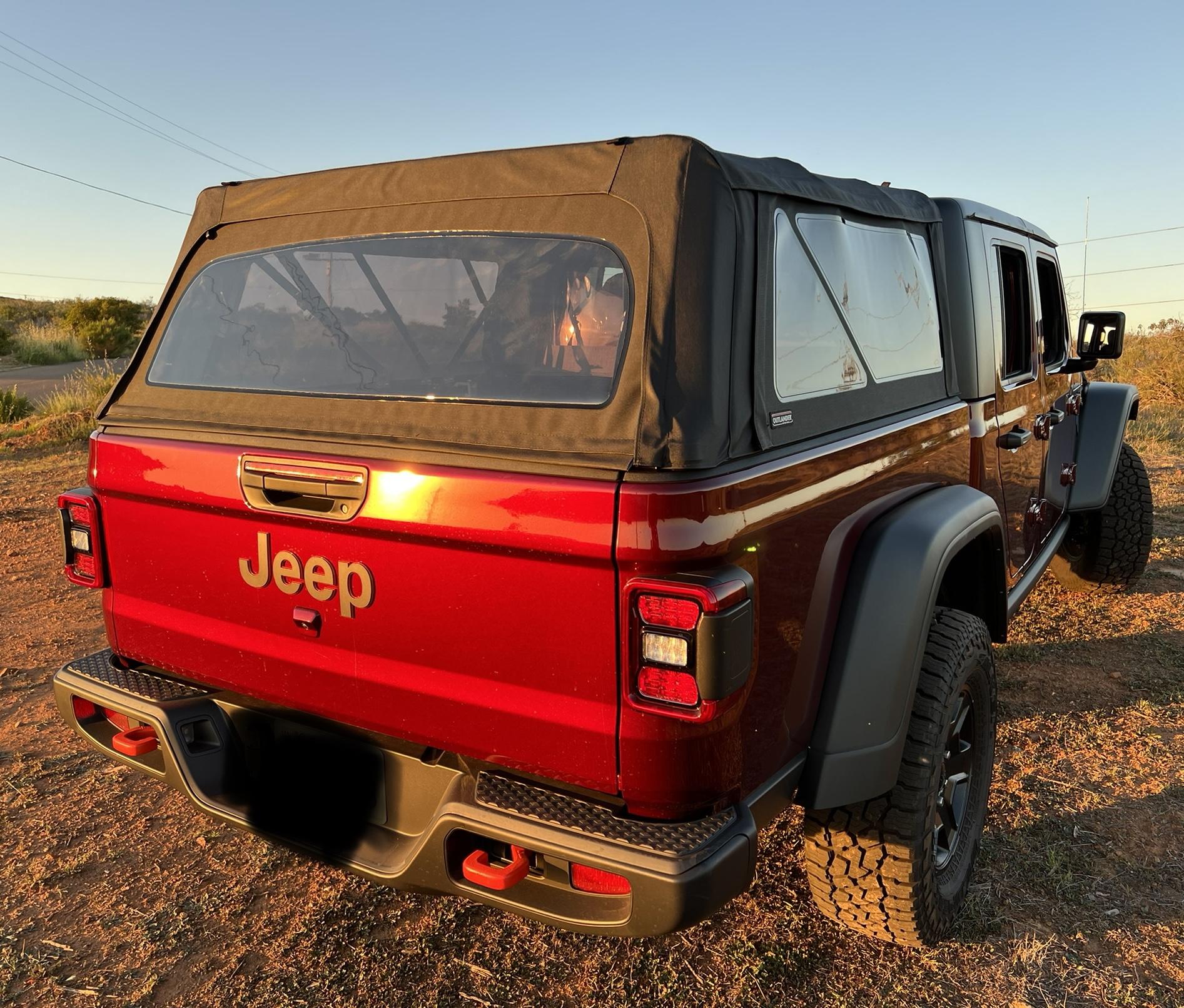

My turn to post. My wife and I installed it this afternoon.
Not too bad. The zippers are a little hard to get started in all the fabric folds and yes the rear window side zips are the most difficult. Not a surprise to all of us that have fiddled around with soft tops before. Over all Its a well made product. The rear window will flip up and stay over the top for easy access to the bed.
