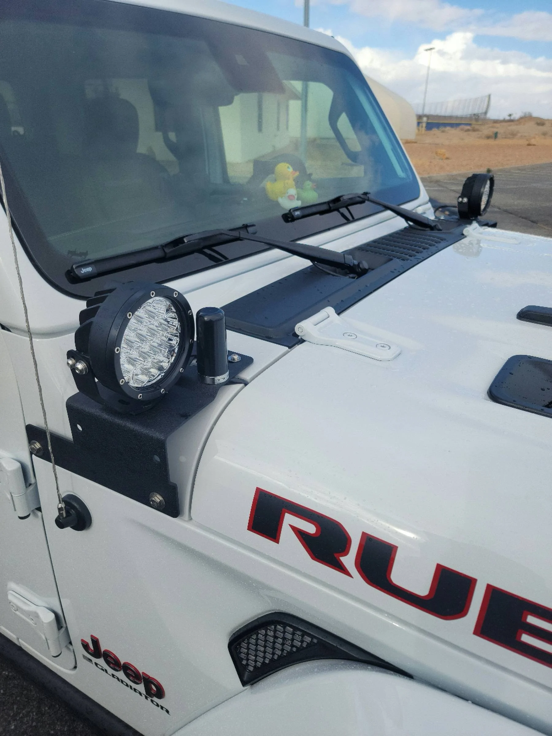

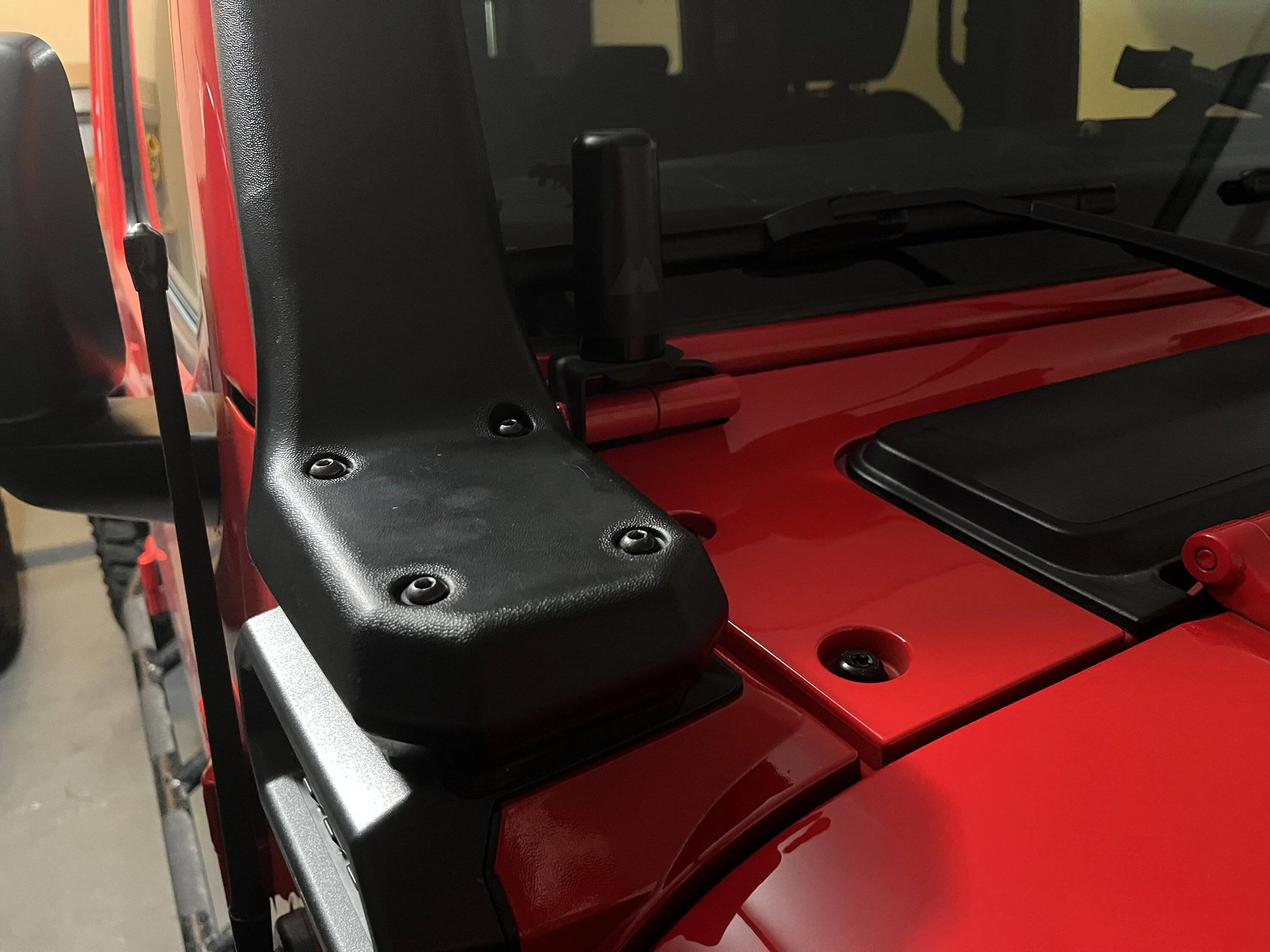

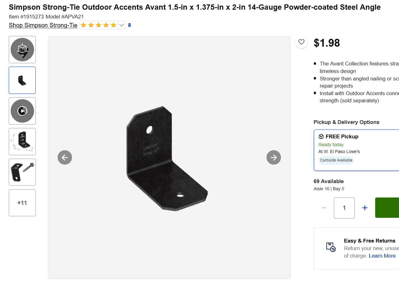

3 dollar tie down bracket from Lowes
Jeep Gladiator Cooltech cowl antenna mount 1672956488751
+ Step Drill bit + Spray on bedliner with a stealth 3db antenna is what I'm using, never notice it, wiper blade still clears for windshield cleaning.

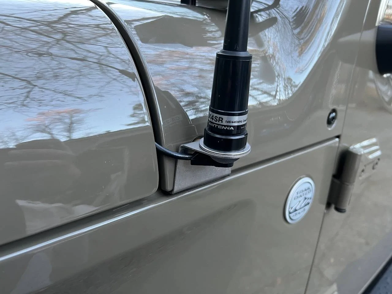

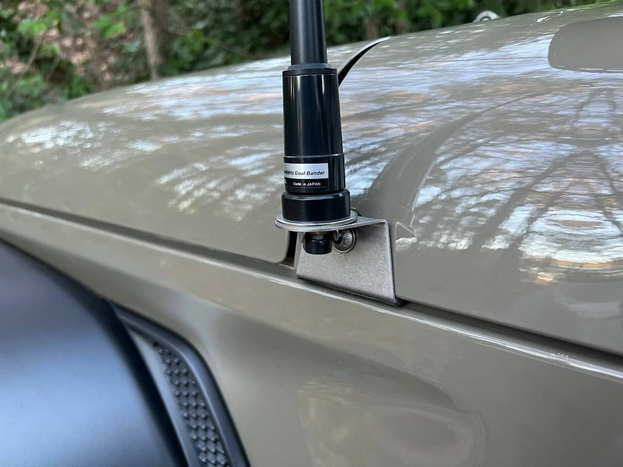

I've been using the Cooltech mount with a Comet CA-2X4SR for ~2 years and have zero complaints, it's worked well and has been through a few car washes when I forget it was there. I do a couple of nets each week from the Jeep and get out really well in the Atlanta metro area.
Jeep Gladiator Cooltech cowl antenna mount IMG_1344
That's clean!

That's clean!
Thanks, can't take credit for it though as I copied someone else on the forum, same bracket and everything.
One thing I would recommend is to just put it on the drivers side, while the wiper clears on mine, you have to bend the wiper out of the way, or you need to remove the antenna (which is easy to do, it's just hand threaded on).
I have it on the passenger just in case I want to run my whip style 6db antenna for more remote trips, keeps all my antennae on one side for a more organized look.

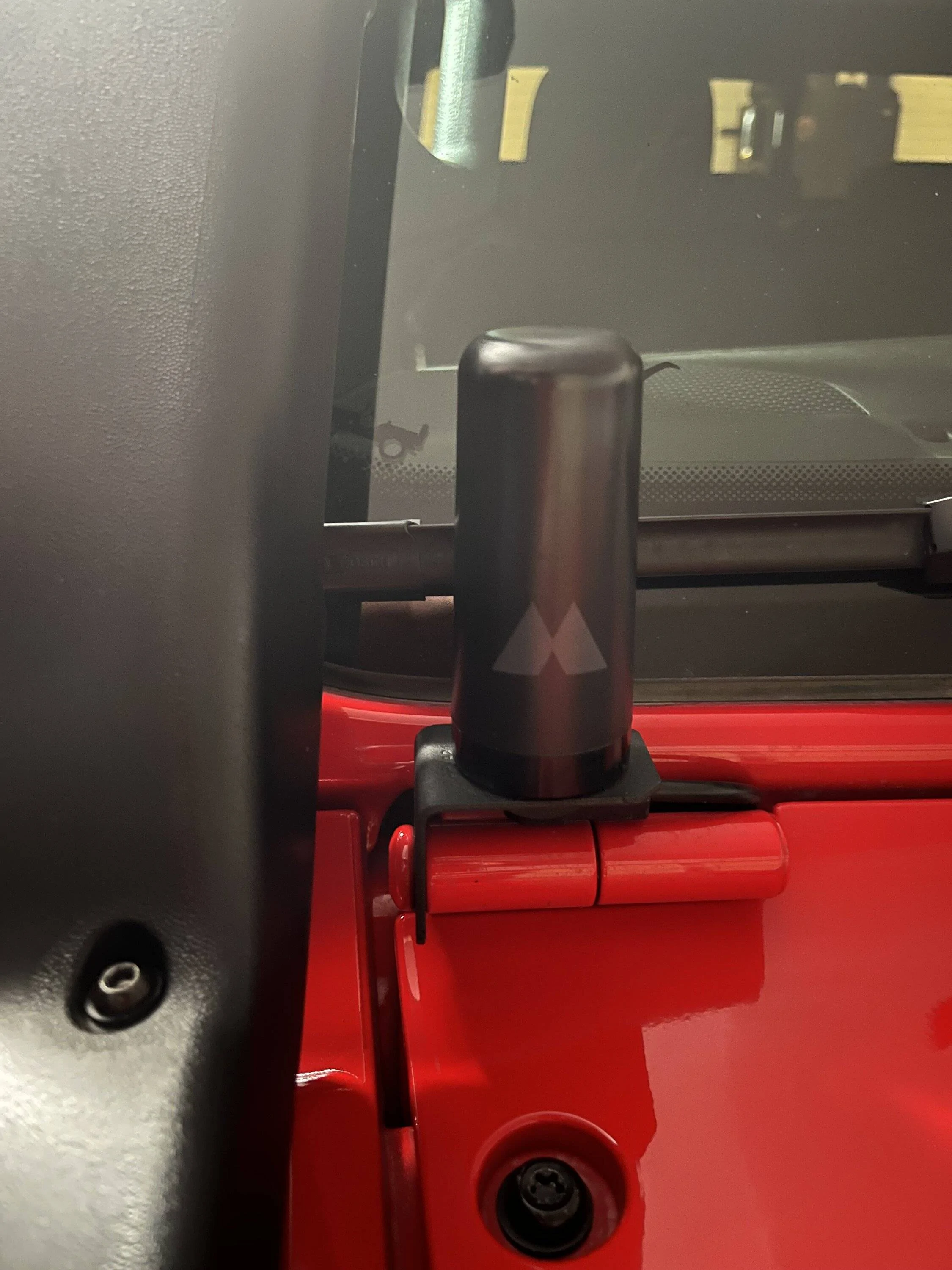

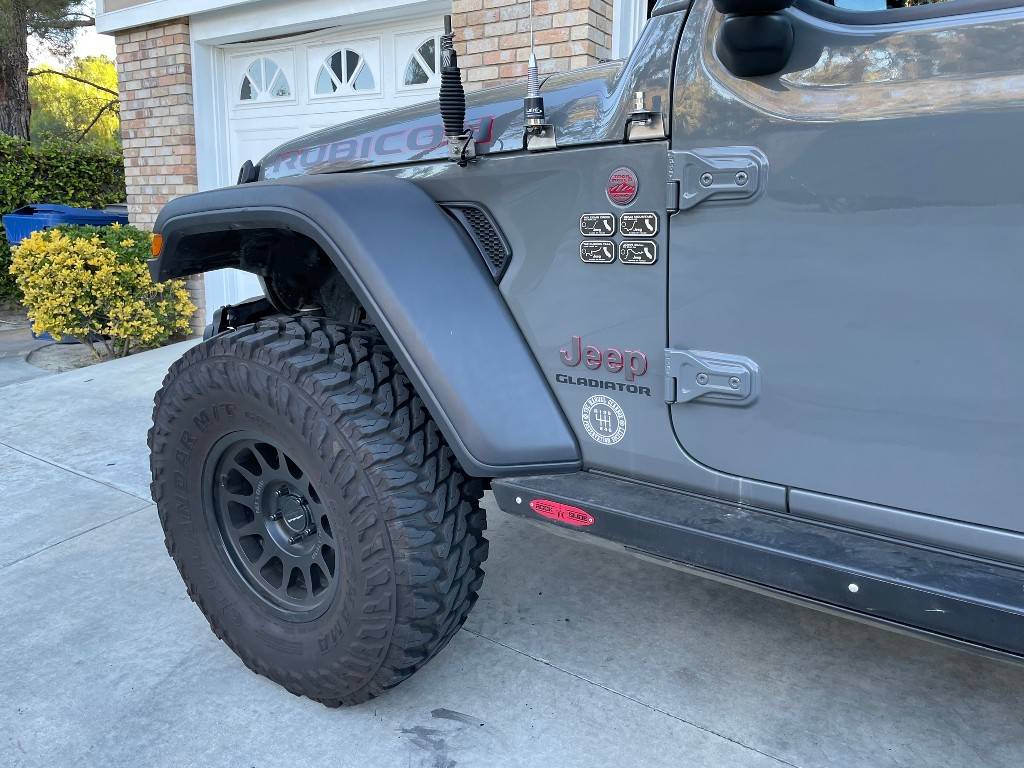

Yes, I am using 2 CoolTech Cowl mounts for my GMRS and CB antenna. They work great. Here is a pic:

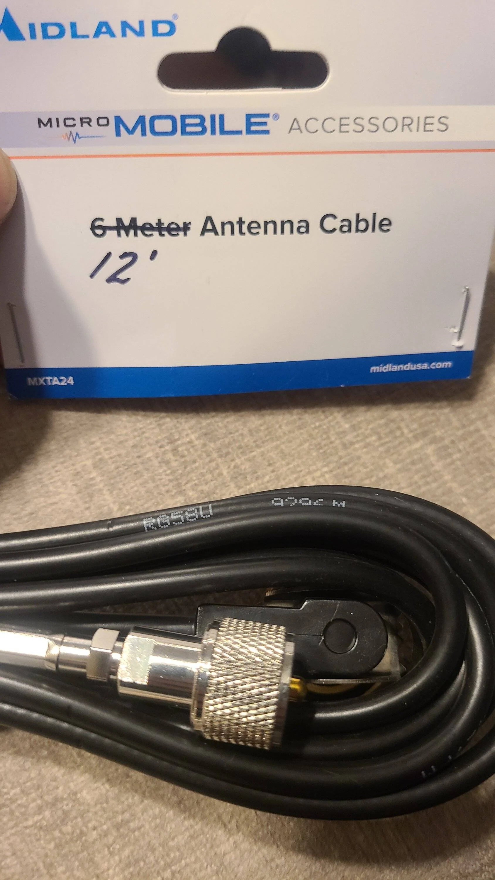

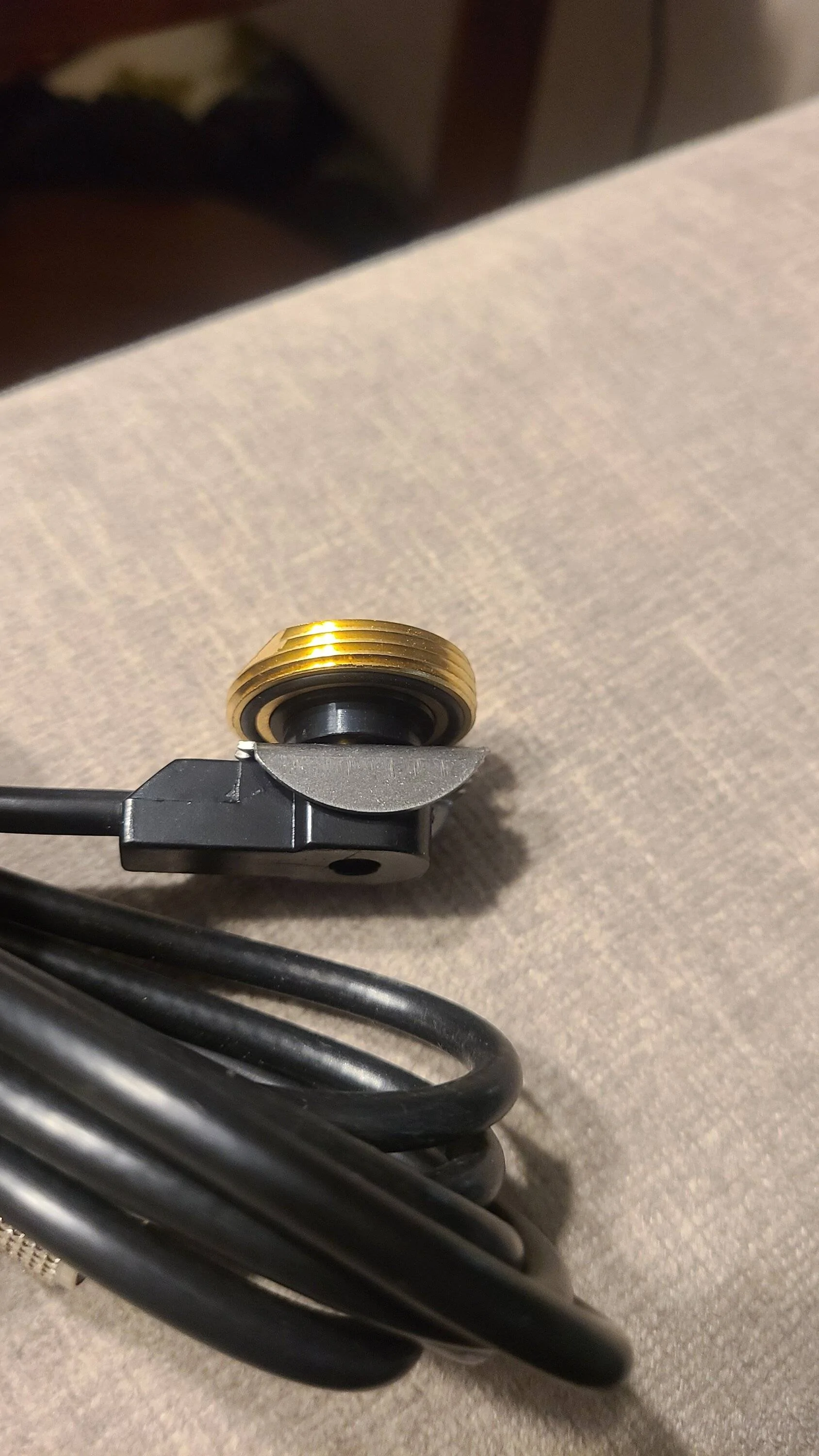

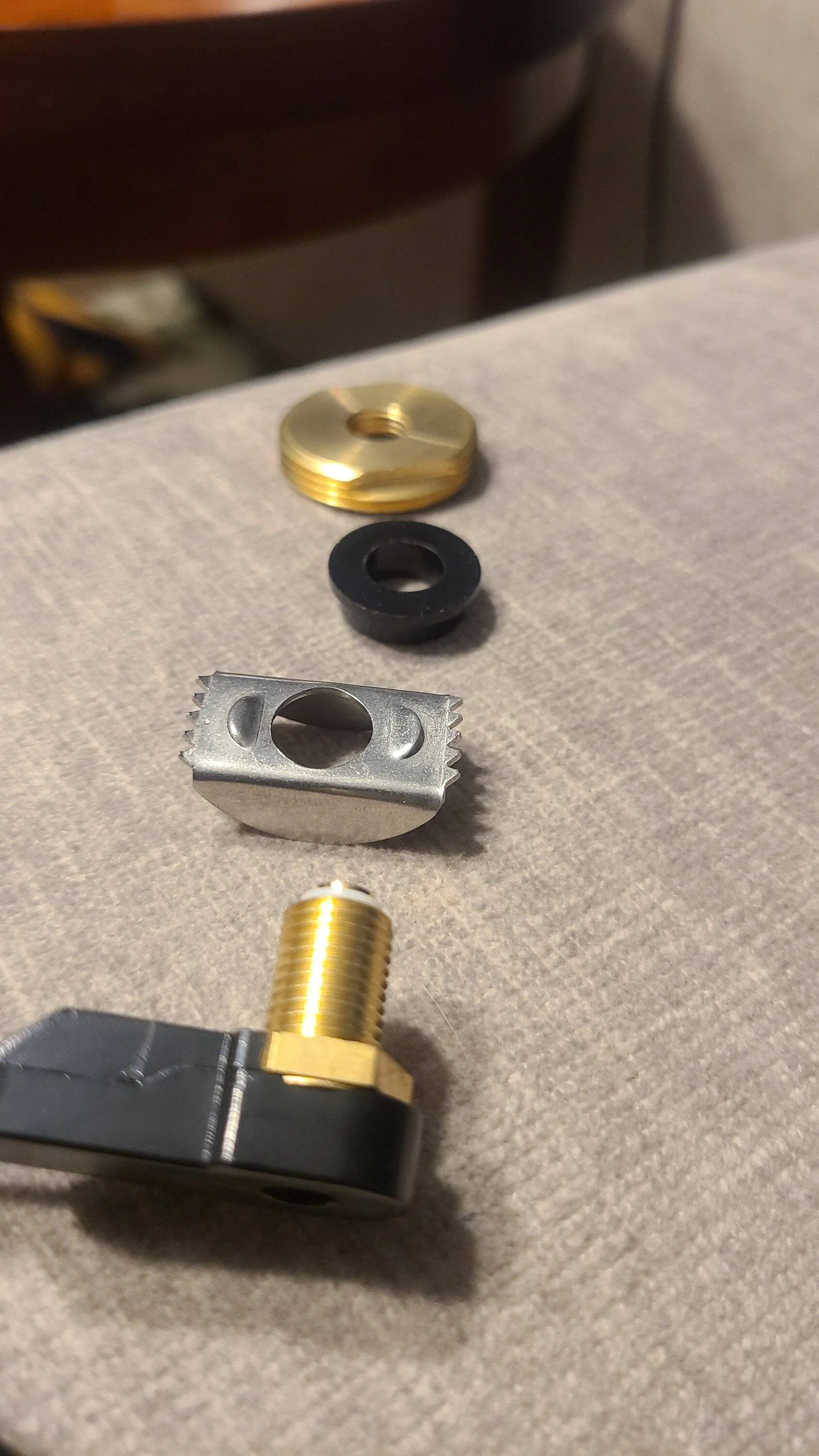

b-roc-Could you provide a little more detail as to what broke on the Midland cable/nmo mount? After a pretty extensive search I believe the Midland coax provided with their nmo mount is RG58u. Cooltech also offers a kit that includes the bracket and a 10' shortened coax/nmo assy for front mounted installs. Of course they charge extra for the shortened setup. Since someone asked about the Rugged Ridge bracket, check out the Amazon reviews. Lot of bending complaints.
b-roc
Broc
Aug 28, 2020
275
394
Denver, CO
2021 JTM

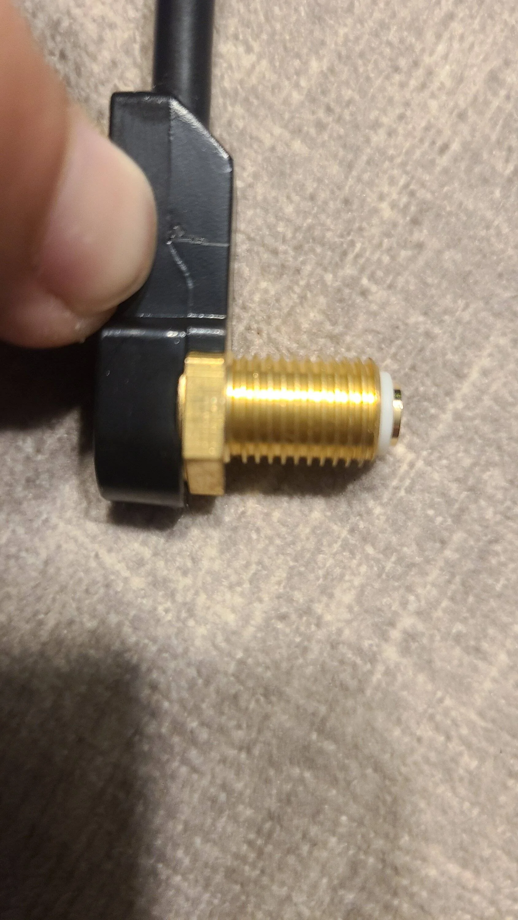

The break was at the 90 degree adapter ... I have thrown the broken one away but did go ahead and get a (unused because the ebay purchase was of significantly higher quality) replacement midland that I am including pictures of below and will point at where the break occurred at the plastic weld on the original... the solder underneath also broke ... let me know what else
I suggest using the cooltech mount ... get a better 90 degree adapter that is suitable for being outside of a jeep ... pick your favorite coax
