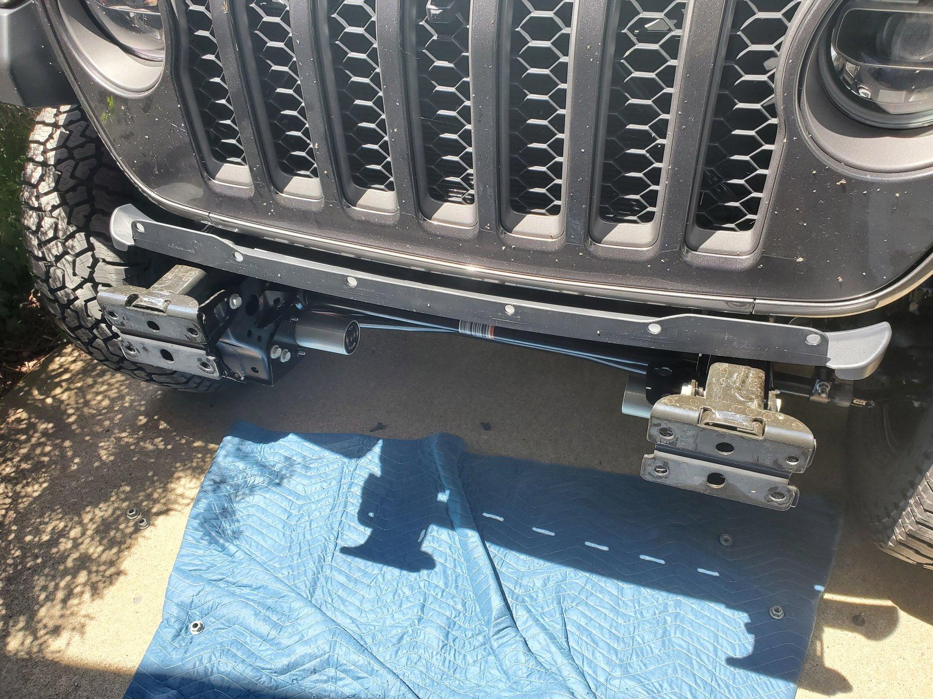

Bumper swap completed. I did have to drill the two mounting tabs on the LED light slightly larger to get the aftermarket bracket to fit snug against the light. Others have drilled the hole in the metal bracket larger.

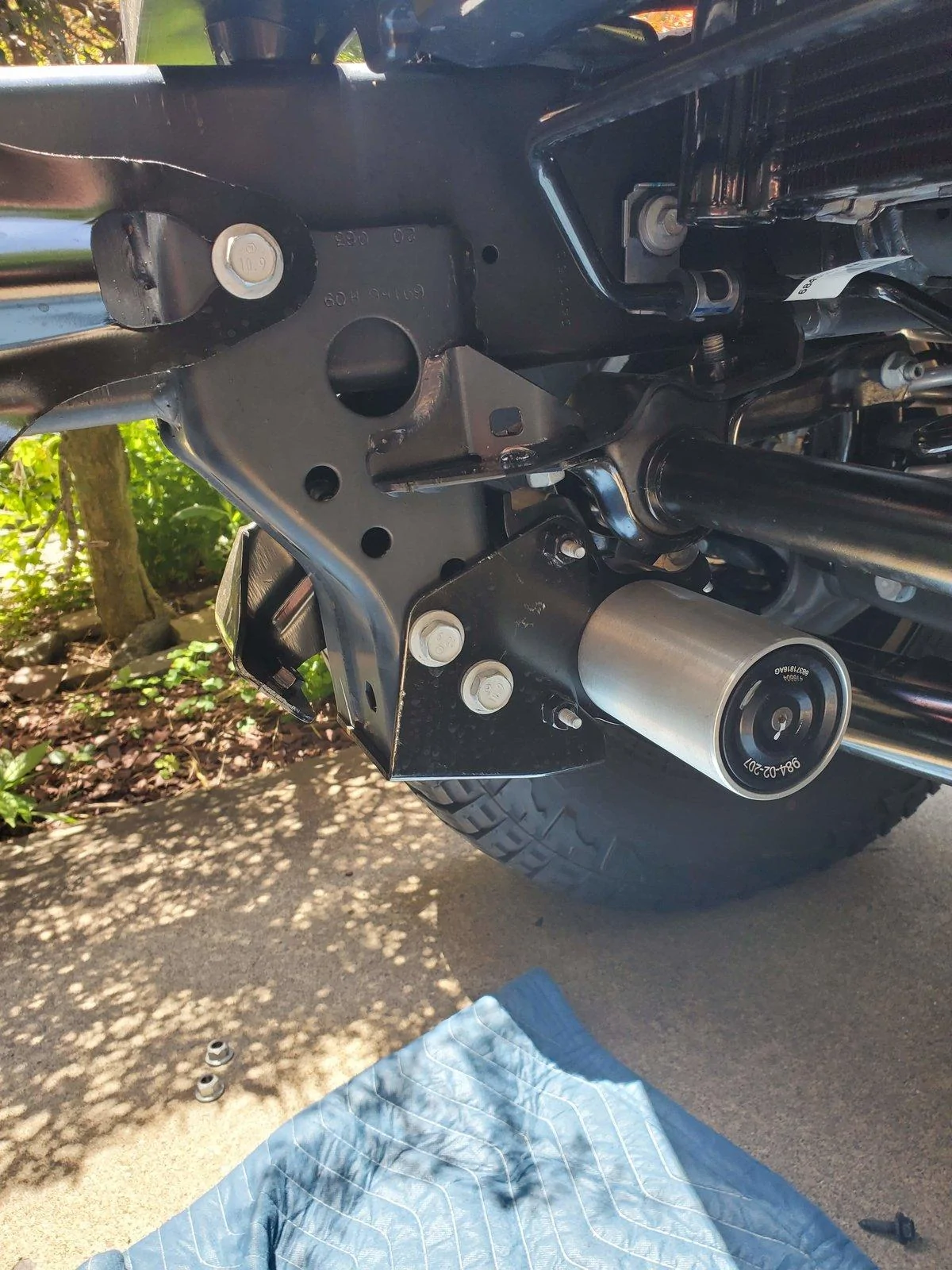

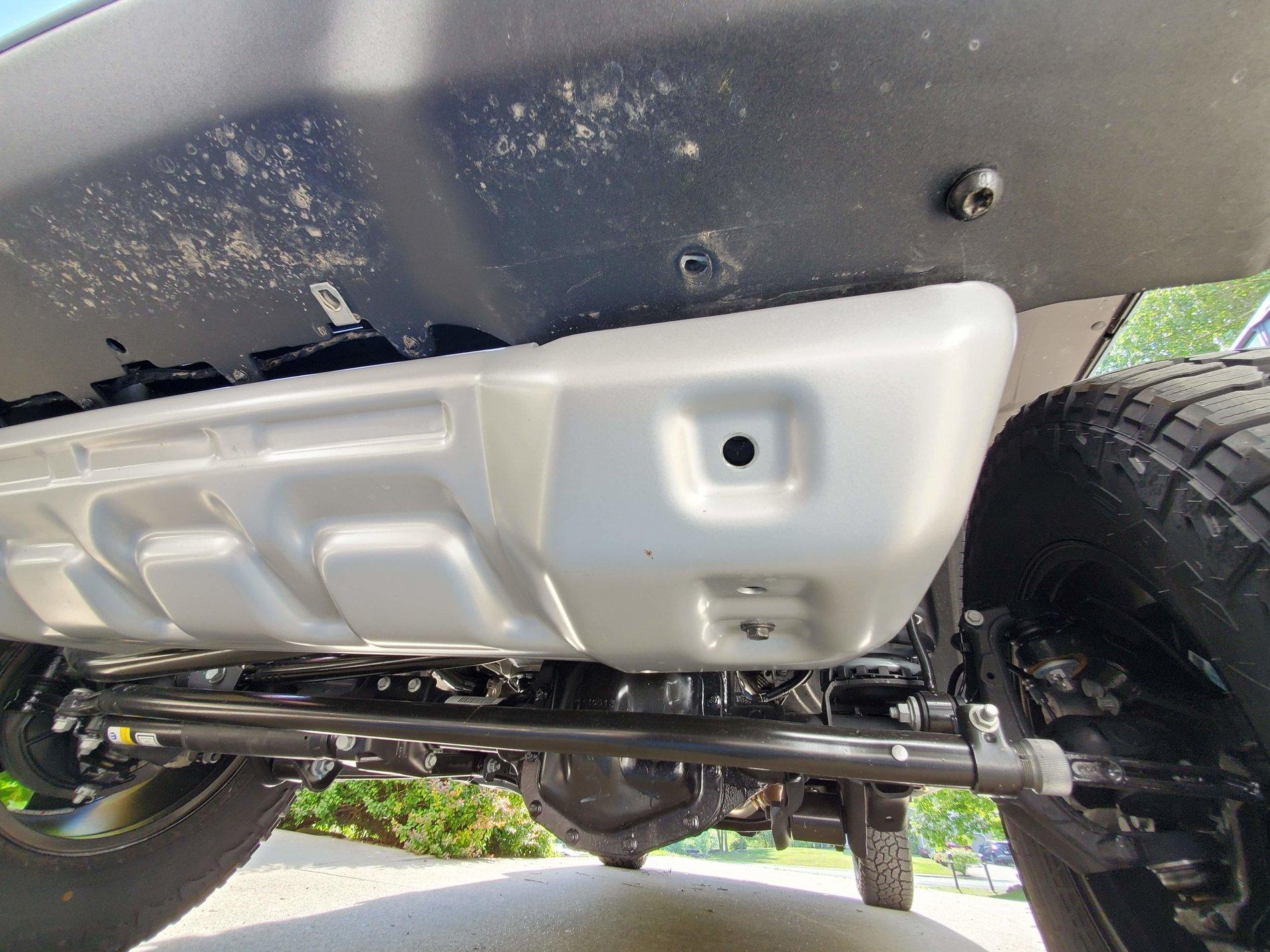

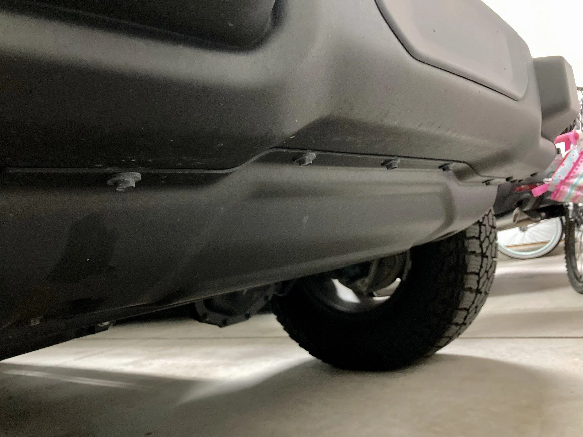

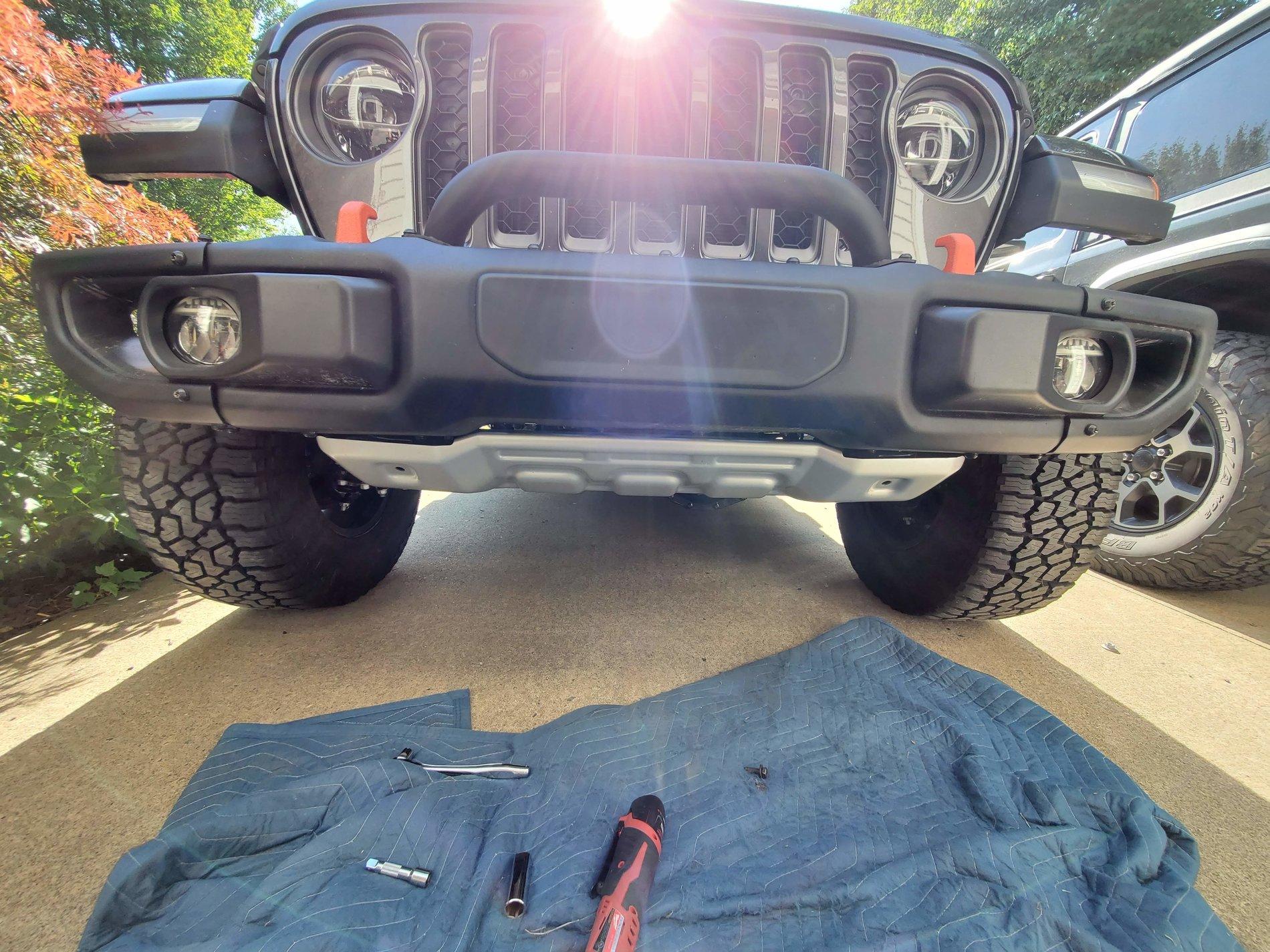

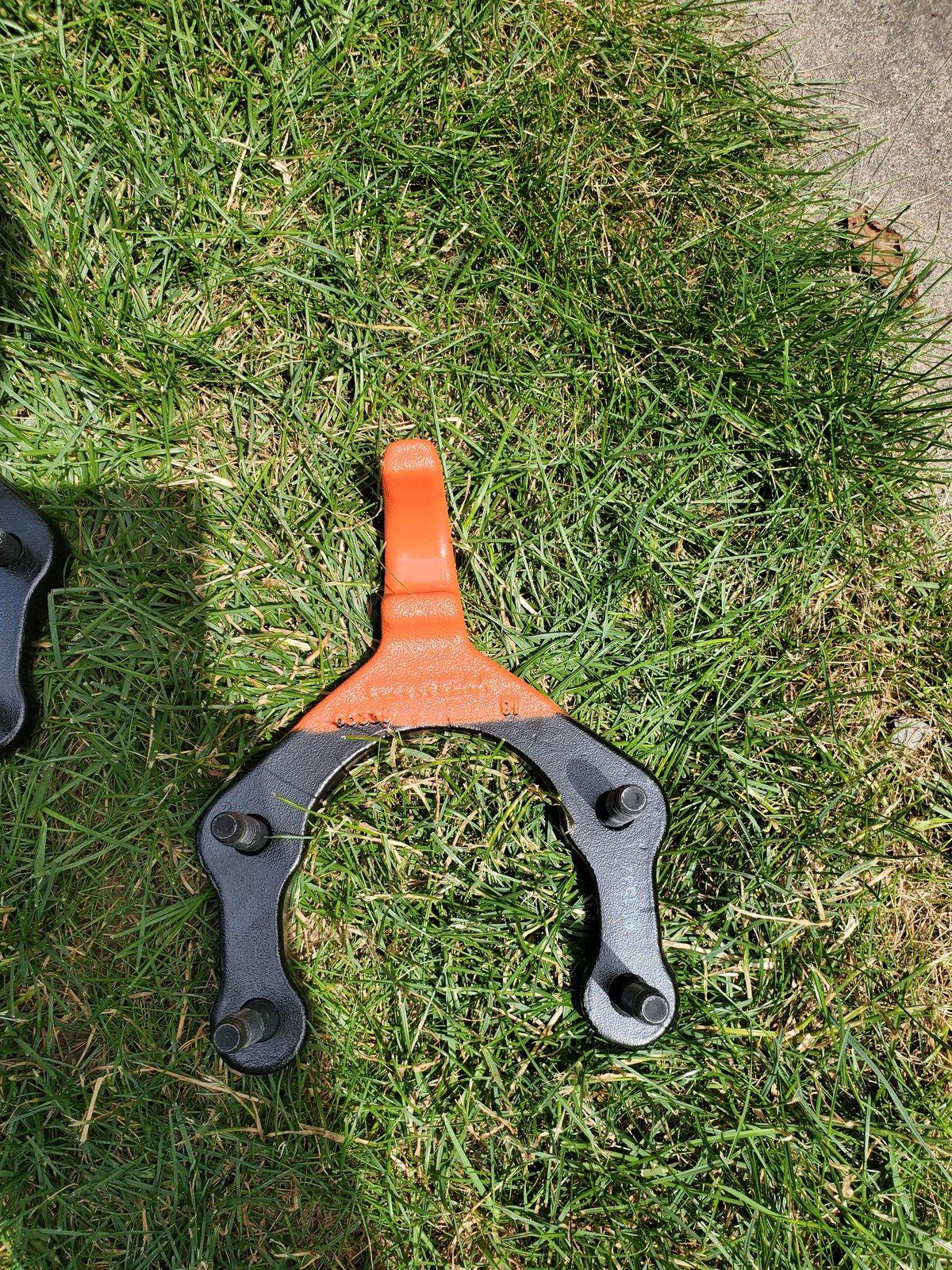

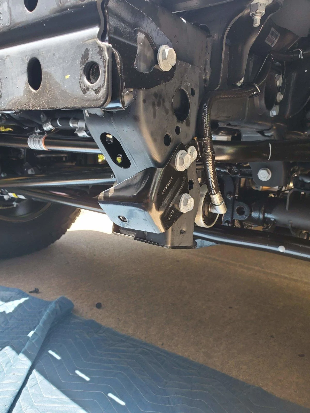

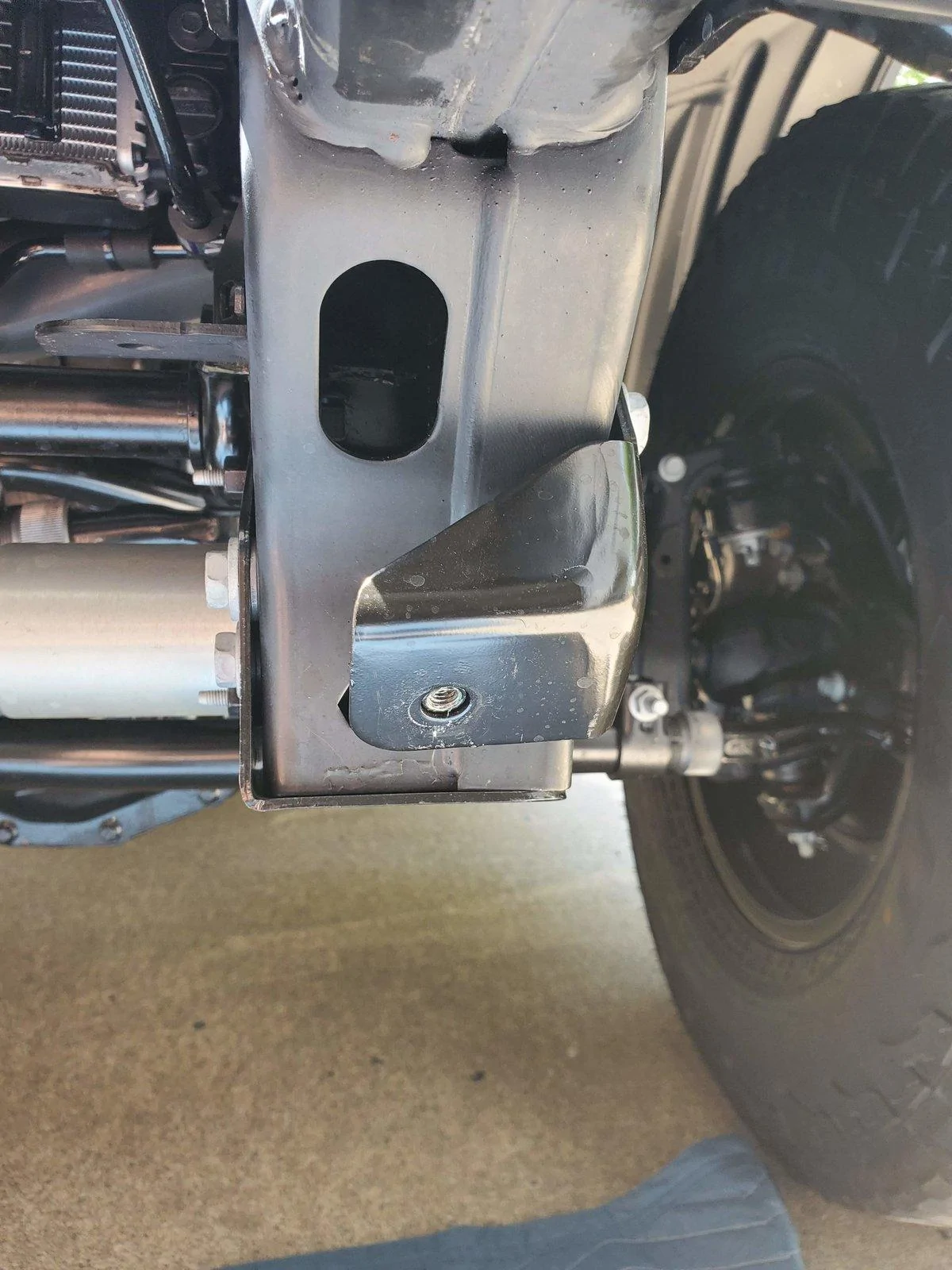

I finally did this. I bought a complete used bumper with Rubi steel skid ( the one that comes with the steel bumper group ) and closeout. I think people don't realize Rubicons have 2 different steel skids depending on which bumper.
The skid wouldn't line up and bolt ( 5 of them ) to the bottom of the bumper...something...was wrong.
Took me 30 minutes to realize it was the brackets for the Mojave skid front 2 bolts. Rubicons with plastic bumpers have these same brackets for their steel skids. Rubicon steel skid for steel bumper interferes with these brackets. The actual steel bumper interferes with these brackets. You can mount the bumper but it is SLAMMED into them. Remove them.....holy shit it all aligns.
Don't worry about Mojave shock reservoirs...rubi steel skid for steel bumper fits and protects them same as stock.
It's a much cleaner integration. The skid seamlessly connects to and blends into the lower bumper. No gaps like the Mojave skid.
ecidiego
Nov 3, 2021
62
3,625
5,580
San Diego
2021 Gladiator Mojave
IT

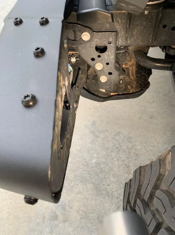

I agree. Once he takes off those outside brackets for the Mohave skid plate, it looks like the Steel bumper skid plate should bolt right in to the bottom of the frame.
Here is my Rubicon JT with the steel bumper and steel skid plate installed. You can see the old two bolts that had the old Rubicon bracket for the rubber bumper skid plate. I kept those 2 bolts on each side in case I need bolts on the road. Looks the same on the Mohave.
Quoting for emphasis. I installed the steel bumper on my Mojave this week. I didn't realize I needed to remove those brackets. Bumper mounted fine...but the Rubicon steel skid would not line up. Was about to hog out the holes when I realized there were those 2 no longer needed brackets from the Mojave steel skid.

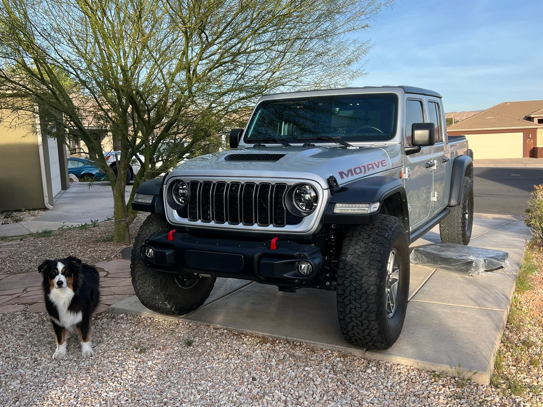

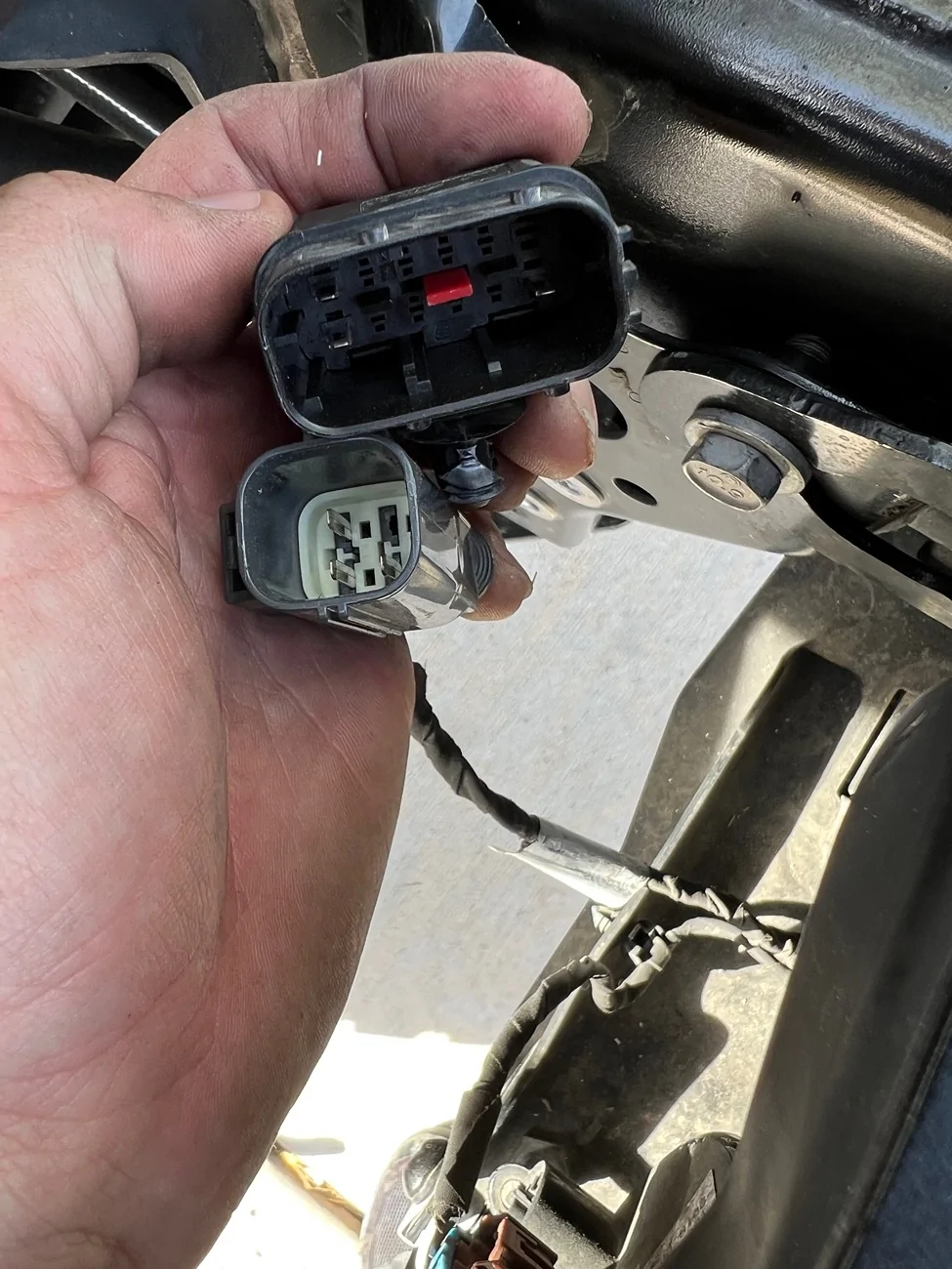

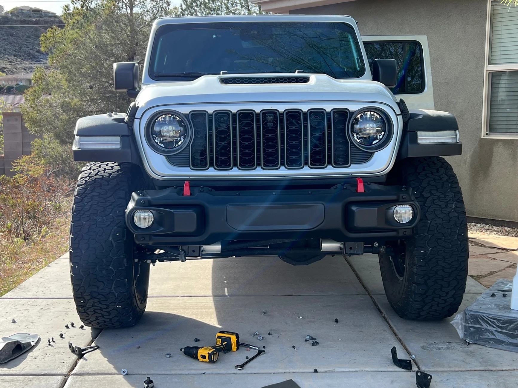

Just swapped a 2020 Rubicon steel bumper to my Mojave. Ran into a couple issue. Main issue is the fog light plug is not the same. Do I need to use the wiring from my plastic bumper and wiring it to my Rubicon fig lights? Or do I need to go with Diode Dynamics which I would rather not do. I just don't understand why Jeep would use different plugs. Decided to not use the Mojave skid. Getting new Fox front replacement shocks tomorrow so I will mounts steel skid after I get it back unless the dealership does me a solid and mounts to for me.
Jeep Gladiator Swapping the Mojave plastic bumper with the Mopar steel bumper IMG_7160
Jeep Gladiator Swapping the Mojave plastic bumper with the Mopar steel bumper IMG_7162
Jeep Gladiator Swapping the Mojave plastic bumper with the Mopar steel bumper IMG_7168

Did the led fog lights from the plastic bumper bolt pattern fit into the steel bumper?
