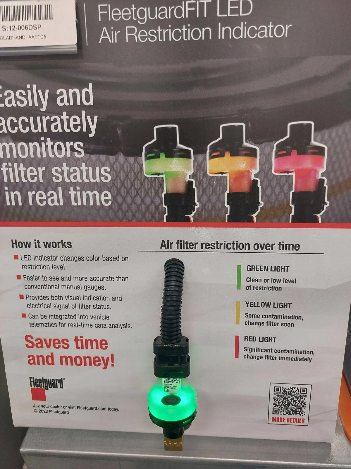

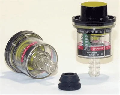

If the MAF detects an abnormally low air flow, it will set a code........... perhaps you can take a baseline...............
Supposedly most vehicles will trigger the MIL if the MAF detects a plugged air filter.
I've often thought of installing a vacuum gauge in the intake tube and watch what happens over time. If there's any sort of restriction, it would pull a vacuum.
