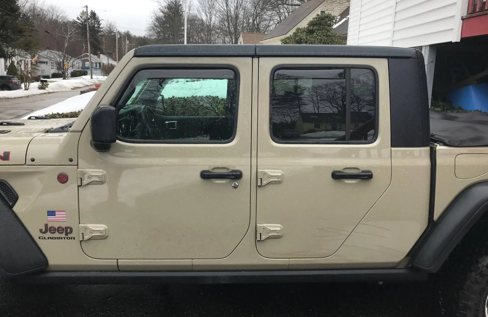

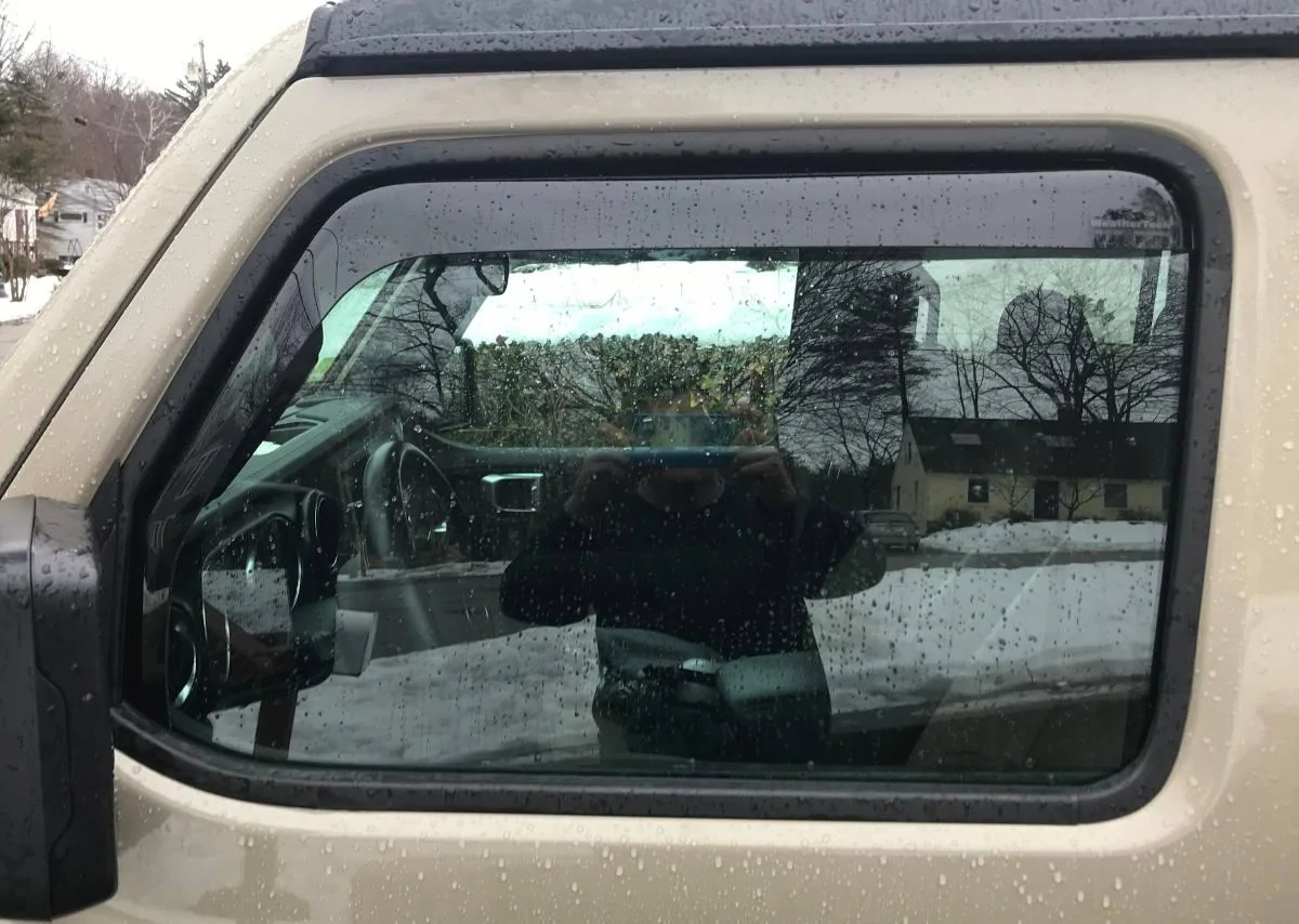

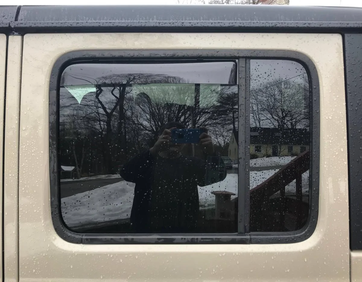

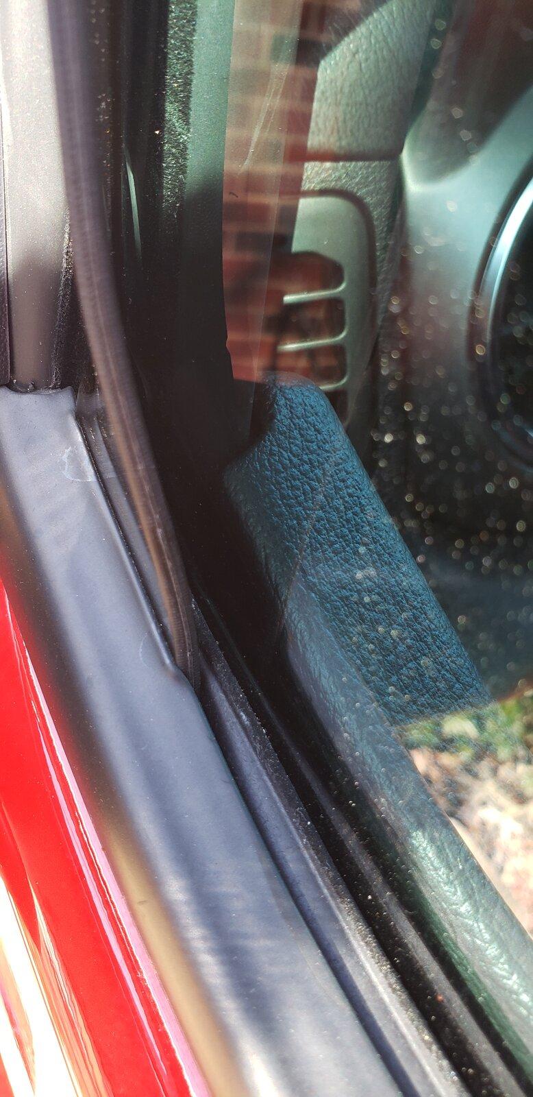

They arrived today and I just installed them.
You have to give the front ones a really good flex to get them inserted (this is normal) - but I always feel like they're going to break and send shrapnel into my face. Wearing safety glasses during this part wouldn't be a bad idea!
Installation was easy. The only issue I had was one of the front deflectors doesn't have enough spring tension on its forward end to hold itself up when the window is rolled down. I'm going to let them sit for 48 hours with the windows up (per WeatherTech instruction sheet) to and this may fix it. If not, a small bit of double-stick adhesive tape will work. I had this issue with the set I installed previously on my Ram.
The rear set comes with metal clips (2 per side) to install in the channel, and these keep the rear visors from falling down when the window is rolled down. Rears used to come with double-stick adhesive, but the clips probably work better.
I'm very happy to have these again, and being able to leave the windows cracked in the summer without having to deal with anything if it rains. The quality is superb.

thanks for the pics. I like this much better than the stick on style I have used on past vehicles.

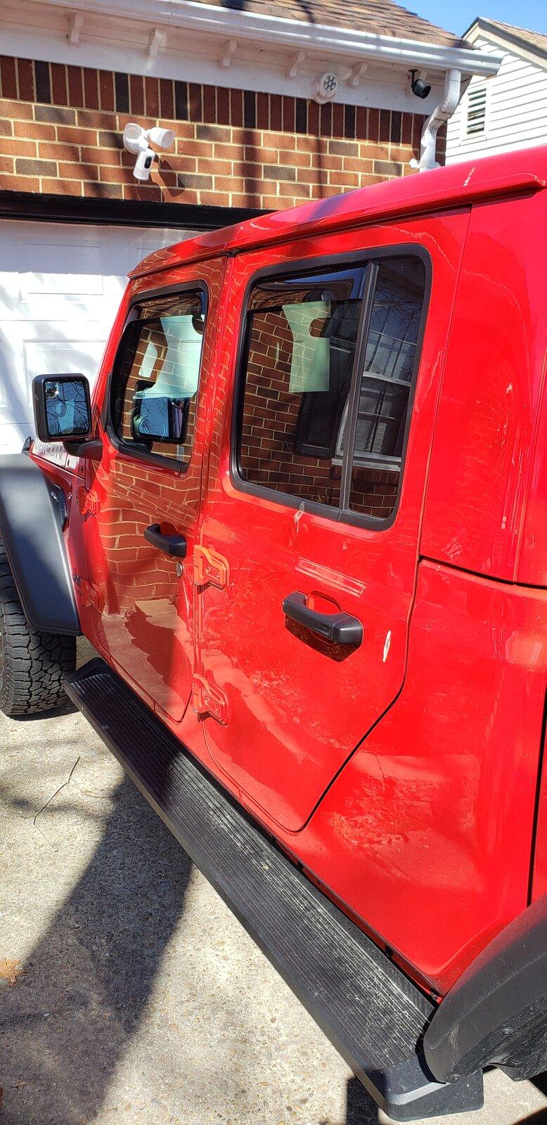

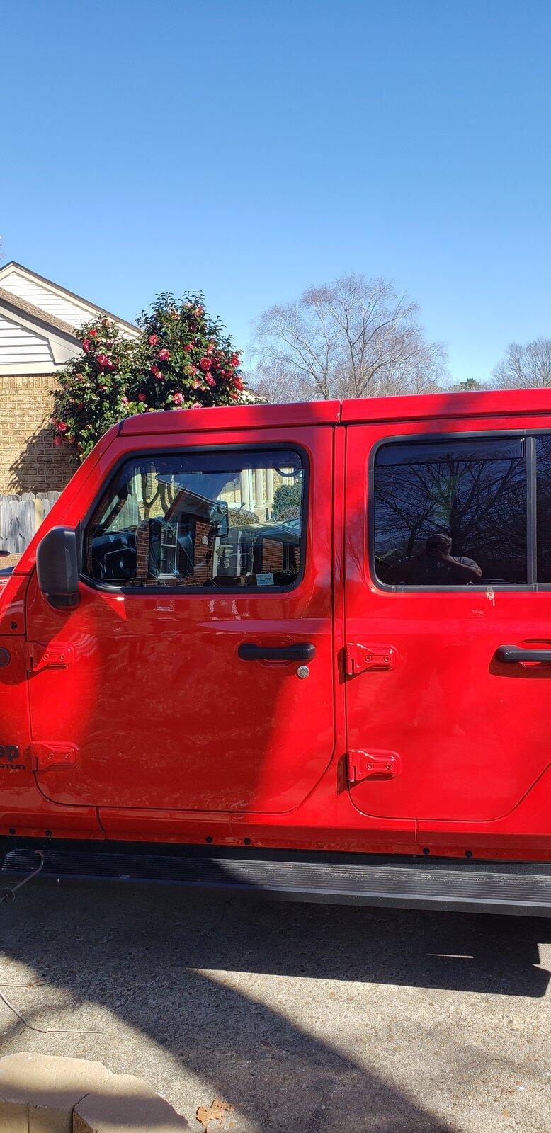

Following up on my post - it turns out now that both front window visors are falling down when the windows are rolled down, even after letting them sit with windows rolled up for 48 hours per WeatherTech's recommendation.
I assume (you know what they say about assumptions...) what's happening is that the visors are pressing against the rubber window seals and causing the seals to have memory in the pressed-out configuration, so that when the windows are rolled down, the seals can't grip the visors.
I sent an email to WeatherTech last night asking if they could send me a set of metal clips (same as used on the rear visors to prevent this problem) - thinking that if I put them on the front visors, it would solve the issue.
Just got an email alert from FedEx saying something's shipped from WeatherTech, and I assume it's the clips.
Long story short, great customer support from WeatherTech. With no questions asked, they took action in less than 24 hours. Again a disclaimer, I have no affiliation with this company other than being a long-time customer. Great products made in USA and responsive customer service and support? Done deal.
I'll report back after I install the clips. While I'm sure this issue can be solved by simply installing a couple pieces of double-stick adhesive, I like the clip solution if it works.

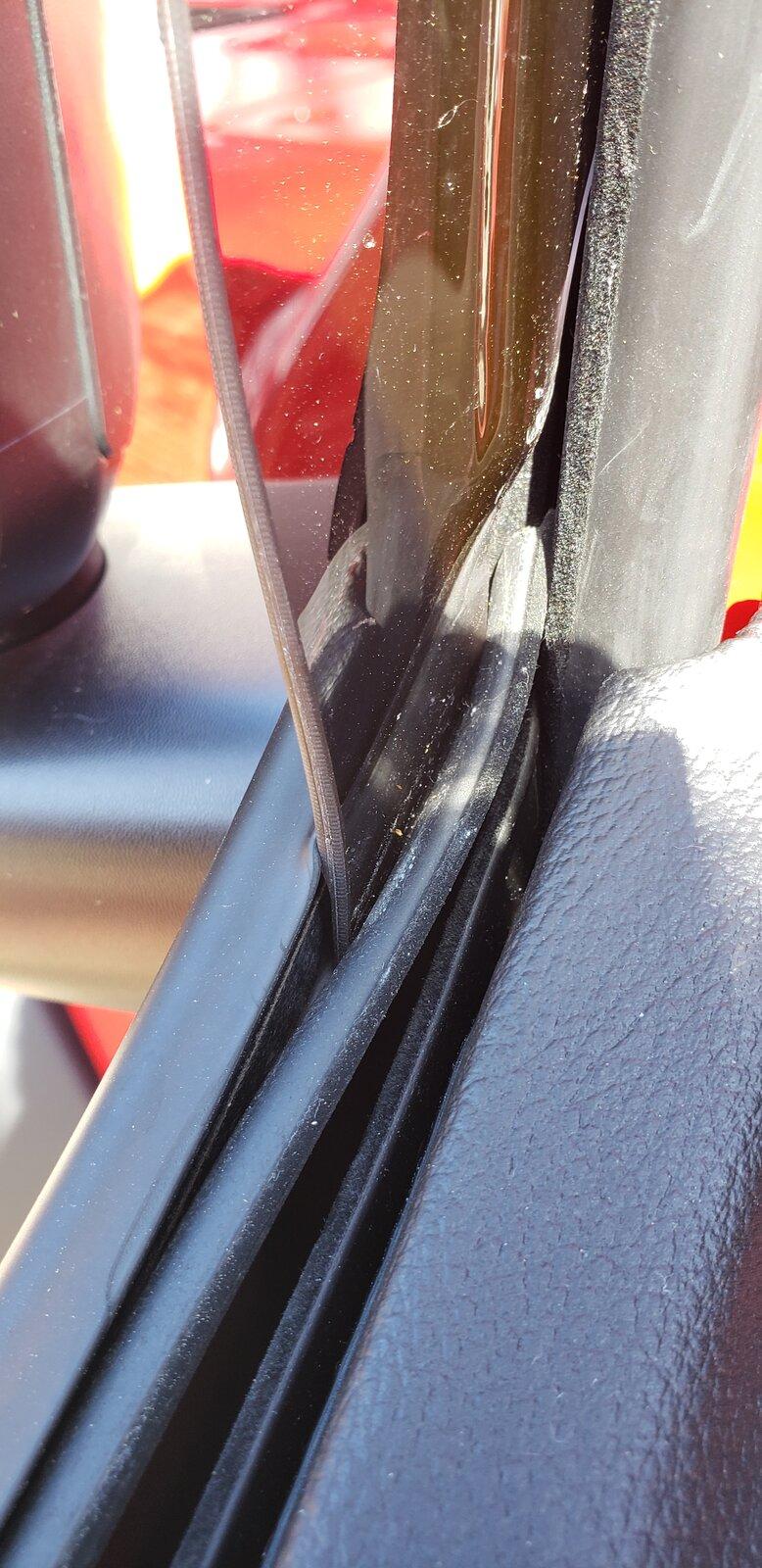

We are not having this problem and my wife uses her window all the time. My biggest complaint was the written directions. Once I googled an install video, they slid right in. You have to make sure the front bottom tab is between the door and window rubber gasket. Once I watched the video it made sence.
Thanks for the tip! Clearly a case of "operator error" on my part, and I even read the instructions.
Very happy to report they are working perfectly now. Thanks @miseryshusband :beer:
I am a technical writer by trade, and WeatherTech needs better ones. Not operator error, directions error.
