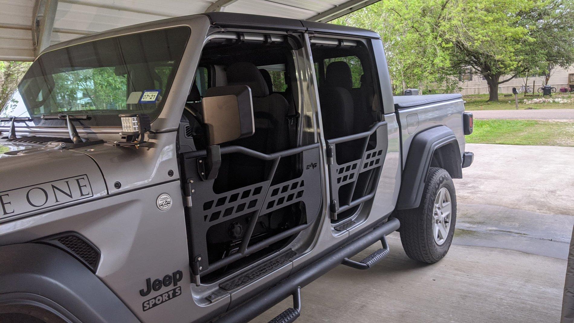

Today I received my EAG Safari Tube Doors w/ Mirrors. Picked them up from Vicious Offroad for $313 shipped (had to call to get that price). Also, when browsing their page, their Gladiator links for these doors show a price of $999.99 while the JL version (which are identical) list for $329. I made them aware of this so it may now be corrected, I called about the crazy price then asked for their best price shipped.
So, they arrive with the front doors and rear doors bundled together. You also get 2 smaller boxes for the mirrors, 4 boxes for the hinges and one box for the hinge hardware. The two page instructions are just ok. They don't explain why half the hinge bolts are longer (25mm vs 20mm). You get 8 of each size. I assume their are longer ones for the front doors to account for the door strap (the straps are built in to the rear doors). So I just used the short ones for all upper hinges and the longer ones for all lower hinges (even though the rear doors don't have the extra strap bracket like the front).
Putting them together and installing them was a breeze. I had to do some minor adjustments to get the latches to close nice and snug, but it wasn't too much of a hassle.
The fit and finish are quite good, I noticed no defects on the finish of the doors. I had read/watched some reviews and wasn't expecting much from the mirrors, but they work great for me. They are larger than stock and give me a better view than stock. Don't know if they made changes to them but I don't see why anyone would have any issues with them.
Took it for a spin before removing them (we have rain predicted all weekend) and noticed no rattles or other noises. So, if your like me and can't fathom the nearly $1k price of the Mopar doors (and a few other brands) these are a great quality alternative.

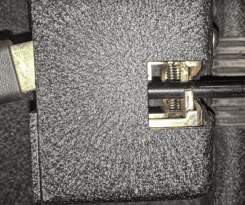

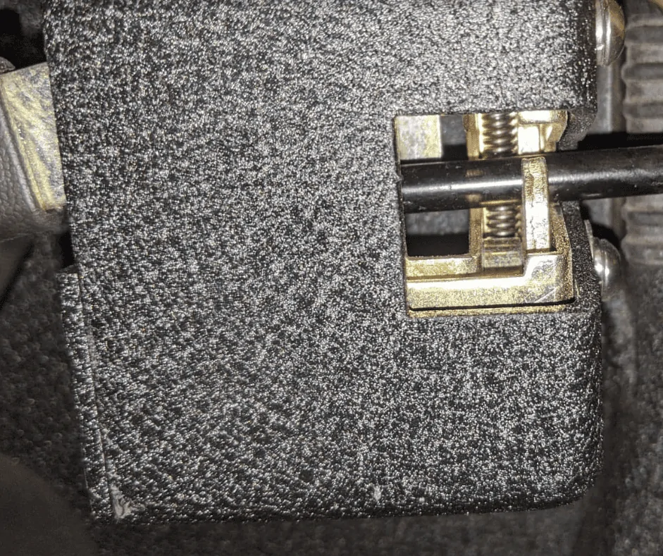

There are two "levels" of latching. If you just push your door in you'll hear the latch engage, give it a firm shove you'll hear the second click. You can see how well the latch is engaged if you look into the latch assembly from the inside. I suggest you remove the rubber bumper and then shut the door. It sounds like your latch isn't engaging past the first click. You may need to shave down the bumper.
Below is an example.

Thank you for the info. Took off the bumpers and got it to engage, but then tried again and it wouldn’t go. Just inconsistent. I’ve also caught the bolt wrong a few times when adjusting and getting close to stripping it, so gonna grab some backups and continue to tinker. It’s both back doors, however the passenger one is more of a headache than the driver side.

One other tip, and how I got things to line up properly on the rear doors (and front for that matter) is loosen the bolts that hold the door to the bracket. Engage the latch properly and hold it in place, then tighten the bracket bolts on the door (I did this by myself, so it can be done, but another person would make it much easier).

I had to shave down the rear rubber bumpers for them to latch correctly but now they work great.
