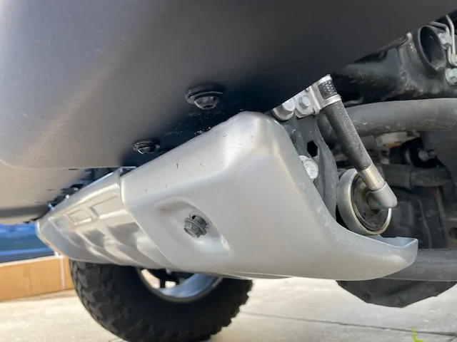

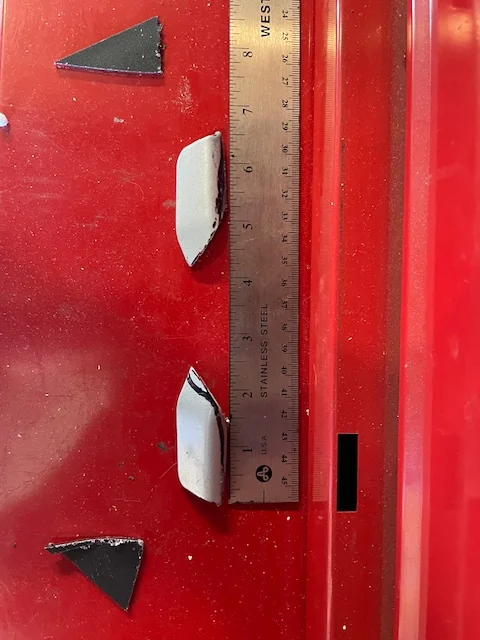

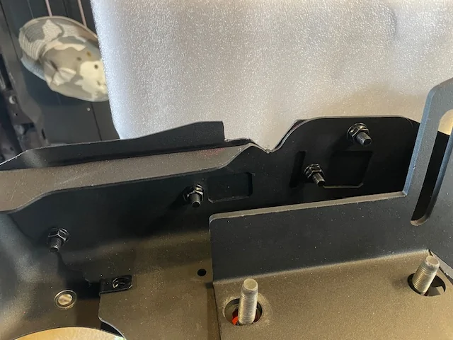

It does look like the same images of the steel version. If it is the same three piece bumper design made of aluminum that would be a great with the winch plate, license bracket, lights and tube guard. The only issue with the steel version is it says powder coated unfortunately it is not even painted with a durable paint hopefully this one will be appropriately coated but if not still a great value. As mentioned the skid plate may need a 1/2 by about three inch cut off the front corners. i also had to cut a notch in the steel bumper on each side on a steel version along the lower edge to clear the Mojave skid mounts it looked like it should have been trimmed that way already maybe some are.

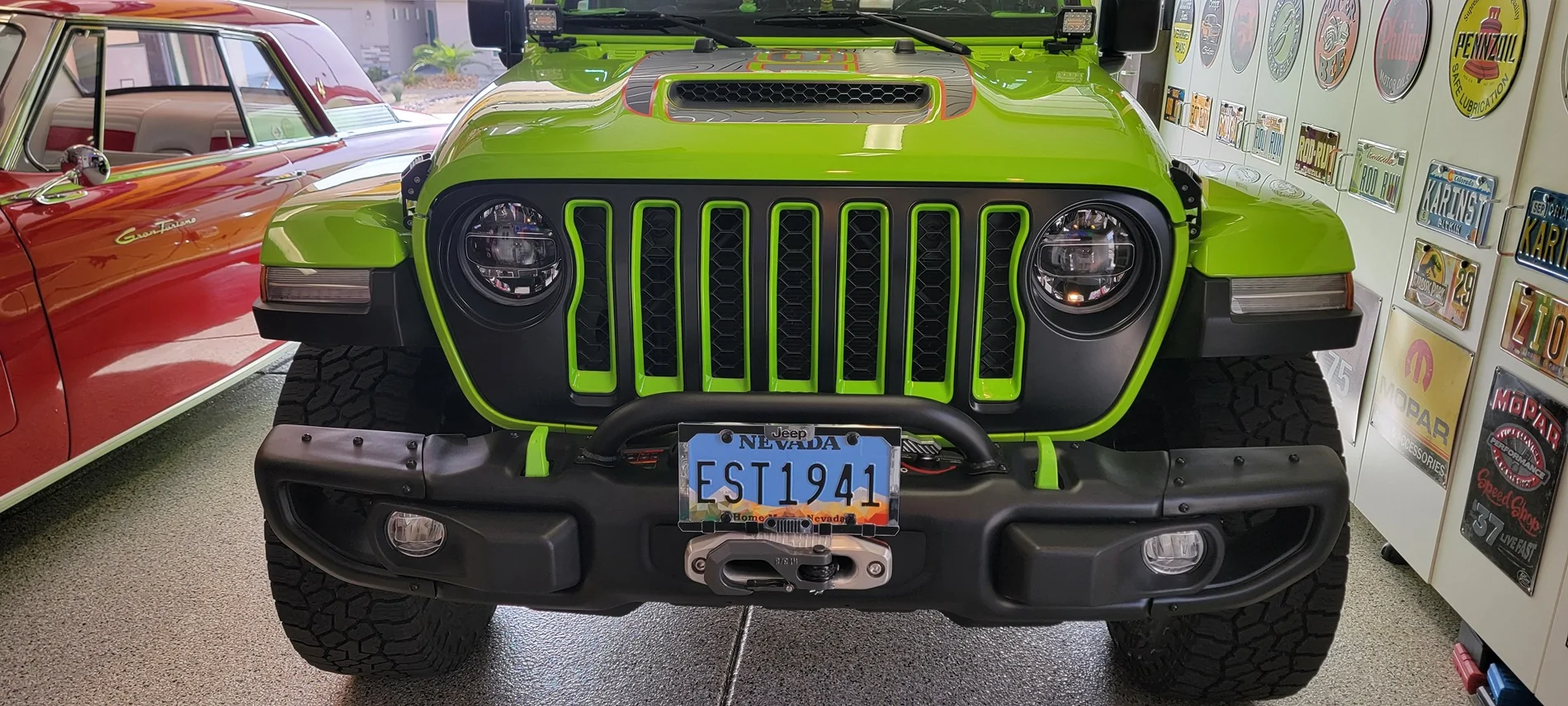

I purchased the aluminum 10th Anniversary bumper with winch plate for my 21 Jeep Gladiator Mojave. The bumper fits with only two slight trimming modifications. One trim was for the winch, had to trim a small amount on the top driver side area to allow the operation of the winch free spool handle (12000 lbs Badlands Apex winch). The second was the OEM steel front skid plate. Trimmed 3/4" off the two upper cor
Jeep Gladiator eBay aluminum bumper? 20260209_125655
ners in order for it to fit.

It does look good with the black grill. I would guess it is being made using the same specs as the steel knockoffs of the MOPAR bumper probably in the same manufacturing facility.
