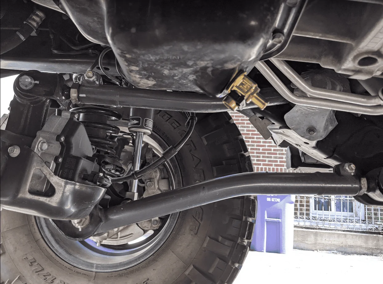

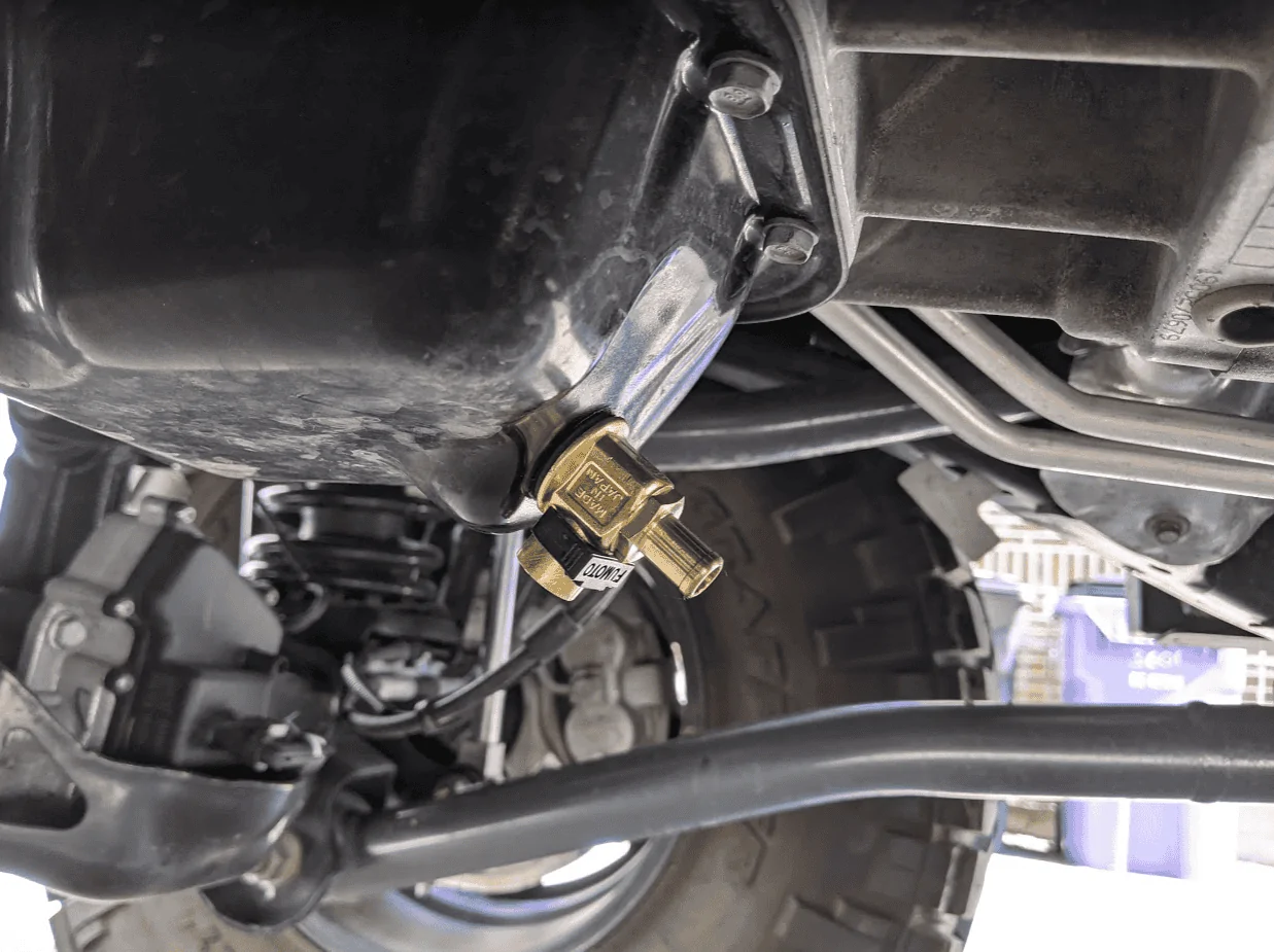

Update: I installed the Fumoto F106N valve yesterday. Fits perfectly and no fuss on install.

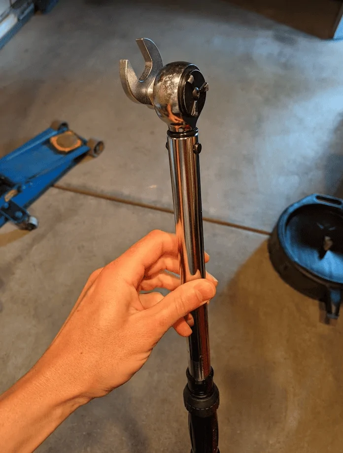

I will note that I used a 19mm crow's foot to torque down the valve to the OEM plug spec = 20 ft/lb
Fumoto's instructions say finger tight then 1/8 turn. I feel like this was closer to a 1/2 turn using the OEM torque spec. Just wanted to mention it as I am a big fan of following torque specs.
