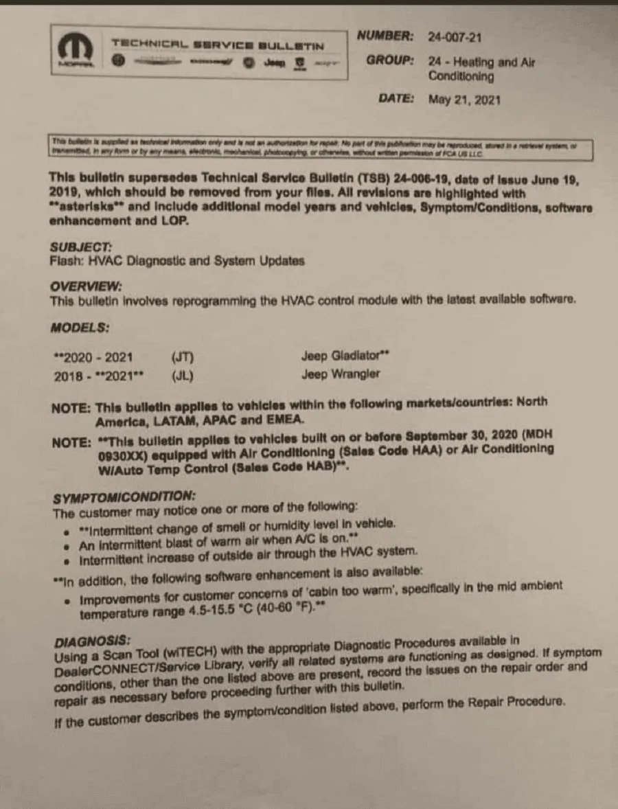

Did anyone ever get a fix to this?
40,501
54,021
Yes.
But be warned - in my case this drastically changed how my heat works. Now if it's 45-55 outside and you have the heat on, once it warms up inside and after driving at least 20 minutes or so, I get 58 degree air coming out of the dash vents (yes, I used my AC thermometer to actually stick inside the vent and measure the temperature)
You'll be driving along at 50 mph or higher and feel chilly because cool air is coming out the vents. Supposedly this is the CORRECT way it should work according to the OWNERS MANUAL - warm air at feet, cooler air out the dash. It's literally in the book as being correct. Brrrr.
Jeep Gladiator Heater/AC blowing hot air at 60 or higher HVAC-TSB

Yes.
So would you have rather left it the way it was?
40,501
54,021
In my case it was rare that it kicked out the warm humid air with the AC on.
The conditions had to be right - hot and humid out, AND long drive, over 45 minutes, usually over 60 minutes before it did it the first time, then it only lasted seconds and went right back to AC mode after a few seconds.
Mine never use to kick cool air out the dash vents when it was below 60. I don't like driving along and having 58 degree air suddenly BLOWING at my face and hands.
At least the warm moist air when the AC was running was only out the passenger side and only from down low - never in the face. I'd take that over being chilly from being outside, getting in and hoping the cabin warmed up to 68 or 70 degrees and then just when things are perfect, cold air come blasting out the dash right at my face and hands. Yes, I DO turn the vents - but I used to rely on WARM air coming out those vents to WARM my hands.
Frankly, IMO - the fix sucks.

It will blow whatever is needed to get the cabin to the temperature you set. It's not like a heat pump that blows 70 degree air if you have it set to 68 in the winter - taking 30 minutes to warm up the house. It's more like if you set it to 68 it's going to blow 75 degree air to get it to 68 faster and then cooler than 75 air coming out the vents to maintain that 68 degrees.
I've noticed that it detects the sunshine, and outside temperature as well. When the ambient air sensor went beserk a few weeks ago and said it was 80+ degrees and it was below 0 outside, the truck never did warm up inside and kept putting out 50 degree air.
Once the sensor - on its own - later started showing 100% accurate ambient air temps (outside the cabin temps) then the HVAC started working as expected.
I do dislike that it blows cooler air through the dash vents, though, when you are trying to get it warmed up in there.
Mine have worked great in the summer. AC is perfect, the HVAC is brilliant in the summer and fall and spring, but come winter, it's not so great. It's either baking you or freezing your hands with cool air out the dash vents when it's 30 degrees out.
My 2020 actually did great in the winter until they applied that "fix" to deal with the occasional warm air in the summer. I really wish I had left that one alone. The 2022 acts like the 2020 did after that fix.
