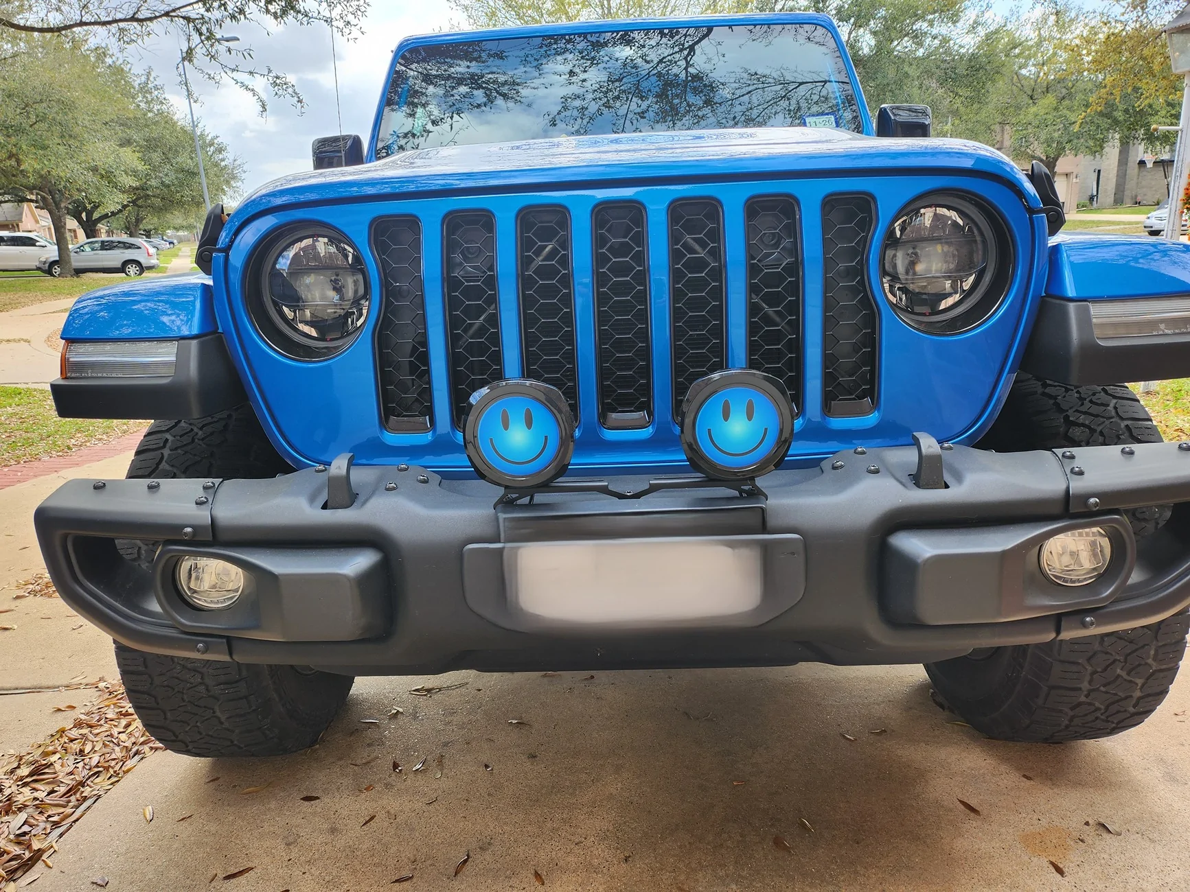

I'm not a fan of cowl lights either, being they inhibit the lowering of the windshield. Have I ever lowered it ? Nope, not yet, but I can. With cowl lights, that's a no-can-do. Ever.
I didn't want to go '70's crazy with a crap load of KC HiLites all over the front end. I bought a nice, heavy metal light bracket for my factory steel bumper; it mounts without drilling (mucho important to me) from a company called Grimm Offroad (60 bucks, worth every penny) and some bright round 5" 160w 18,800LM LED's. The blue smiley face decals was a "why not ?"...
Jeep Gladiator Ideas for lights for my new ride Off Road Smiley's Decals

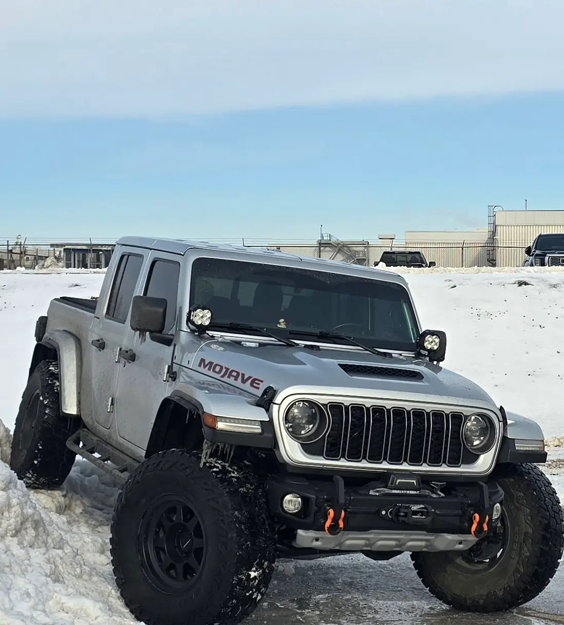

Not a great picture, but here are the Baja Designs LP4s mounted on my old OE steel bumper:
Jeep Gladiator Ideas for lights for my new ride IMG_2507
BD LP4 steel bumper kit
They also have a kit to mount the larger LP6 lights the same way, but I went with the smaller LP4s to minimize any obstruction of airflow to the radiator.

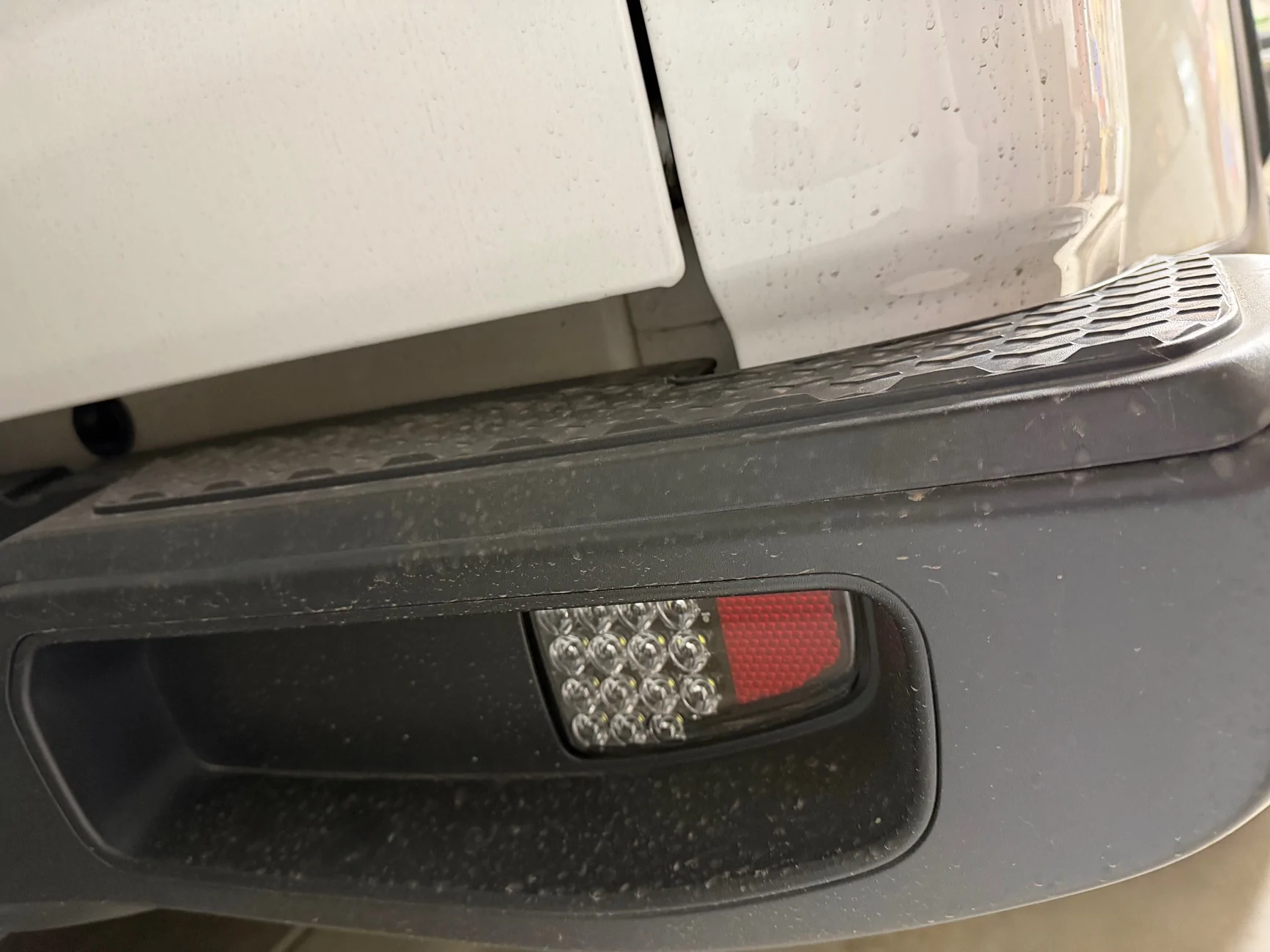

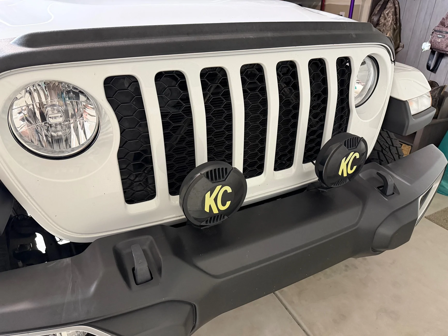

I use KC slimlite spots. I put 4 on top of a sports bar. No glare whatsoever so ever and I don’t loose any of the main spot beam since I don’t have any leveling. Easily reaches out 100 feet. Then I put two on the front bumper. I can put amber / yellow / clear lense covers and utilize them as spots or use the SAE diffused covers for driving. I also use LEDs for the fog lamps to see in front and sides of the front bumper. If I turn them all on, I can light up and see everything from the bumper to 100 feet out.
Lastly. I put those oricle back up lights on a separate switch.
Jeep Gladiator Ideas for lights for my new ride IMG_4636
Jeep Gladiator Ideas for lights for my new ride IMG_4638
Jeep Gladiator Ideas for lights for my new ride IMG_4637

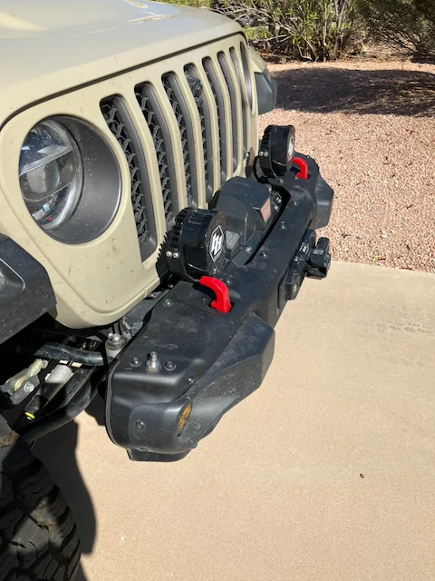

Currently, I only run cowl/ditch lights. For the overlanding we do, they are critical. Mine are angled about 45 degrees out because I need to see off the side of the road/trail when looking for possible campsites after dark. I will eventually put some supplemental front lights on, but the factory LED headlights are pretty fantastic compared to previous vehicles I have owned. I am not running high speed at night and I am usually pulling a trailer, so I am never over-driving my headlights.
These are Auxbeams that I salvaged from my old truck. They work well. I will eventually splice the amber backlight into my marker lights.
Jeep Gladiator Ideas for lights for my new ride IMG_5630
Jeep Gladiator Ideas for lights for my new ride IMG_5629
