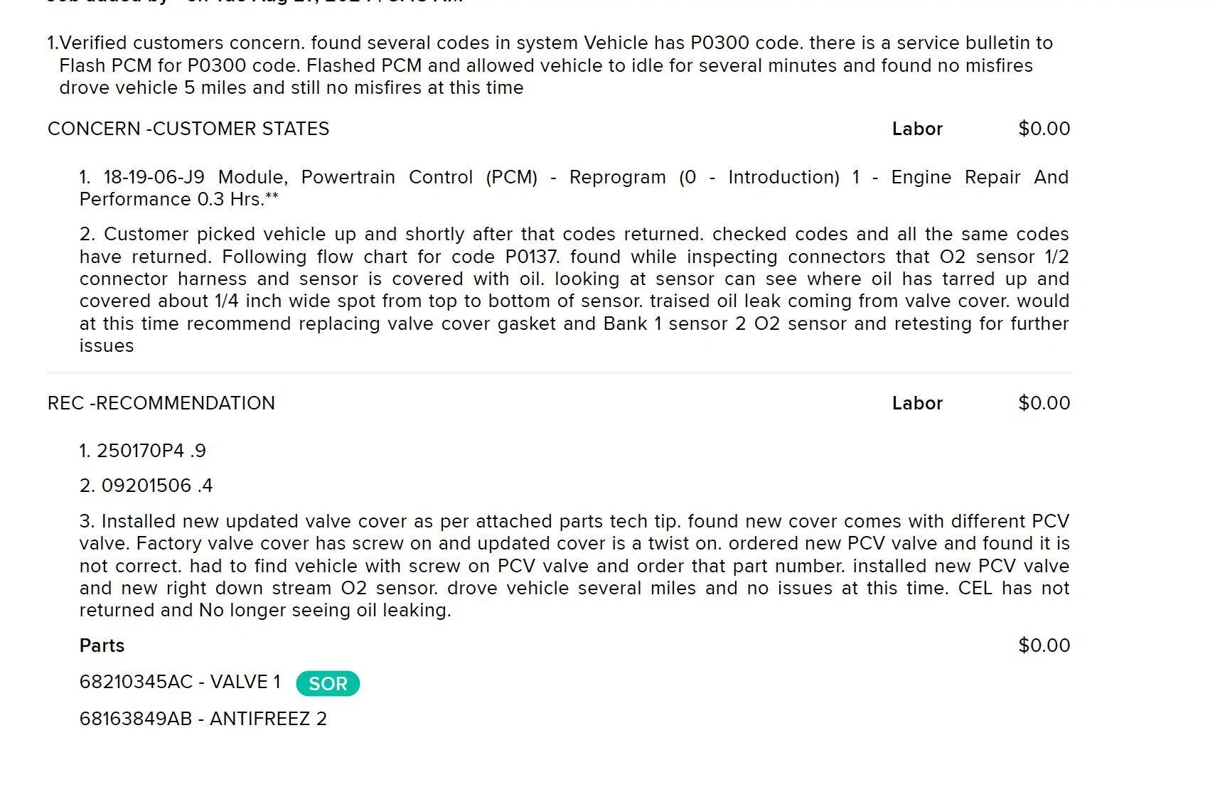

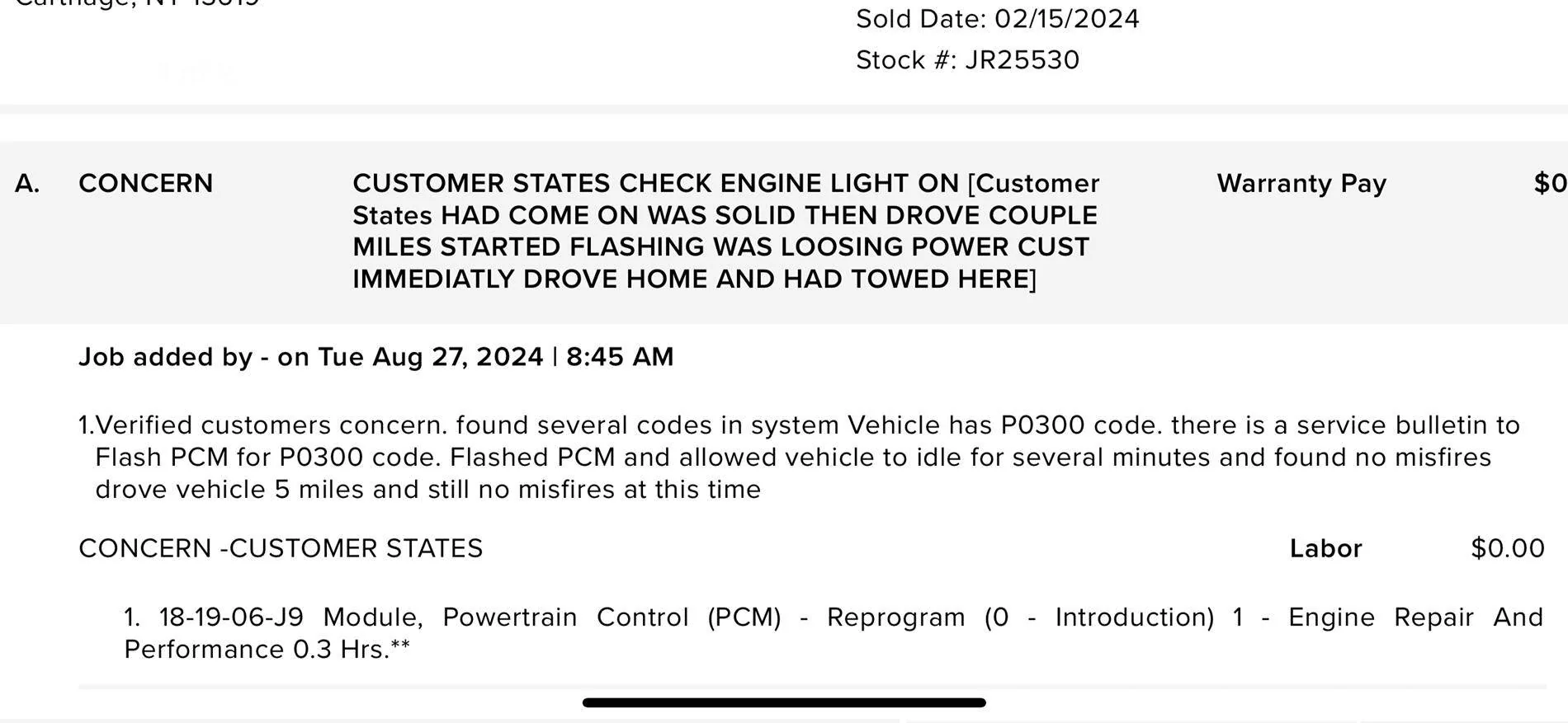

We picked it up on Saturday Aug 31.Went 10 miles and the engine light came on agin it was skipping and smelled hot. I have talked with Ass. manager and service technician. All I get is they are working on it.
Jeep Gladiator Jeep still at dealership after check engine light IMG_2112

How many trips have you made and spoken with the Ser Mgr? The GM if the Ser Mgr fails to provide findings and test results.. You should be more details than just post up a thread like this.
Jeep Gladiator Jeep still at dealership after check engine light Screenshot 2024-09-17 at 9.03.23 AM

Glad they got it fixed, thanks for posting the service details. Crazy that the new valve cover had a different PCV valve connection.

Glad you got it back so soon. Is this the 3.6 or the 3.0. Mine has been in the shop since June. That is pretty crazy that being a 2023 and already has a different PCV valve.

I hope this doesnt become a chronic problem. Its a 3.6.
