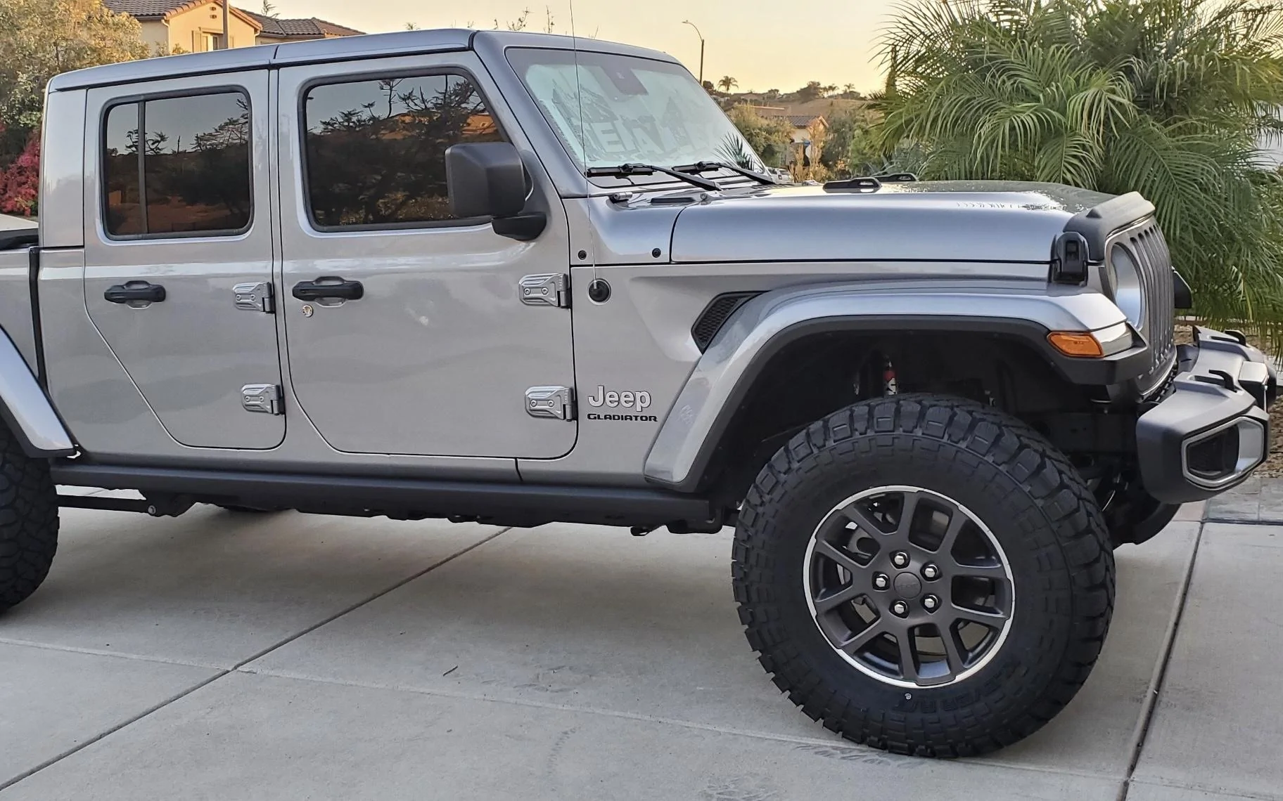

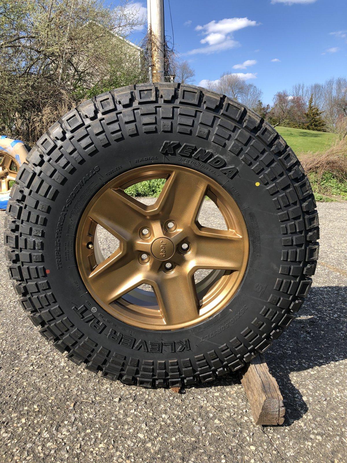

Tire is looking good with painted wheel.
Sorry if I missed it, but what paint and color did you use here? I was thinking of painting my Sport S wheels as well, and this looks great, but I’d like to have a darker/ more bronze-like color.

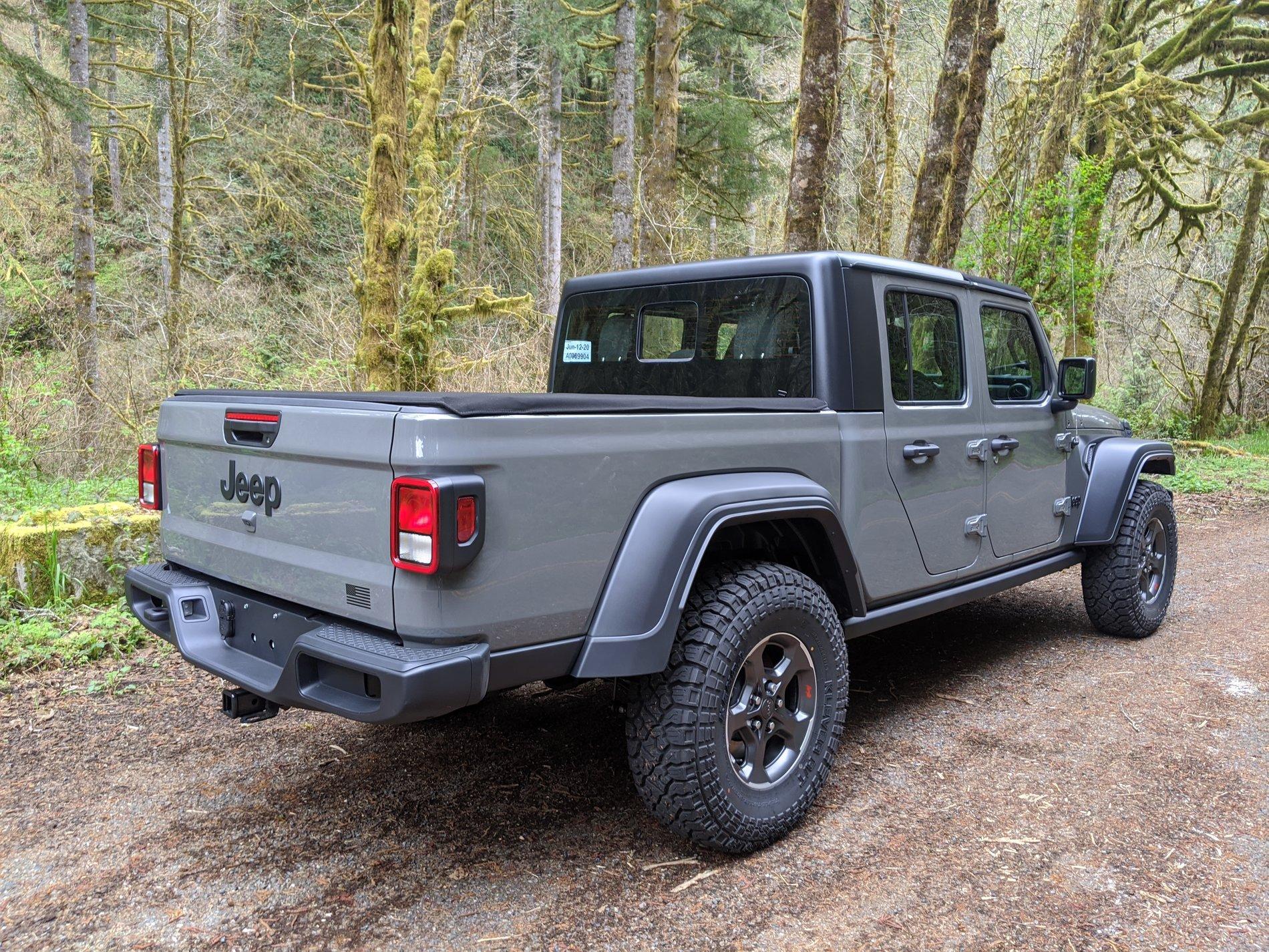

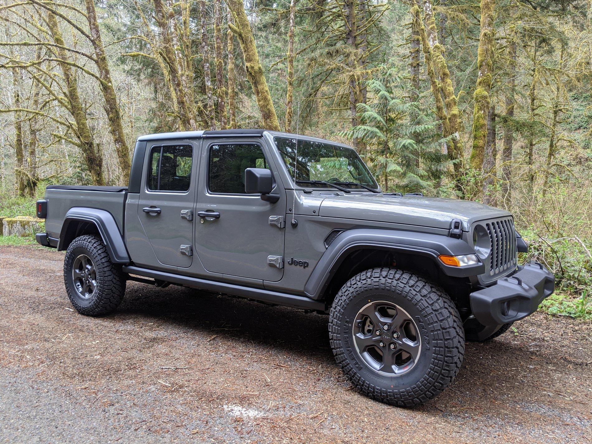

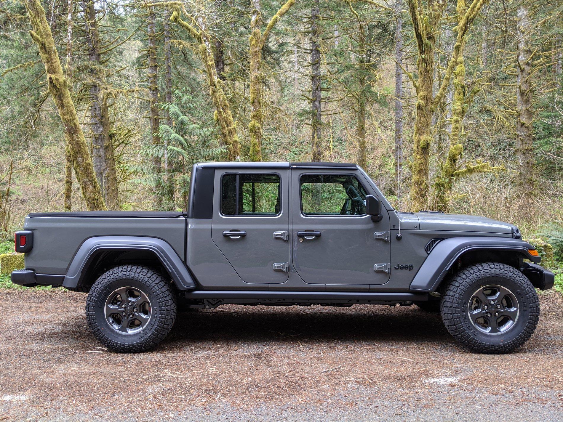

35" Kenda's on Rubicon takeoffs. 1.5" front leveling kit, .75" rear. Great tires so far. Spare mounted on stock steely. Also used Tazer lite to recalibrate for larger tires.
Jeep Gladiator Kenda Klever R/T KR601 35x10.50R17 IMG_20200420_081746
Did you have the tires on pre lift? Looks like the 1.5 lift may be necessary. Hoping I can do without lift or removing front wheel spoilers. Anyone else able to comment? I have sport s max tow.

Mine is a Max tow. I put lift on before I installing tires/wheels but 35's would fit fine as they are only 10.5 wide. I also removed and trimmed the fender fillers.
Love the ride height and ride. Wouldn't change a thing.
