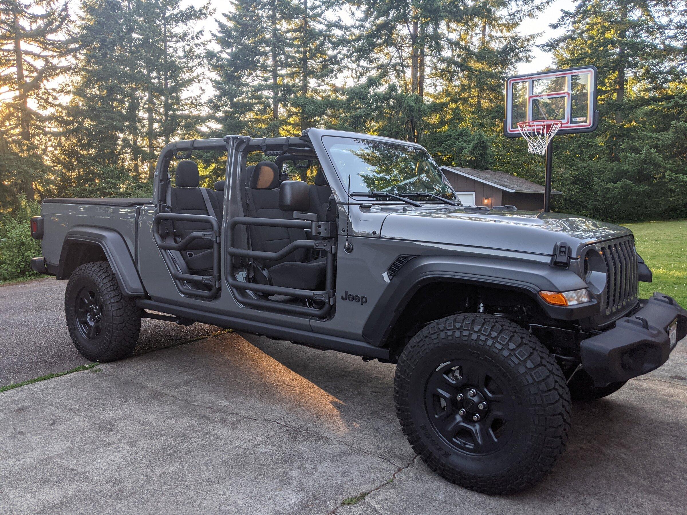

So I did the Sky Jacker 4.5" up front, then added a new driveline and went to 5.5" up front and just ordered Teraflex triple duty rear springs so I could still tow without the sag, removing the Skyjacker 3" rear lift and making it a solid 4.5" rear lift with those triple duty Teraflex springs. I did go to 5.13 gears (extremely happy with this selection) and I'm riding around on 37" Yokohoma's. My trailer is around 4250 loaded, 3750 dry, with about 600 lbs tongue weight. I carry a couple of Coleman Minibikes in the back on a few trips and I always have the Go-Fast Super-lite RTT with the bed rack on (just like the pic). I do not daily drive this, camping and off roading only. Stock springs were to spongy, same with the Skyjacker junk. I've had my JT since new, for 3 years now. I love it for what Jeeps are used for. I do BOH trails all the time, and I'm headed the Rubicon this year.
