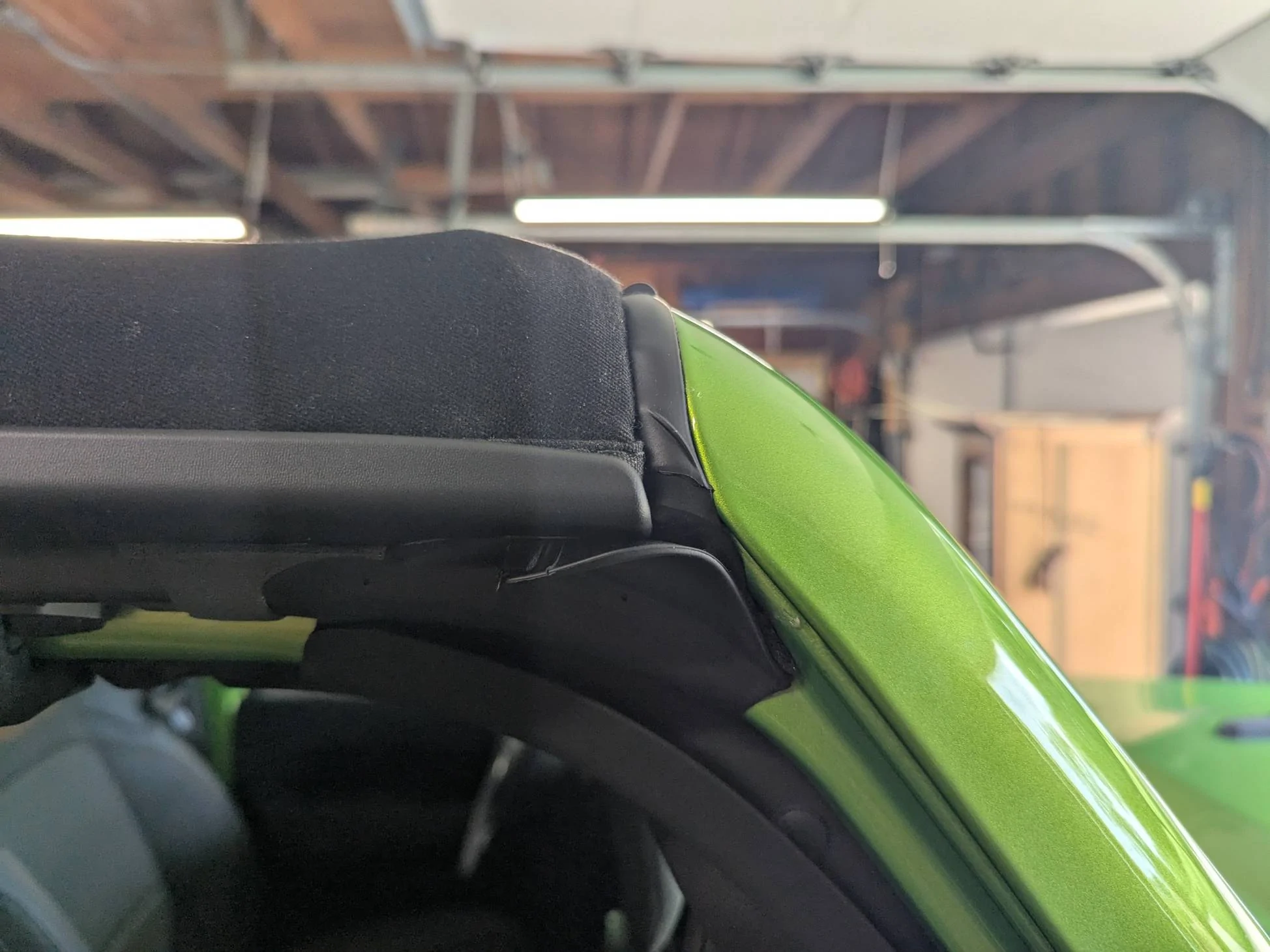

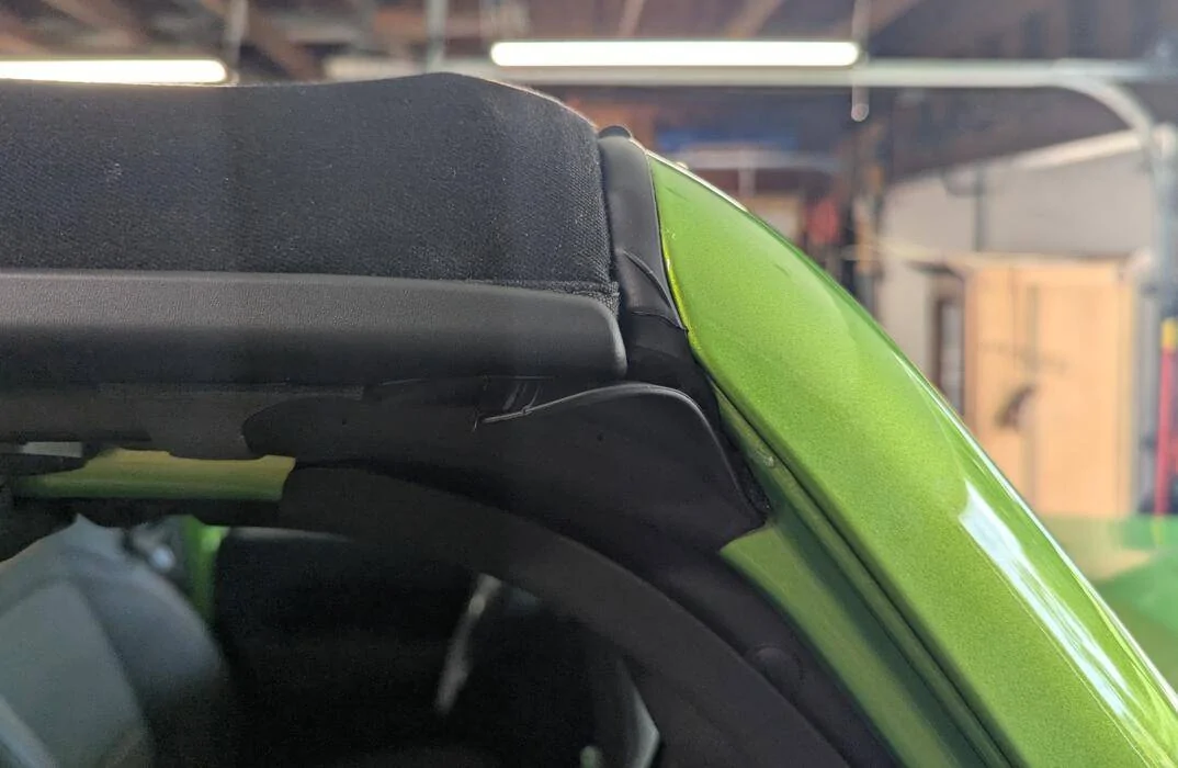

Jeep Gladiator Sunrider owners - MY mess-up, or theirs? PXL_20250530_211030924
Right door would likely rub if not for that bit of rubber there - I had to hold that in place while closing the door otherwise the sunrider forces that seal down so hard, the door catches it.
Jeep Gladiator Sunrider owners - MY mess-up, or theirs? PXL_20250530_211048972
Jeep Gladiator Sunrider owners - MY mess-up, or theirs? PXL_20250530_211127964
Sunrider shoves the factory seal down so far the door hits it and shoves it inward.
Jeep Gladiator Sunrider owners - MY mess-up, or theirs? PXL_20250530_211141311
Because the sunrider shoves the seal down the door catches it and pushes it in, instead of being where it should be, deforming and distorting the seal.
Jeep Gladiator Sunrider owners - MY mess-up, or theirs? PXL_20250530_211150563
See how it shoves that factory seal down?

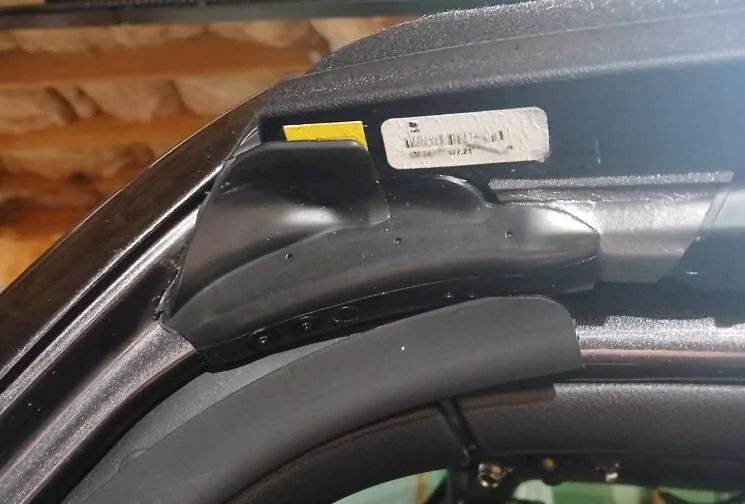

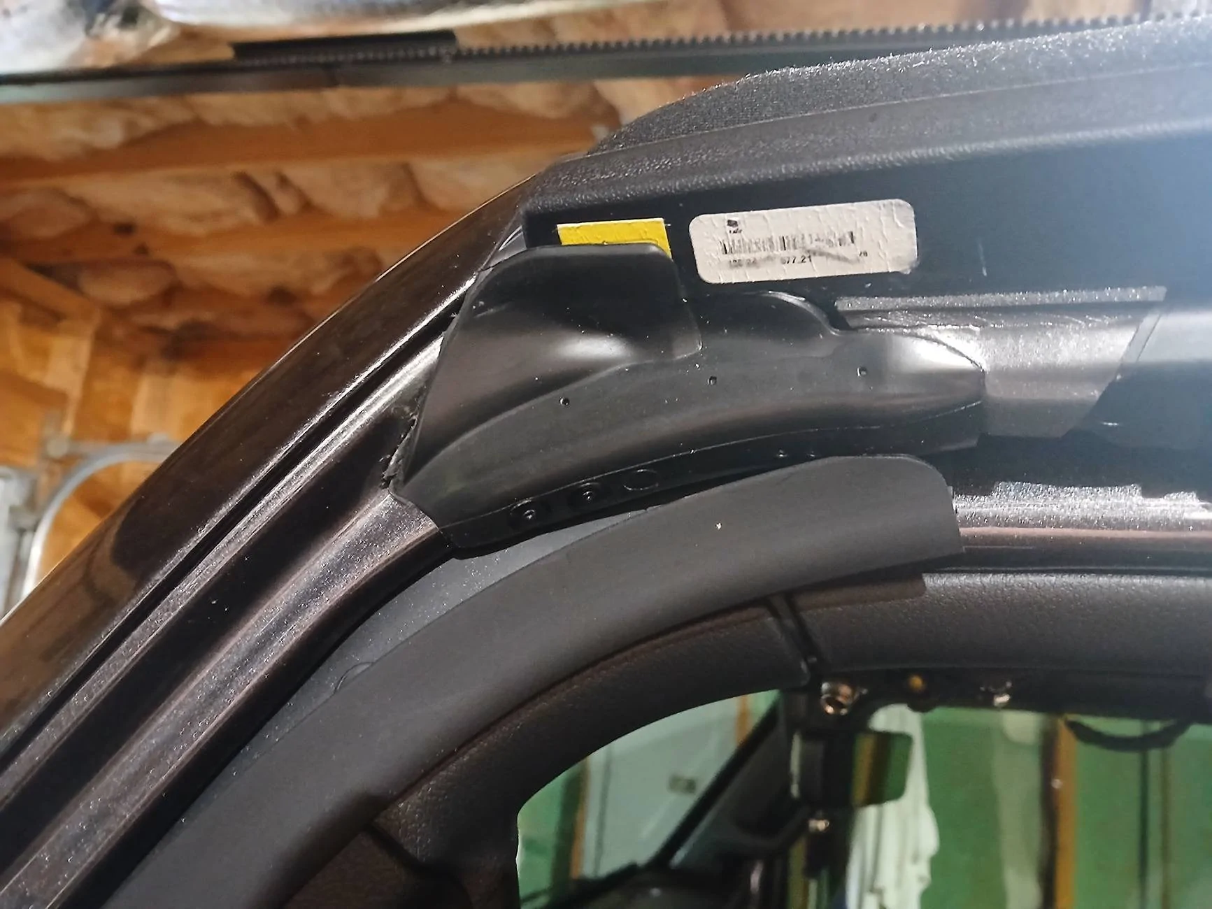

Your seals are different than mine. Yours must be updated/upgraded. This is what my 2020 looks like. The Sunrider pretty much sits flush. Is that seal that is sticking out part of the windshield frame header seal on yours?
Yeah, they made major changes to the seals in I believe the 2022 model year. Maybe even more with this 2025 - I've not really compared. But I know my 2020 was quite different from later ones.

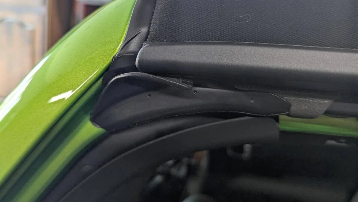

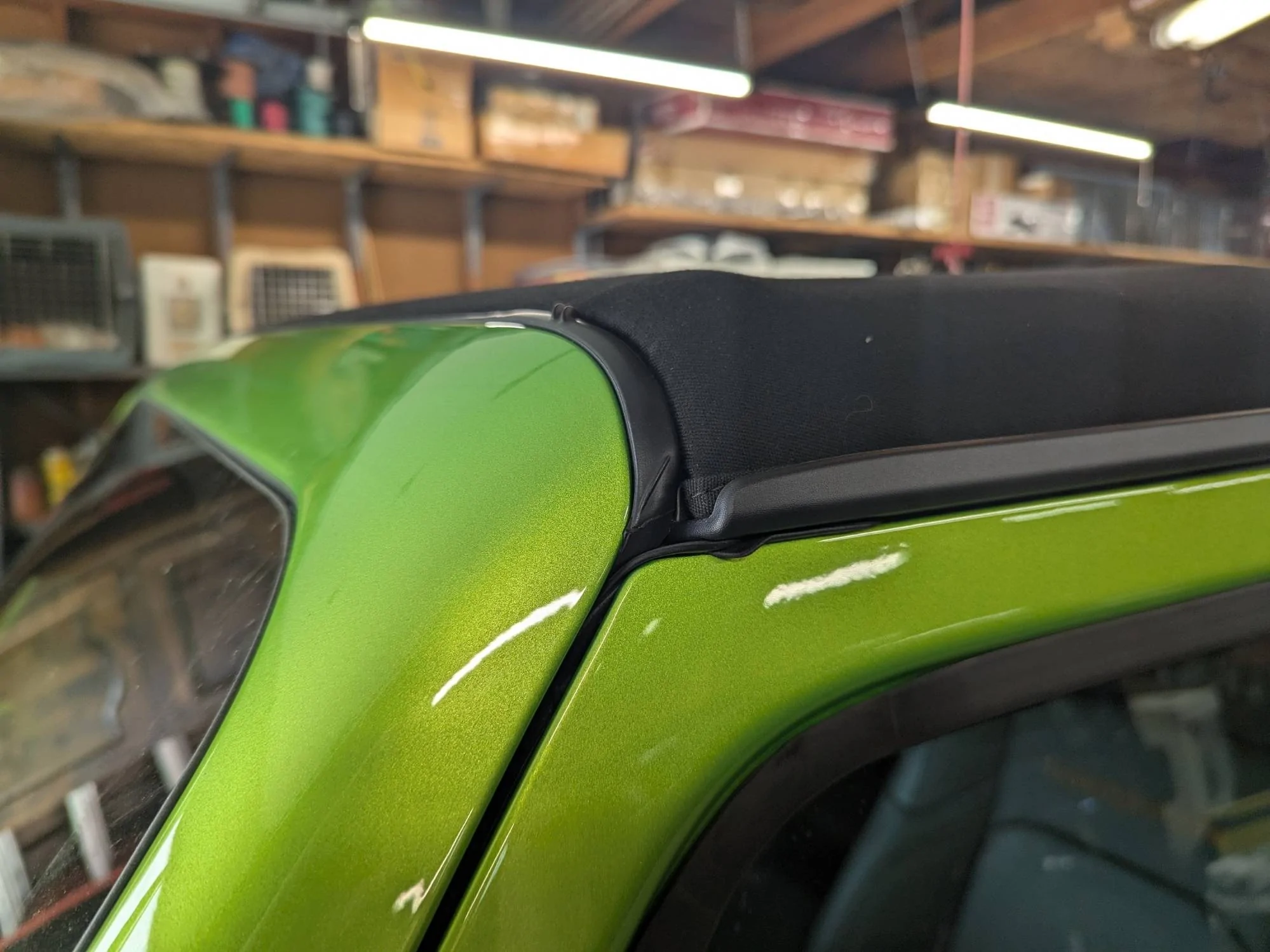

Here's what mine look like. I had to slightly manipulate the driver's side seal and then everything worked perfectly. I also just had to use medium hand pressure to get the rear clip installed.
It sounds like something is not quiet right with yours.
