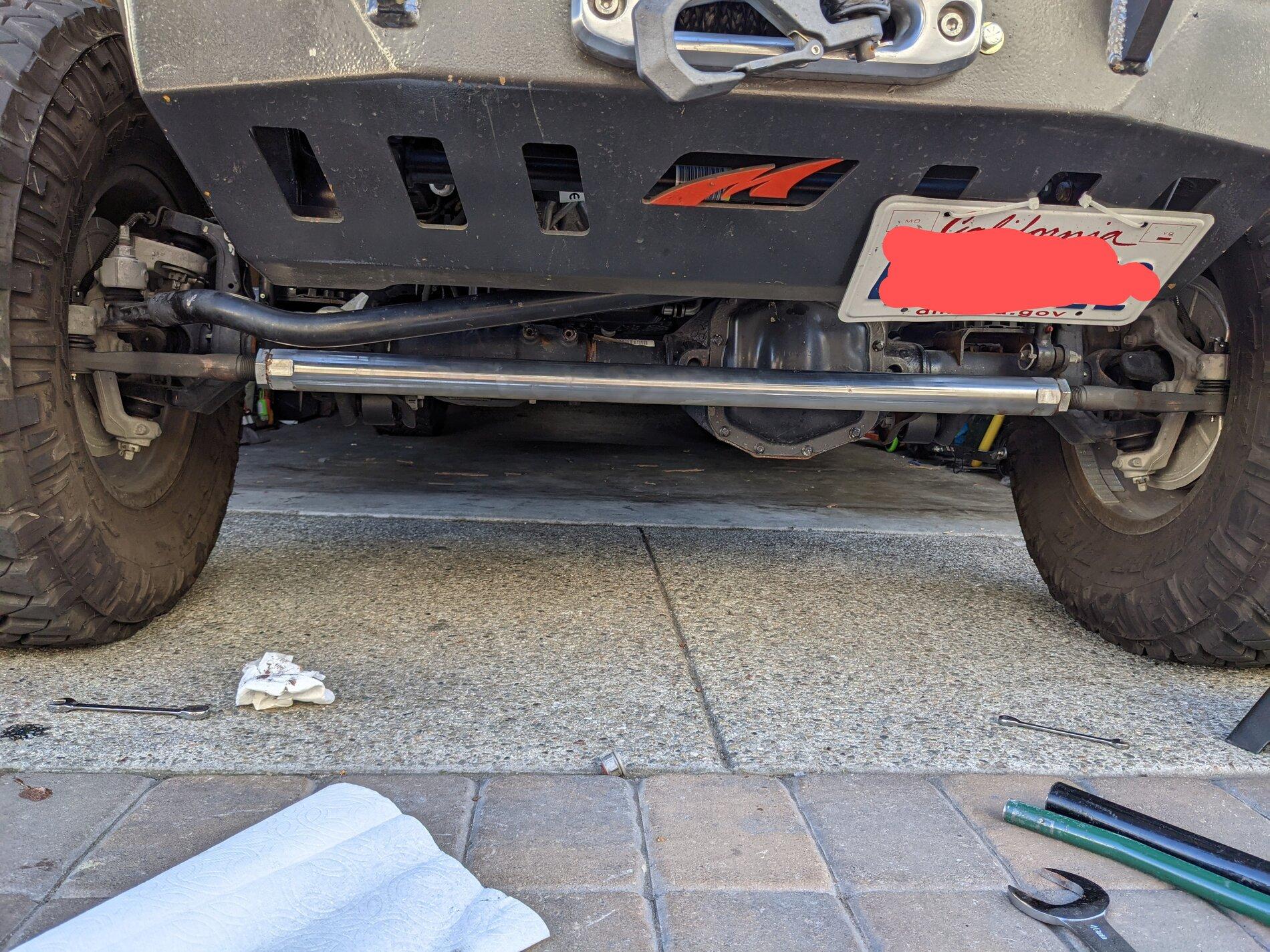

No photos, but I FINALLY got my suspension issues figured out so I'm very happy about that!
I had a friend install the Mopar lift right before going to Utah for a couple weeks. While on that trip, a couple suspension parts loosened up a little, which was to be expected. When I got back home, I took the Jeep to the dealership to have everything tightened back up.
Everything seemed great for a week or so, and then I noticed some pretty bad creaking noises coming primarily from the rear suspension. It seemed like it only popped up in cold weather and it was still pretty warm out, so it only happened once in a while...not enough to really concern me.
Once colder weather set in, the creaking got worse and was happening all the time. Then, some clunking noises started up and the whole suspension was really just sounding awful. I made an appointment at a local 4x4 shop to have them look at the suspension and see what the heck was going on. I suspected that the dealership had tightened up the suspension while the Jeep was up on a lift instead of on the ground like it should be.
Sure enough, the 4x4 shop told me that they suspect the suspension was tightened while the Jeep was up on a lift, causing everything to kind of bind up once it was set down on the ground. In addition to that, a large number of the bolts were over tightened by almost double the factory recommended foot-pounds. Lastly, the track bar was a little loose and kind of wonky so they got that straightened out too.
SO! The jeep drives great again, no creaking or clunking, and I'm hoping that this suspension crap is finally behind me! I've had a couple Jeeps over the years so I know all about the suspension noises and the noises in general, but this seemed like more than the normal "Jeep thing" - which it was, so I'm glad I didn't just ignore it and that now it's all good :jk:
