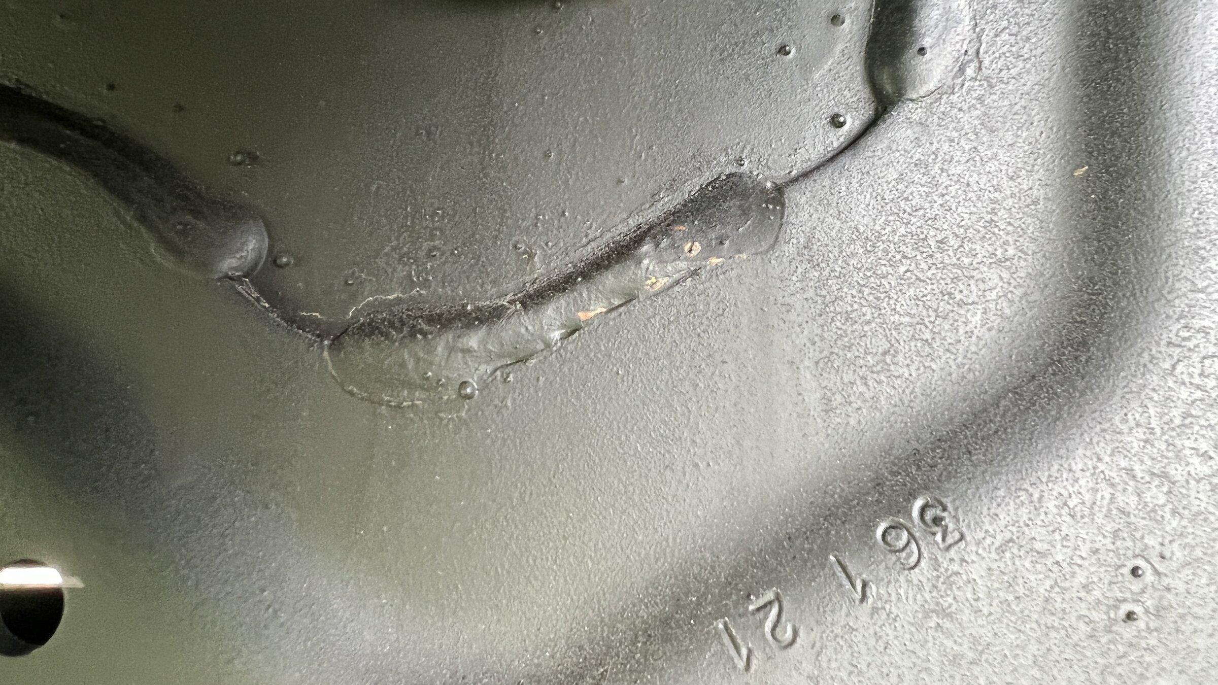

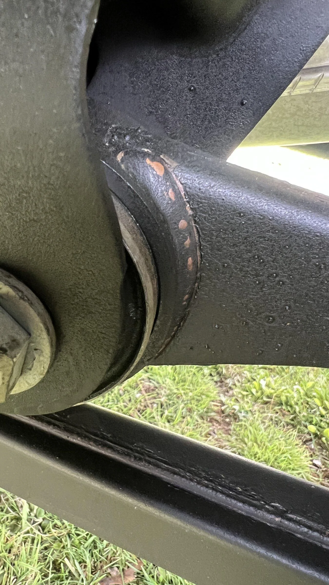

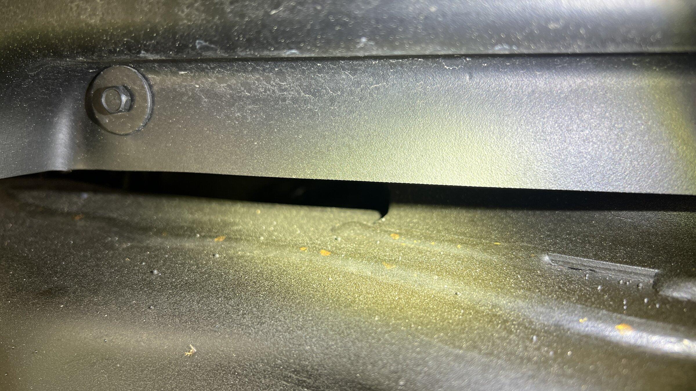

For reference - I do not have significant rust. To me however, even a spec of rust is considered rust no matter how small it is.
I can't actually tell if this is even rust, or if it's some sort of Fram adhesion treatment process. Nonetheless, you can see specs of paint is not there. Rock chips, maybe. Bad paint adhesion, more likely. Either way - I really hope its not a problem. Just curious to see what others who actually are in the rust belt deal with for such a new vehicle.

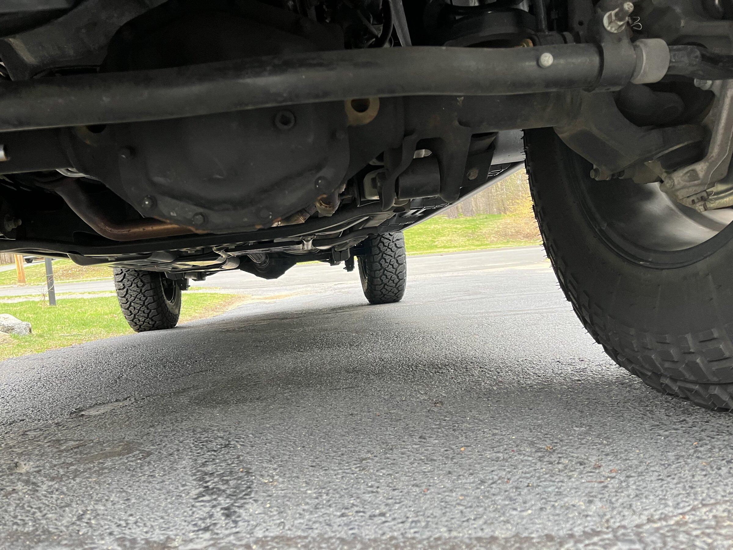

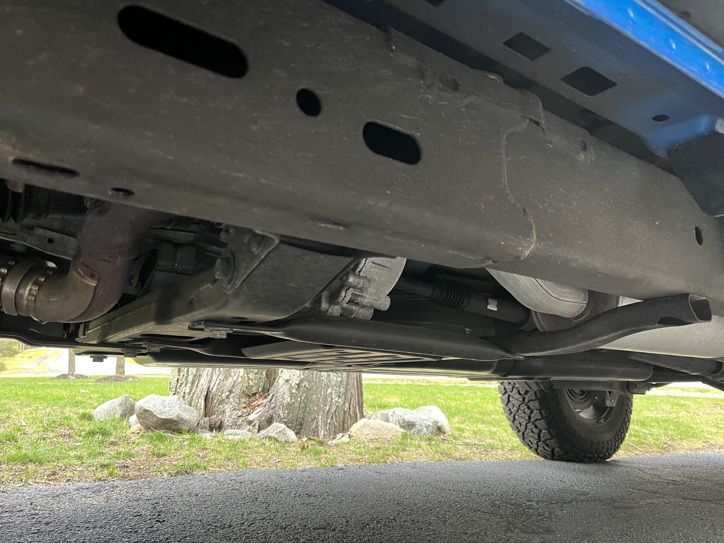

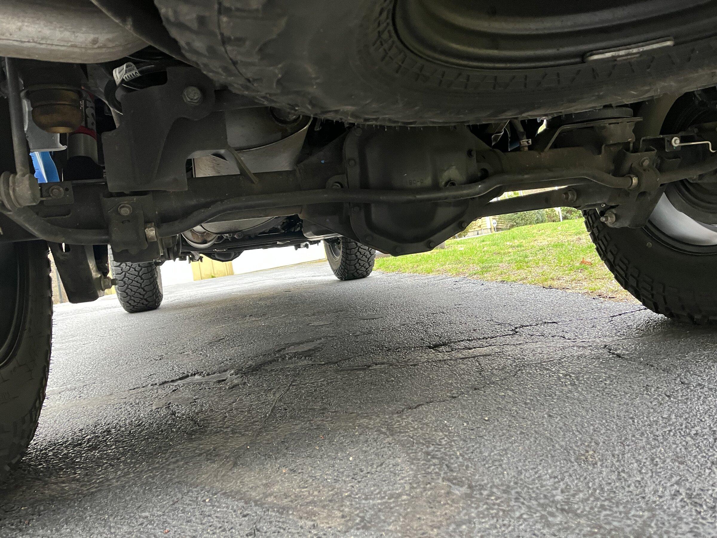

2 winters in MA, they used rock salt, liquid brine and magnesium chloride on the roads. Hardly any rust on the underside except for exhaust which you can’t really do anything about. I sprayed everything with Fluid Film when I purchased it before the first winter.

Unfortunately, the welds will typically have some paint flaking because the slag wasn't removed from the welds prior to the paint process. I would clean the welds thoroughly to remove any loose paint and then coat with RustOleum brush-on satin or semi-gloss black paint.

thank you I really do appreciate the photos. ? I did order some fluid film also for next year. Summer is almost here so not much more road spraying going on.... But still wanted to lay down a layer of that HD metal protector first because it doesn't wear off nearly as easy as fluid film.

I was thinking the exact same thing. Because the only spots of flaking paint is on the welds. I had figured it was maybe a rushed manufacturer process since so many people want these things super fast. I mean at least its not like the process of the 90's where bodies rusted out in a couple years... But I wanted to cross-reference with folks here to just make sure I'm not an odd duck with problems before things get too crazy. Its a big investment for me so gotta make sure it lasts a good long time.
