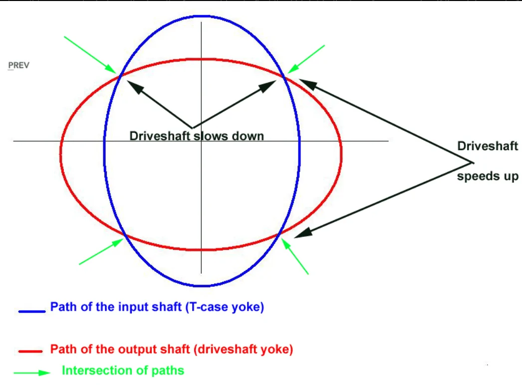

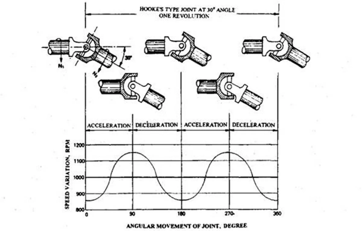

Here's a picture I stole rather than trying to draw it with my hands as they are -
Jeep Gladiator Bad Vibration after Front Driveshaft Install 1715117803585-l4
Jeep Gladiator Bad Vibration after Front Driveshaft Install Screenshot 2024-05-04 140224
Note that at a 30 degree angle (extreme, I know) the part being driven has to change this much - twice. Slow, speed, slow, speed, two times a revolution.
Jeep Gladiator Bad Vibration after Front Driveshaft Install ujoint-image0023
