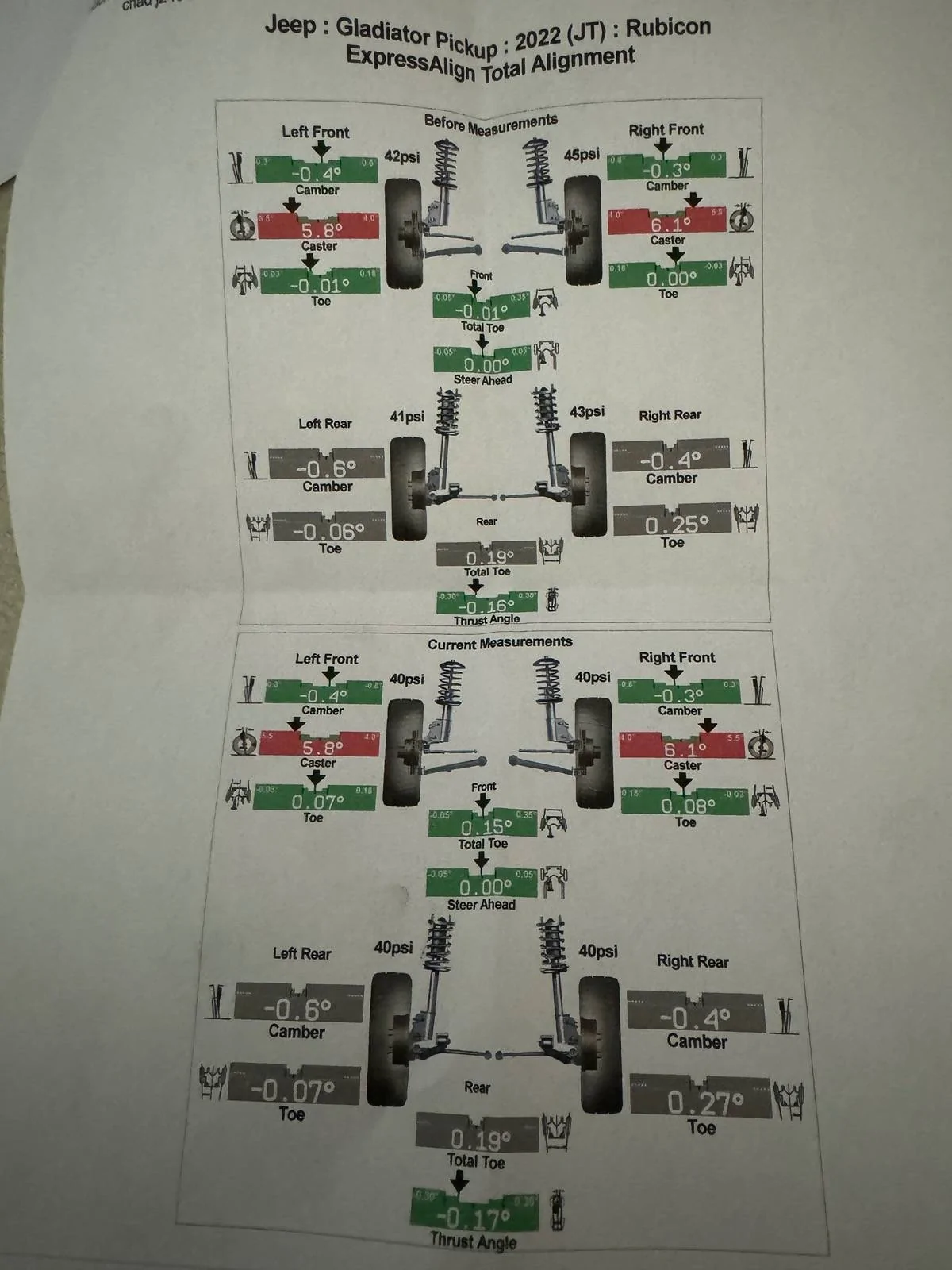

I just swapped from the SD springs to the HD's today. I also have steersmarts front and rear track bar and sector shaft brace (but did not install the bearing) as well as teraflex rear geo-correction brackets. I have not checked since getting home today but previously I had zero bind or contact anywhere. Here are my measurements before with the SD springs and now with the HD springs. I don't think they even changed anything.
It drives perfectly - one finger if I really wanted to but that's not smart. Zero bump steer, zero wonder (except for the terrible ruts here). This is what you want to shoot for.
I can check for any front drive shaft bind tomorrow since it did go up maybe half an inch at best.
