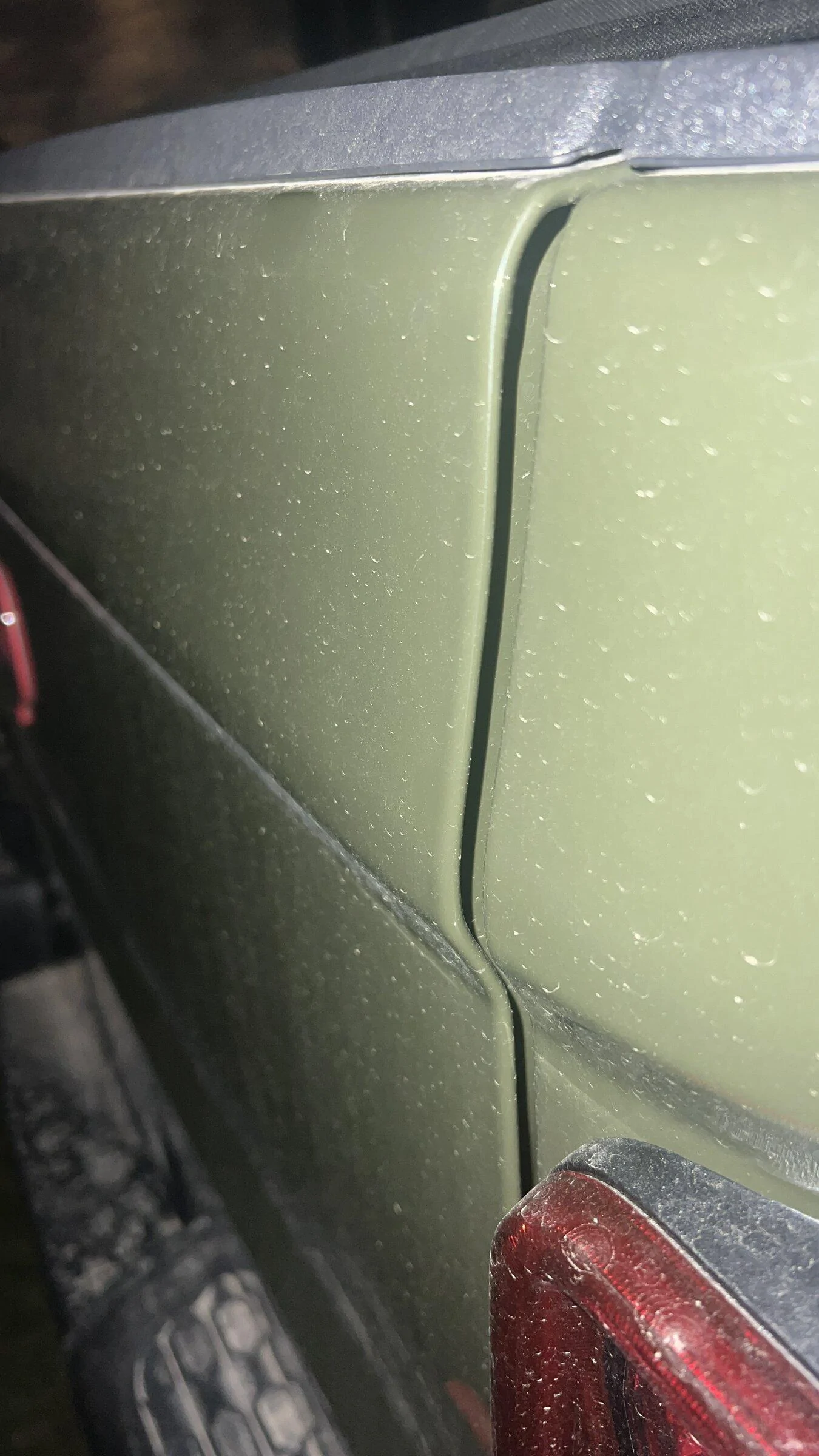

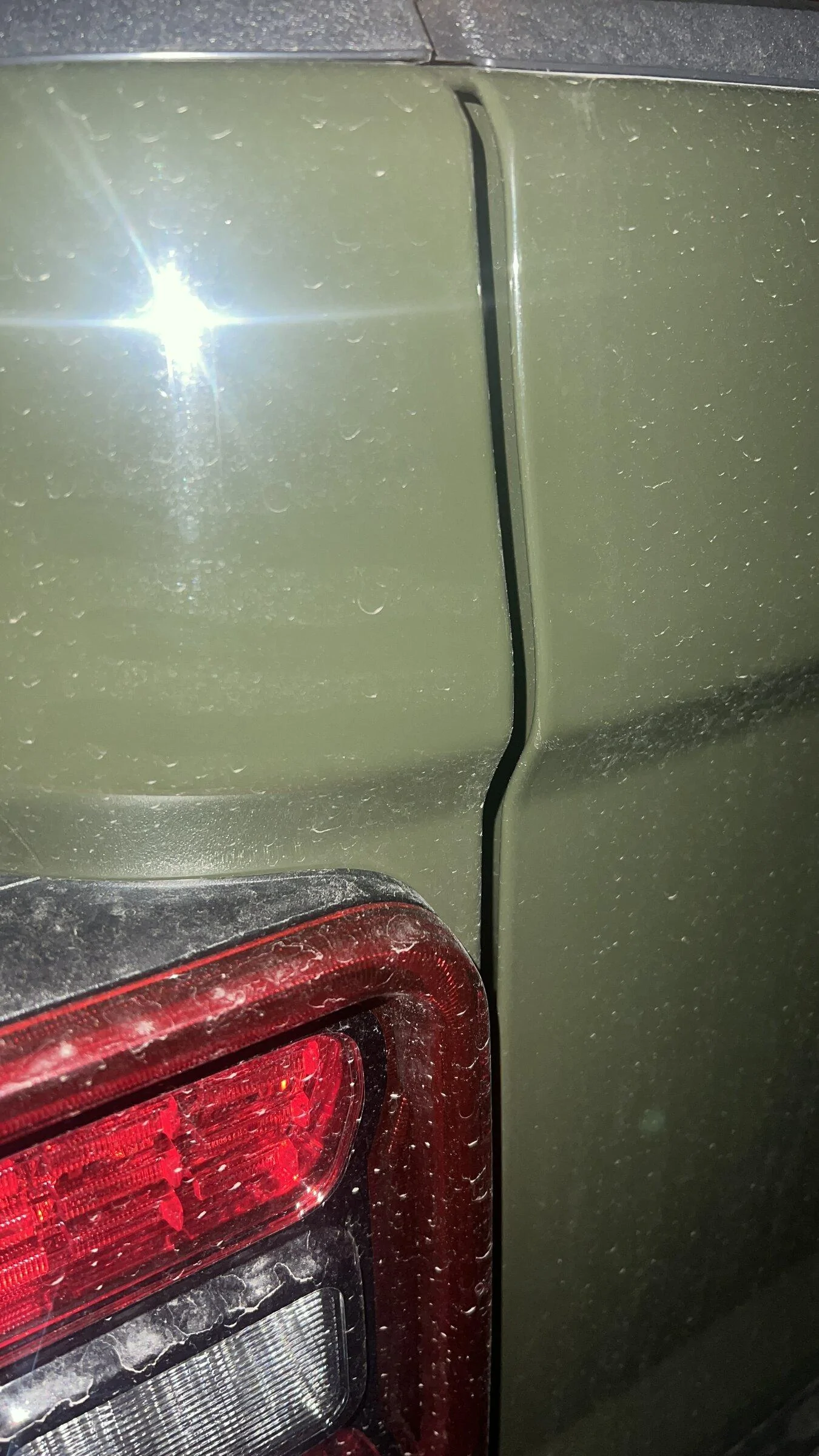

Could someone do me a favor and take a picture of their tailgate gap, maybe at the top, but from the side like maybe a 75 degree angle?
I noticed this morning that though my tailgate is closed, the gate itself sticks out past the metal of the body by maybe oh 1/4 inch? So you know how if you shut a door, but it doesn't close all the way? The tailgate kinda looks like that but it is closed all the way.
Just wanting to cross-reference if this is normal or if something was not aligned correctly from the factory.

do you have a pic of it closed tho? does the tailgate end up flush with the body pannels or does it stick out a little kinda resembling if its not fully closed?
yeah I saw a thread elsewhere on the seals. I just was feeling lazy. I know...its not a good excuse. but the tailgate closure thing I haven't seen a thread on

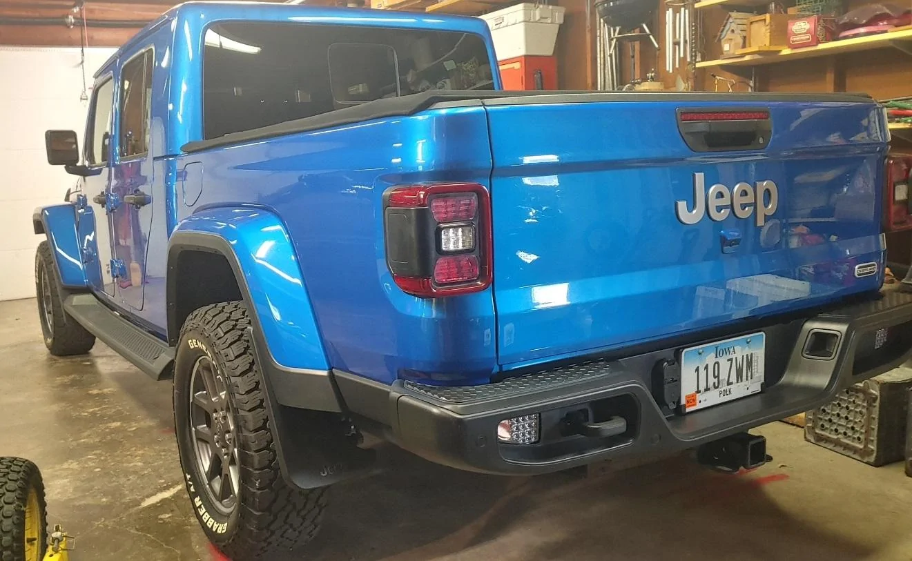

If you don't get anything/response - go to the search function, put in the words tailgate seal and hit enter. You may have to go through multiple pages of results but several here have done various things. I'm also looking for a solution as that's the only way anything gets into the back of my truck - the tailgate........
Jeep Gladiator Rear tailgate closure IMG_8086
Bill most people just carry a bottle of water not powder form water. :LOL:
On the lights and camera last week someone pulled beside me and signaled me, he told me I had left taillight out. Sure enough I pulled over slapped light it came back on.

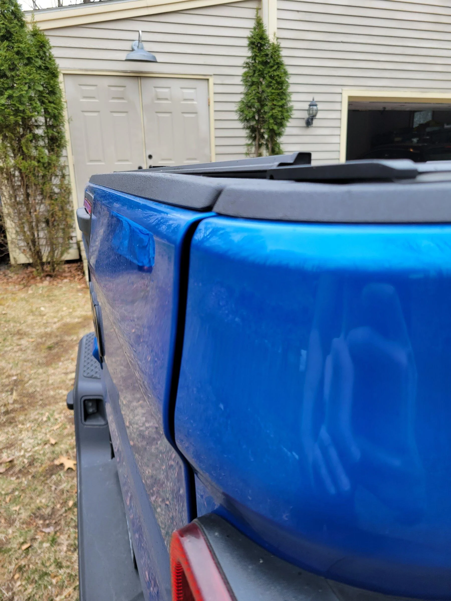

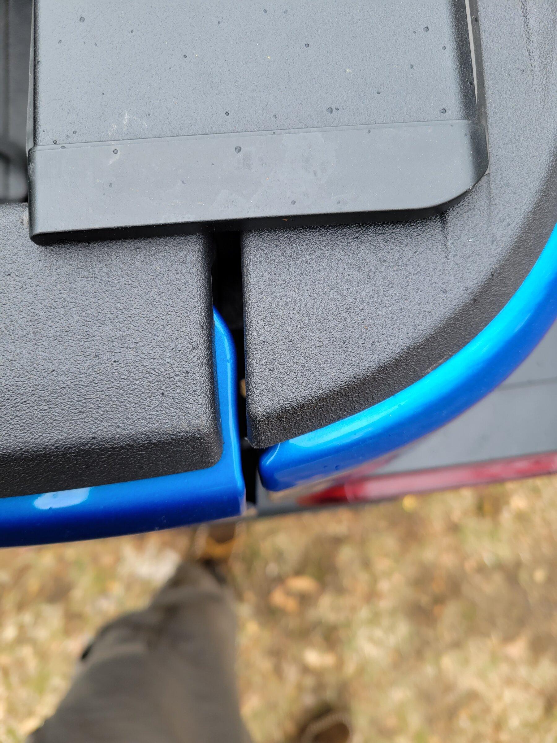

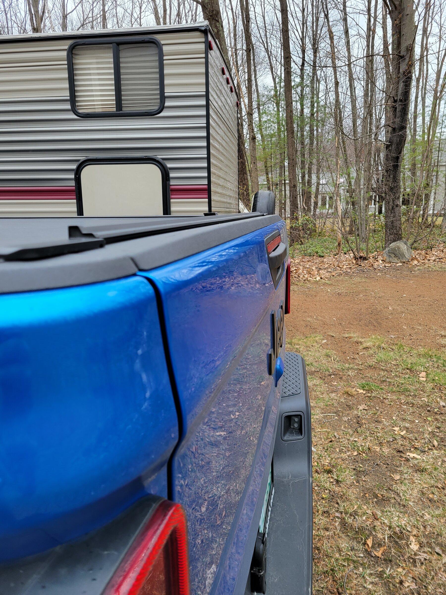

My gap is closer to yours than flush. I'll grab a picture today

Pics
Jeep Gladiator Rear tailgate closure 20220406_143657
Jeep Gladiator Rear tailgate closure 20220406_143633
Jeep Gladiator Rear tailgate closure 20220406_143616
