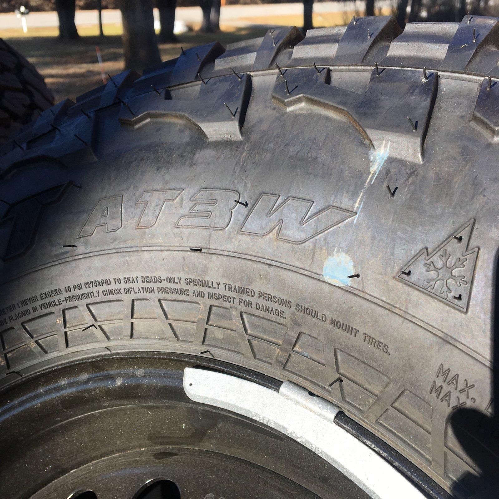

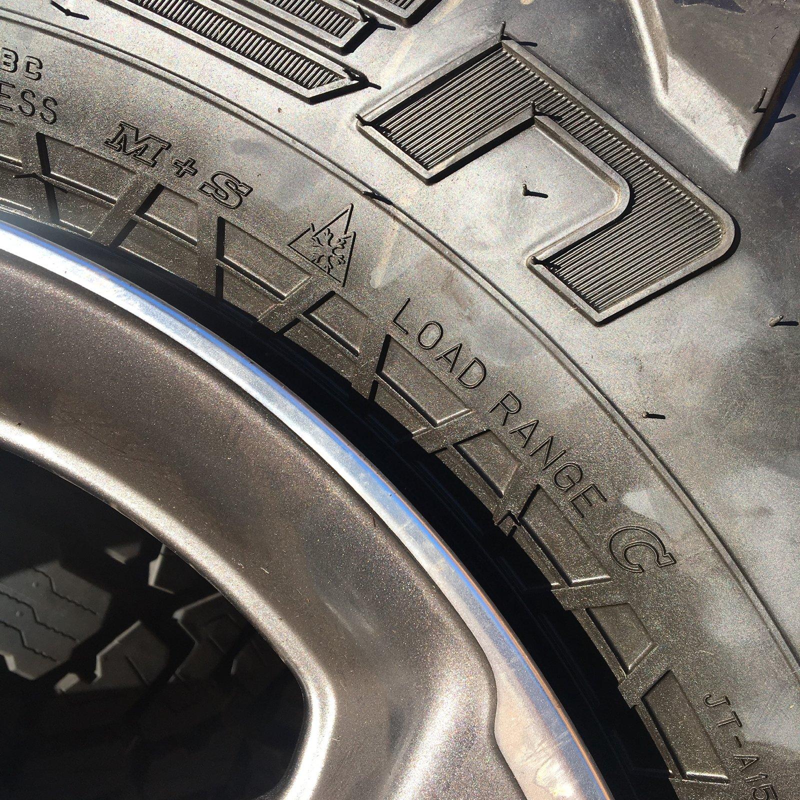

So are those Toyos, but it's the lesser M+S rating, not the 3 peaks and snowflake which is "severe snow" rating - deeper snow than the other rating. (I see some locations are starting to require the better rating in winter/snow)

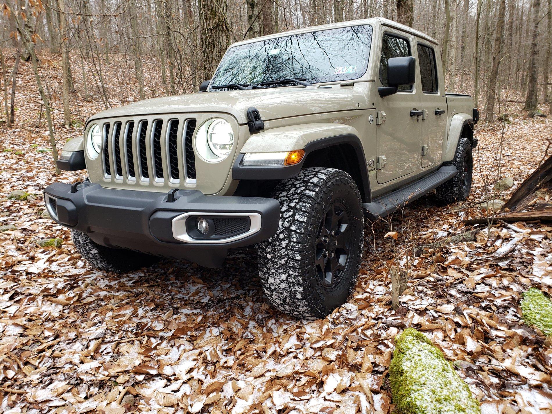

I THINK this is accurate - wondering what people thought of the Toyo tires I pictured above - they are apparently a lot bigger than the stock Rubicon tires. The Toyo tires get good reviews in most places I've looked. But it's a big size difference.

The at3ws are ok in the snow but they stink on ice and slush. Just get a set of dedicated snow tires and be done with it.
That's not what I hear about them.
Several have said they do well with ice and snow pack and such. The reviews are ok for ice. Not like a dedicated ice tire but I don't want dedicated winter/snow tires - I guess some miss the point.

I had the At3Ws on my ram and they are not great in packed snow or ice. About the same as our stock duelers. The most expensive all season/ all terrain will be worse then the cheapest dedicated winter tire. It comes down to the compound. An all season tire can never be as soft as a true winter tire or it would not last in the summer. Get a set of 17" rims and some dedicated snow tires. You can get a nice set of JL or JT rims for $150 to $200. Then it's easy to switch wheels in the spring and fall.
