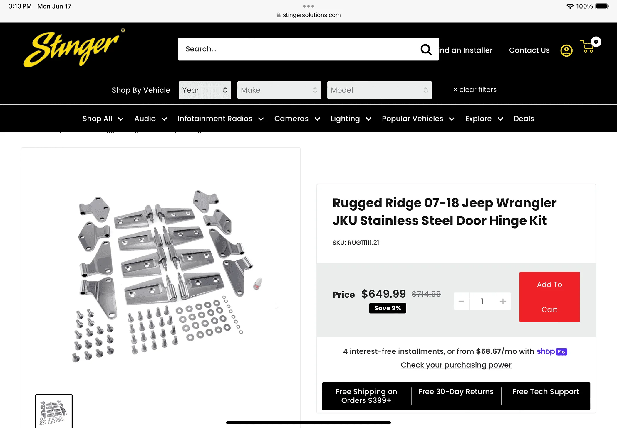

This should fix Any issues or concerns you have. Don’t forget you should have access to a factory paint warranty if issues arise.
Jeep Gladiator Brand new 2023 gladiator, how can I prevent hinge corrosion? IMG_0101
JKU hinges are different than our JL/JT hinges.
