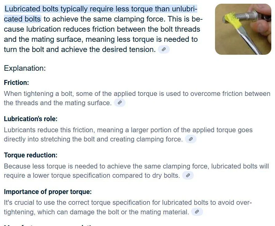

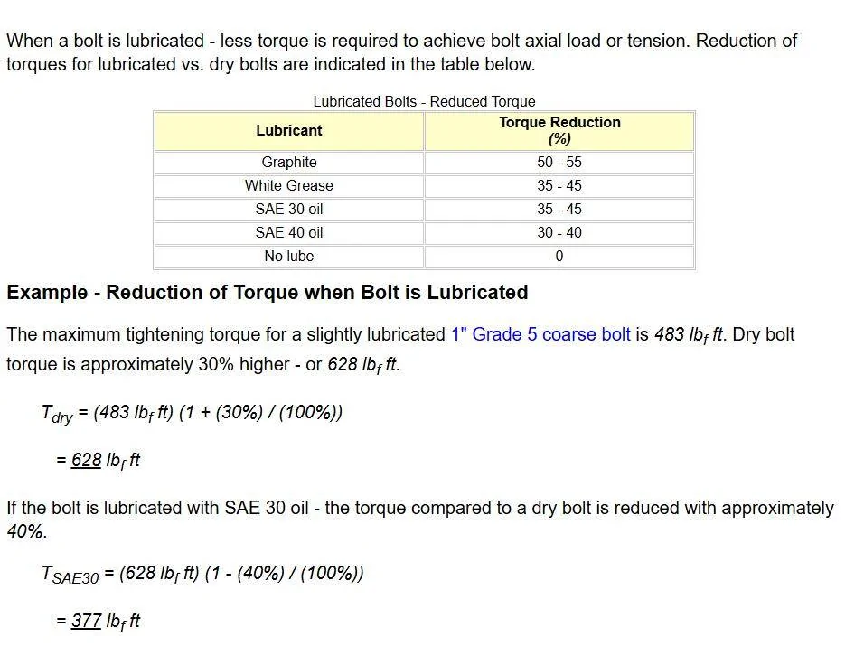

I use high pressure chassis grease on the wheel lug tapers and threads, and torque the lug nuts to 80-90 ft lb. Any lube reduces friction on the threads and/or taper, so torque should be reduced. Wear on the factory thread coatings will increase friction, as will rust and corrosion. If you do a search for torque specs, include the ARP fasteners site. They market a super slippery lube for their bolts and you will see that less torque is used with it compared to regular grease, oil, or dry. Never-seez and similar anti-seize lubes are mostly for high heat situations, but can be used elsewhere, of course. They aren't the best choice for low heat situations like lug nuts. Anti-seize is good for exhaust manifold bolts, etc.

Super critical situations like racing engine rod bolts it's measured in bolt stretch, not torque, due to the things you describe.
There are different specs for the finish on the metal, too - is it zinc, phosphate, etc? Some platings change the friction.
I just clean things up well - make sure I remove any grit, dirt, rust, etc.
I have some charts somewhere that address that - comparing bare to plated and so on, as well as comparing lubed to dry torque specs.
Your 90 sounds about right for a clean and lightly lubed situation, depending on the vehicle, lug size and so on. Sounds about right for my cars.
