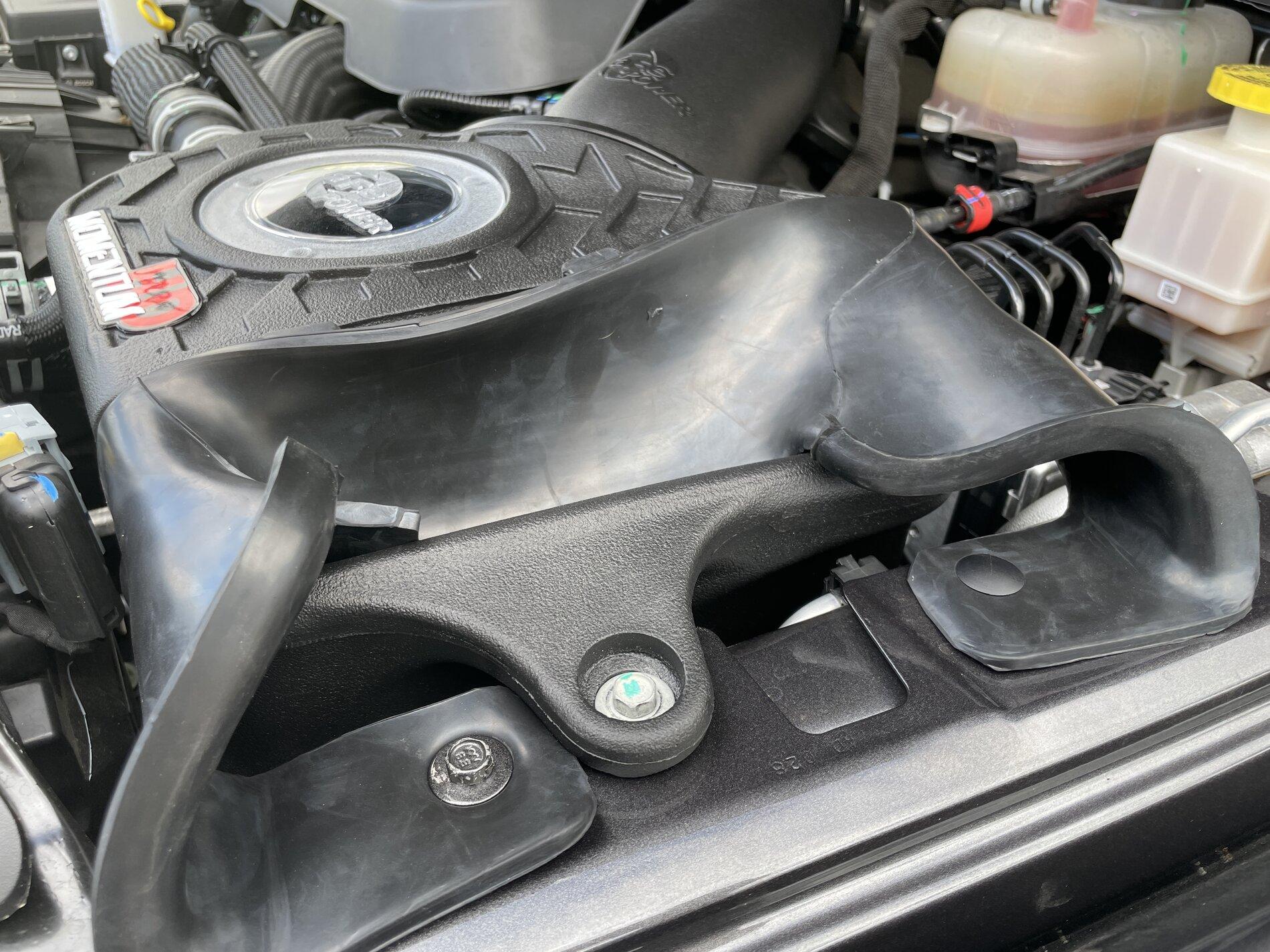

I just yanked the rubber. I’ll say with the engine heat the rubber is VERY soft. I think that part needed to be plastic but still waiting to hear back from AFE directly. I’ve never had an issue like this with their products. It is a bit disappointing to say the least. I think it’ll be fine without that on there but still for the money and the waiting to ship these it’s sub par.

well I solved the rubber mystery. I have to call AFE. Under WOT there’s so my flow it’s sucks the flap down. Not cool.
yea that looks no good at all. On the plus side, if they can solve that issue it looks like it wouldn't be difficult to make a working snorkel with that setup. It may slightly block some visibility and would require a little hood cutting but definitely doable.
Honestly, removing it worked just fine and I don't even see a real need for it I have had other systems with a more exposed opening. I am still waiting for them to reply to my inquiry my guess is they will say remove it or trim it back.
I'm sure it will work fine without the seal but I would actually prefer them to make it work because again it would seal up well with a snorkel that way. I wonder if a small cage would give it enough rigidity not to suck in like that.

From Josh at AFE
“Yes We are aware of this happening, for now you can run without the rubber part, we're having some stiffer ones made, but we're a couple of weeks out before we have them to send.
The technical team will follow up.”
Seems like they are on it and with their track record I’m confident in them.

No need to send ti back the rubber seal is a completely separate part you mount on the box so they won't re-design the box itself and you can just remove the seal as a work around until they ship a different rubber section. It's not like it renders the setup completely unusable, but I agree a separate thread my be in order just for the issue/workaround/repair. AFE is a long standing reputable company I've used their stuff for almost a decade so I would not say they are in the same relm as ebay knock offs.
