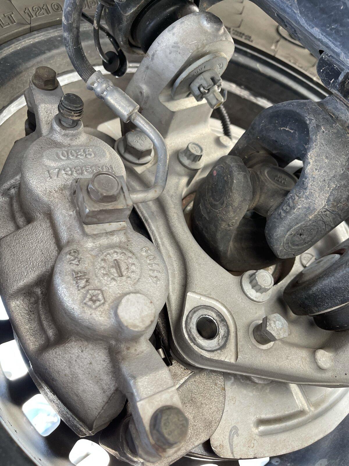

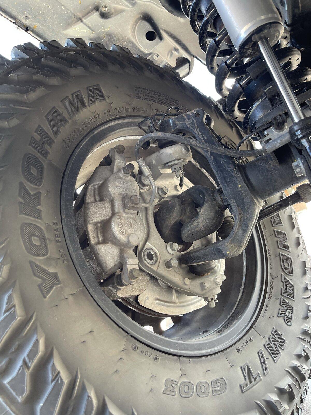

Broke or lost a caliper bolt in the middle of nowhere desert while off-roading. I had to limp it all the way home. Luckily I was over the bad part of the trail and the remainder was just flat sand leading directly to the highway where I hardly had to use the brakes till I was basically right in front of the house.
I’ve been all over town in my daughter’s car looking for the bolt so I could put it in and get the truck to the dealership in the morning to have it checked out, but no one has it. Nearest place that has one is El Paso. Good news is that they can have one for me tomorrow by eight.
What do you guys think? If there’s anything more serious done would it be covered under warranty or no?
Gouged up the inside of my rim pretty good but I’m not concerned with that.

Huh. You don’t see that very often. Would think most dealerships would have 1 or 2 lying around.
What made you look?
What made you look?
Its a catastrophic failure. That bolt keeps the caliper attached to the caliper knuckle or whatever it’s called. Whenever you hit the brakes it will come apart and drop. At first I thought it was just my four wheel drive not disengaging but the system was telling me it was and the sway bar had reconnected. It happened right after I had set everything back to normal. Once I realized it was only happening when I hit the brakes I looked at the caliper and saw it immediately.
I suspect that bolt has been broken for a while and just gave up the ghost today after the rough terrain.
Gotcha. Figured it had to be over a given period of time.
Glad you looked when you did. Good luck!
